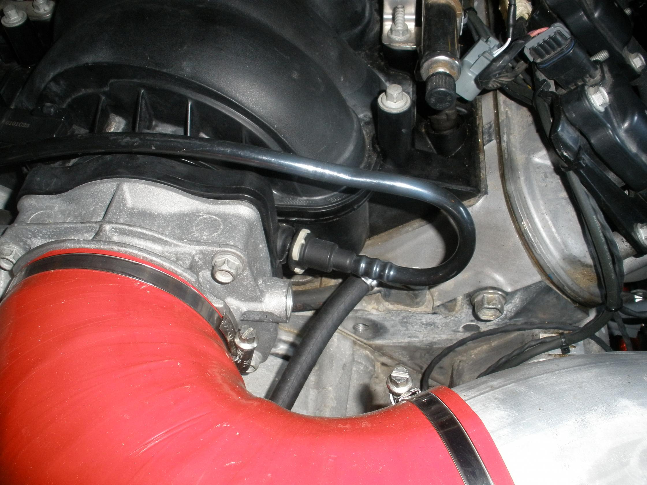

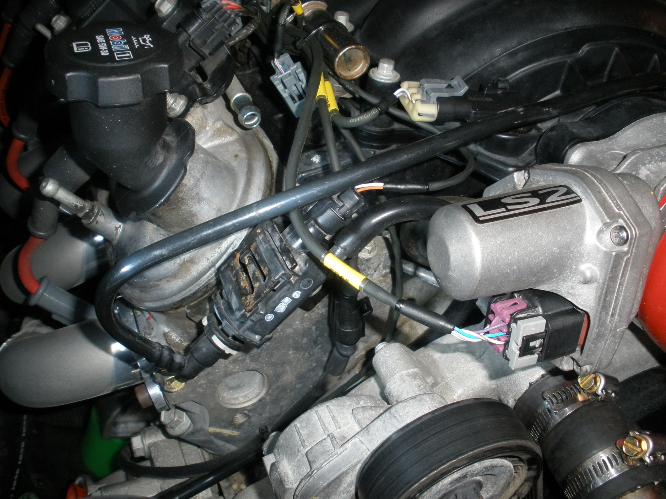

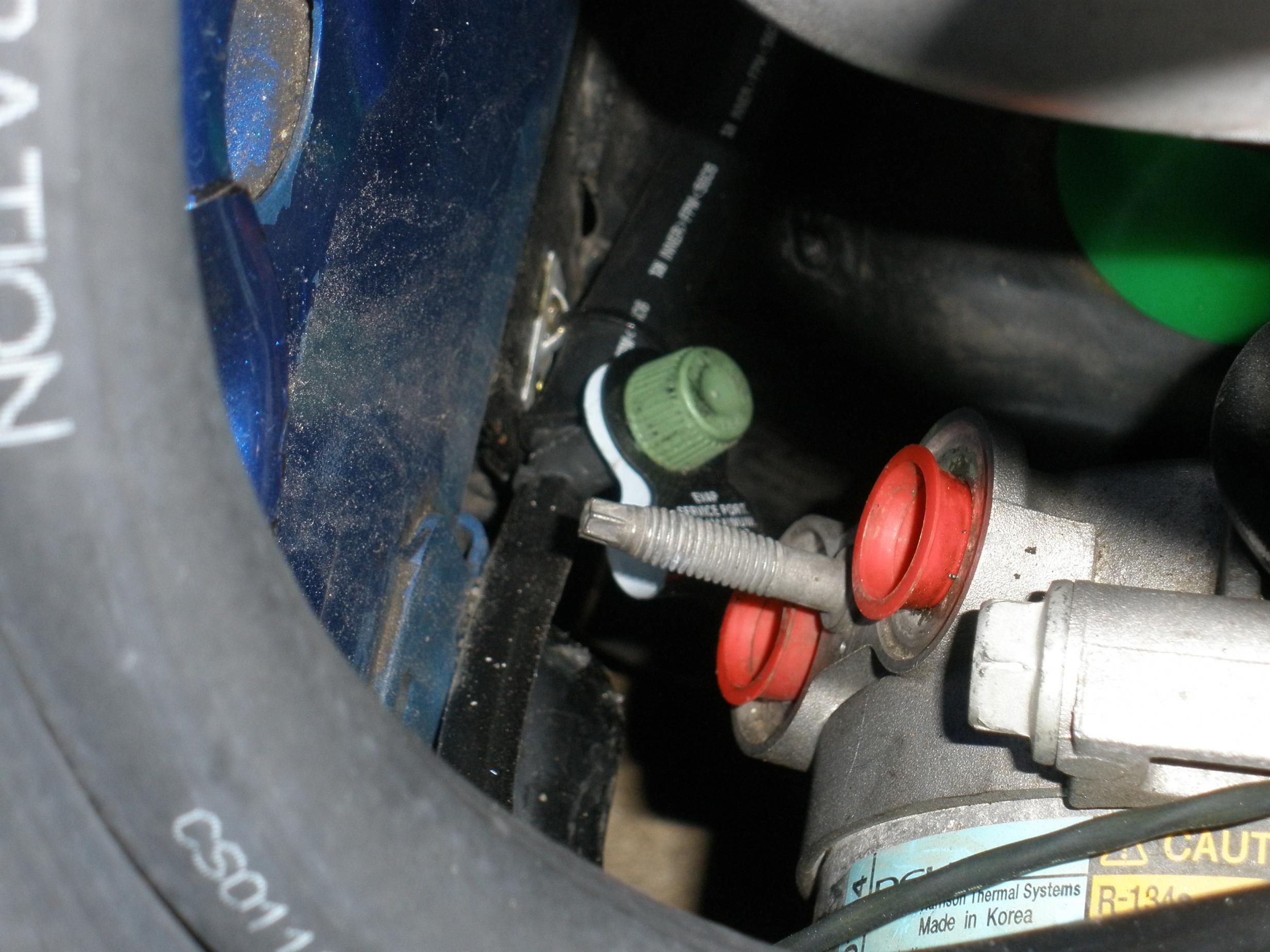

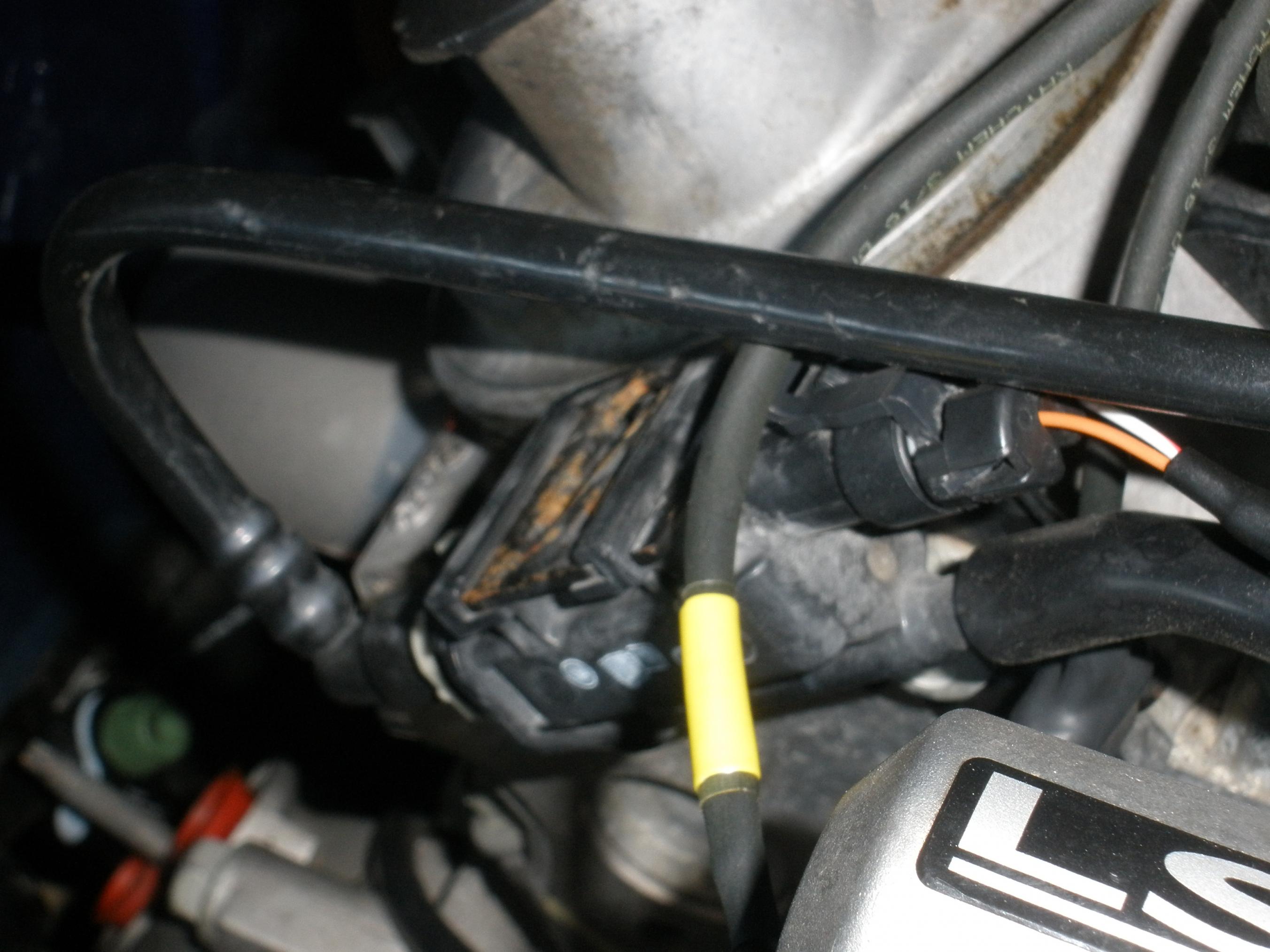

Evap Connections:
Drivers side stock connection:
Pass side front view (LS sensor is mounted upside down):

Connection to the stock Nissan unit... cause that's how Franz rolls
Took the wife for a ride and she didn't say it smelled like fuel, it did scare the shizz out of her and she said its too loud... MISSION ACCOMPLISHED
