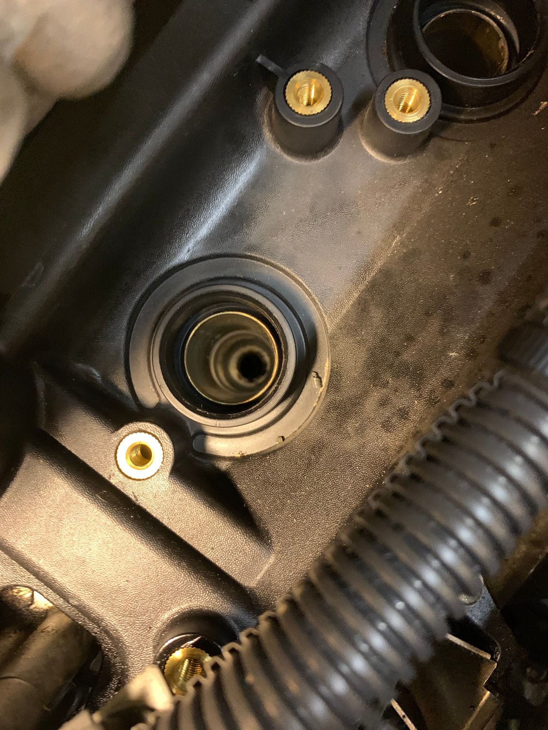

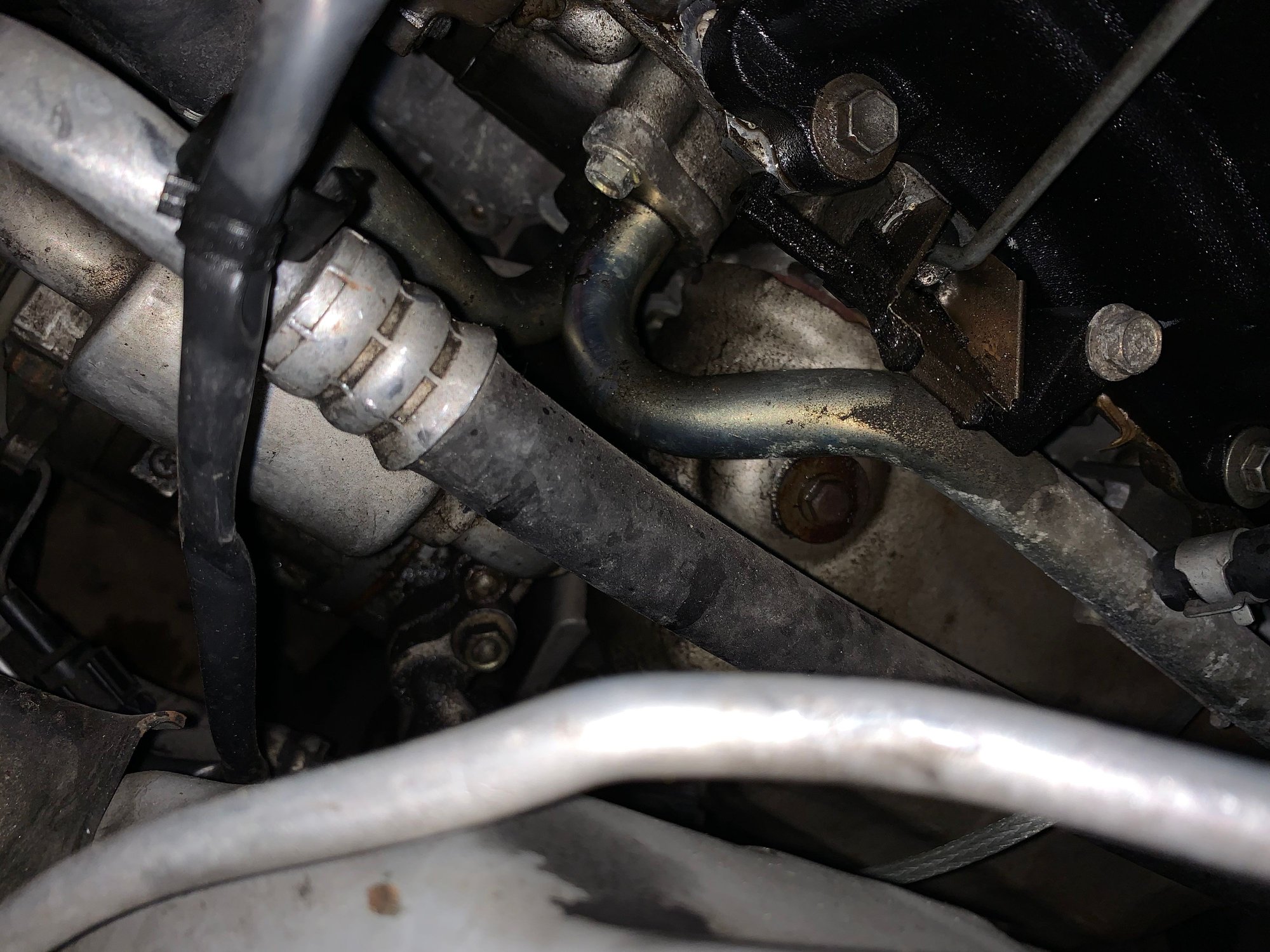

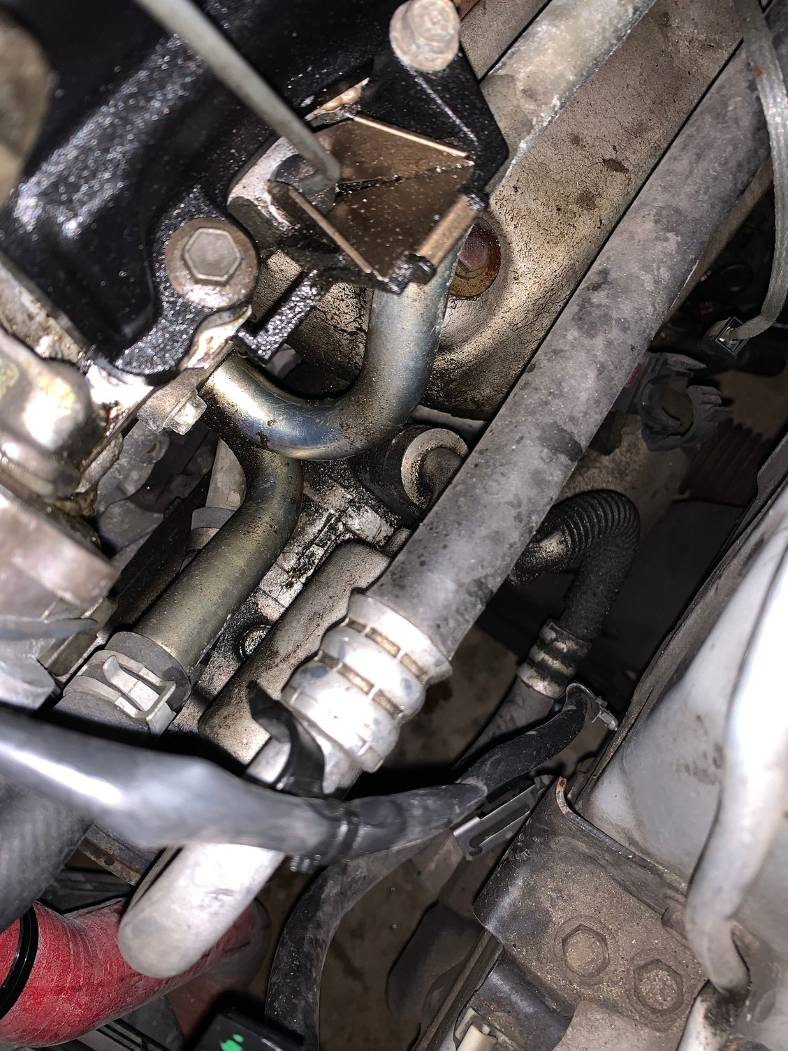

*EDIT* 2003 350z with 83k miles
only mods are ISR resonated test pipes , ISR y-pipe and nismo intake
Im going to try and make this make sense in the best way i put it sorry in not the best at explaining (So i took pictures&#128513
Problems
1. Oil leaking from side of valve cover (Near dipstick)
2. When the car is FULLY warm if i am standing next to my exhaust i can hear very small and quite popping noises (Misfire ?)
3. Also when the car is FULLY warm, if i pull up to a stop sign and pull away at even half throttle SOMETIMES little puffs of whitish blue smoke come from exhaust ( Burning oil/ leaking in from somewhere ?)
I pulled all of the plugs , they all need replaced from looking worn out (Can take pictures of the plugs if needed) BUT there was no oil inside the plug holes. So again the only place there is oil is coming down the side of the engine (Shown in pictures)

It certainly wouldn't explain the exhaust smoke or misfire. Change the oil and plugs to (maybe) help with that.
Are you quite sure the wonky dipstick has always been correctly seated? I'd pony up for a new dipstick gasket before doing covers based on location. Then degrease the area and rinse with low water pressure. Check daily to find the leak source.

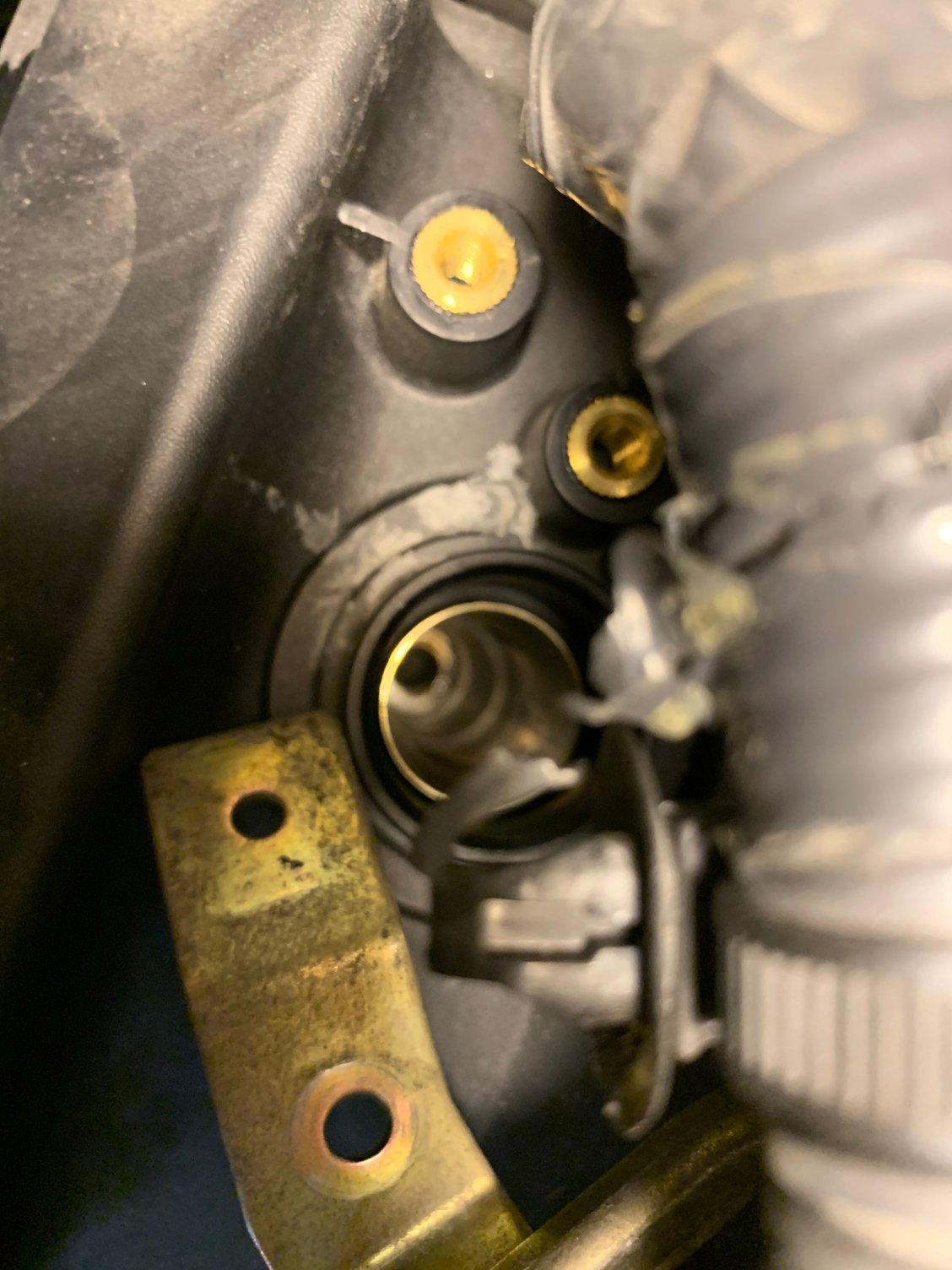

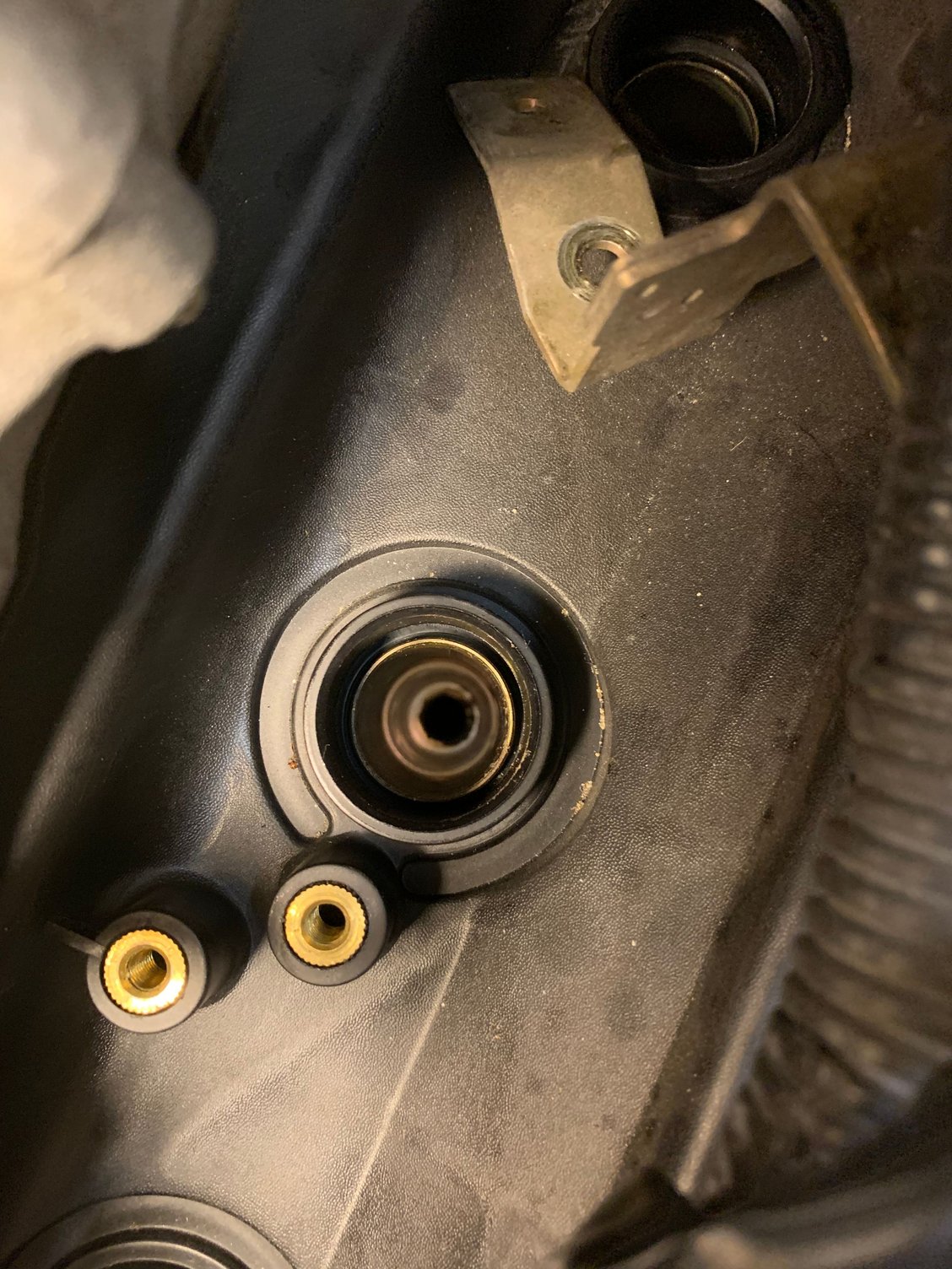

*Another update*
So affer further looking around , ive discovered this (See picture )
There is oil IN 4 sparkplugs Along with oil running down the other side of the engine , i feel dumb for not taking a closer look , but this is why its smoking , this explains the misfire, i appreciate the replys .
