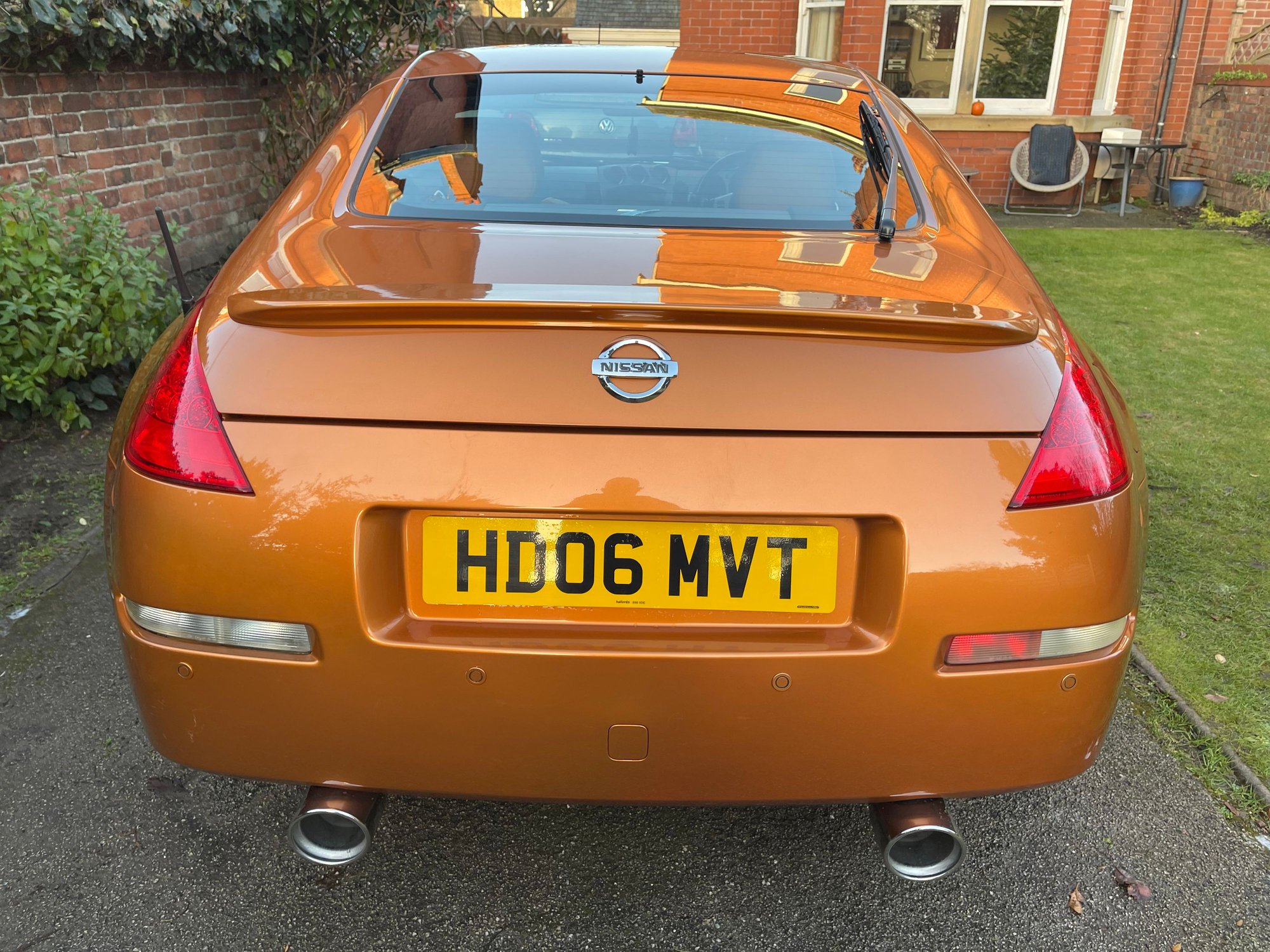

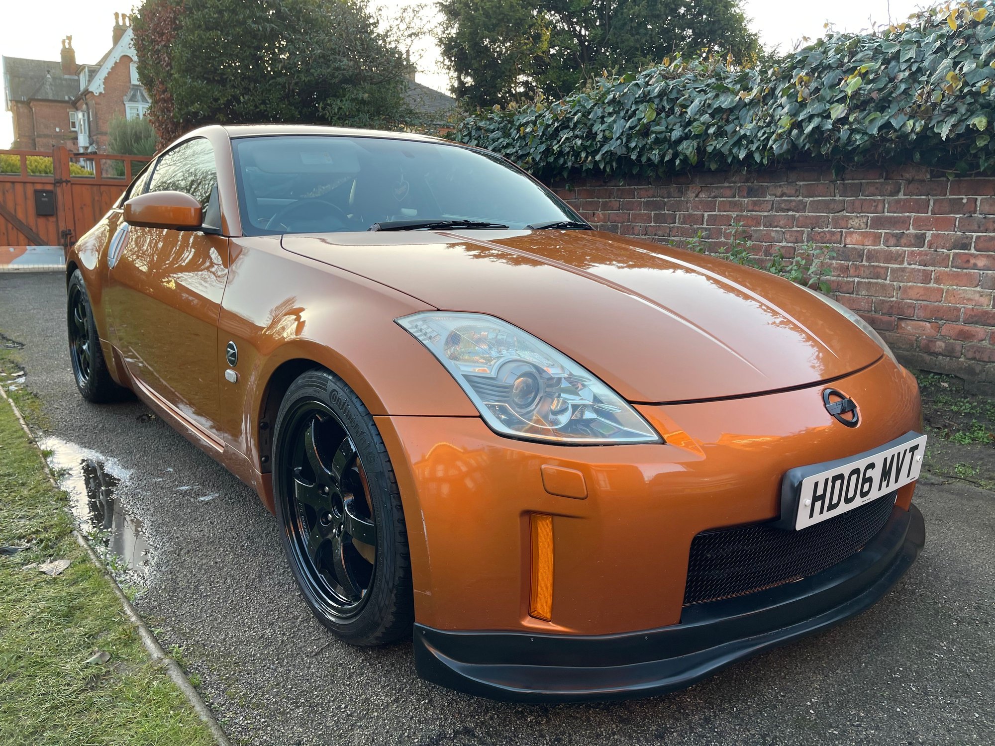

Got my girl back today after 4 weeks … new powder coated alloys / invidia exhaust fitted / protec grill and lower spoiler fitted and black front badge fitted
black door handles turns out are for LH drive and awaiting black decal for rear
next I’m looking for a v good cold air intake system to add please ? Hopefully enhance the performance like the exhaust has … scarily
roof wrapped in black / rear side windows and lights tinted in the New Year also

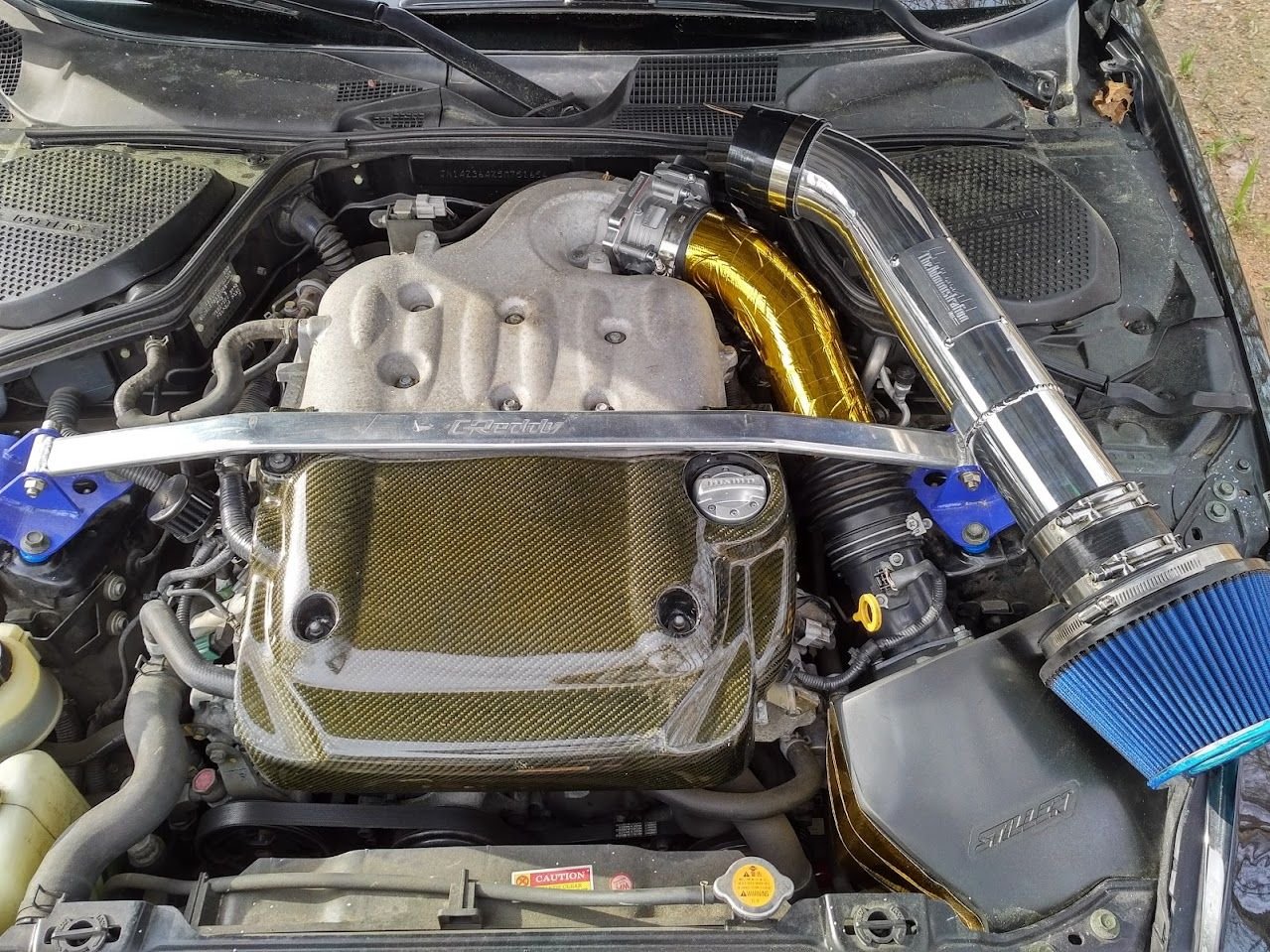

As far as intakes go, this topic has indeed been beaten to death (i.e., https://my350z.com/forum/intake-exha...4-intakes.html)
However, with that said, I would echo the previous comments that the Stillen design is nice with the heat shield to isolate the hot engine air from the filter area. I have a V2 bumper which came with a "scoop" piece which mounts in a way to divert air from the grille into the intake without the danger of hydrolocking. I like the aesthetics of this more than cutting a hole in the bumper. I currently run the 3.5" Admin Tuning intake which appears to no longer be in production. There are others like Furookie (which has been discontinued). I think LMT still makes their 4" intake to order.
Here's a pic of when I was installing the AT intake and a side-by-side comparison next to the OEM piping.
Up to you, whether you buy into it or not. As bealljk said, you will need a tune. If you're looking for big power with N/A bolt-on mods, it's not going to happen. You will spend more money per hp than you would with FI.
But it does make things a little more fun.
I thought you were FI for some reason...ever try to mod the Stillen "box" to work with the Admin intake?
Nope, I'm one of those NA losers
Interesting you ask. That is actually one of my side projects in the queue. I made a fiberglass mold from the Stillen piece and planned on fabbing up something made of CF but I'm only about halfway there. Still working on the final Cardboard-Aided-Design.
