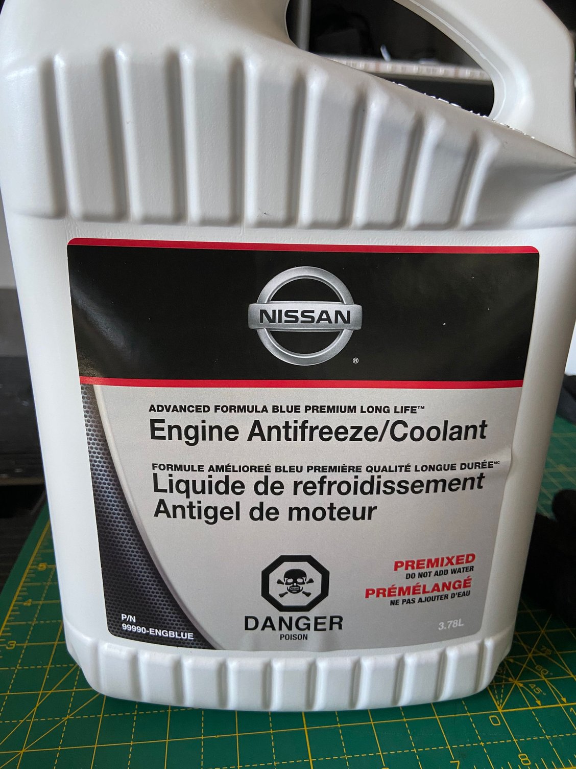

Hi Everyone,
I’m planning to drain and replace my engine coolant. I picked up the Blue “long life” engine coolant (see picture below). When I called the Nissan dealership they insisted not to use the Blue as they said it is not compatible with my engine. I was under the impression that the blue and green coolants are interchangeable. I decided to call 3 different dealerships and all the techs said to only use the green concentrated coolant and mix it 50/50 with distilled water. My car is a 2006 Rev-up and currently has green coolant.
thoughts?

I was a Nissan Tech for 4 years. Around 2013, Nissan started using blue coolant. They recommend not using green in anything newer than 2013. I don't think the blue will hurt your car, but it's more expensive than the green, which is what came in your car from the factory. I'd return it and get the green.

Thanks for the advice! I’ll return it and get the green coolant.

I put a green one as it comes from the factory and would go with it again. I bet a blue one wouldn't harm the engine, but still will put what manufacturer recommends.

I put blue in the Nissan, green in the Mustang, red in Porsche. but who knows if the color actually makes any difference?
