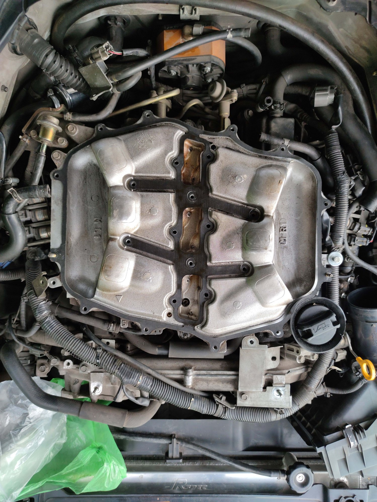

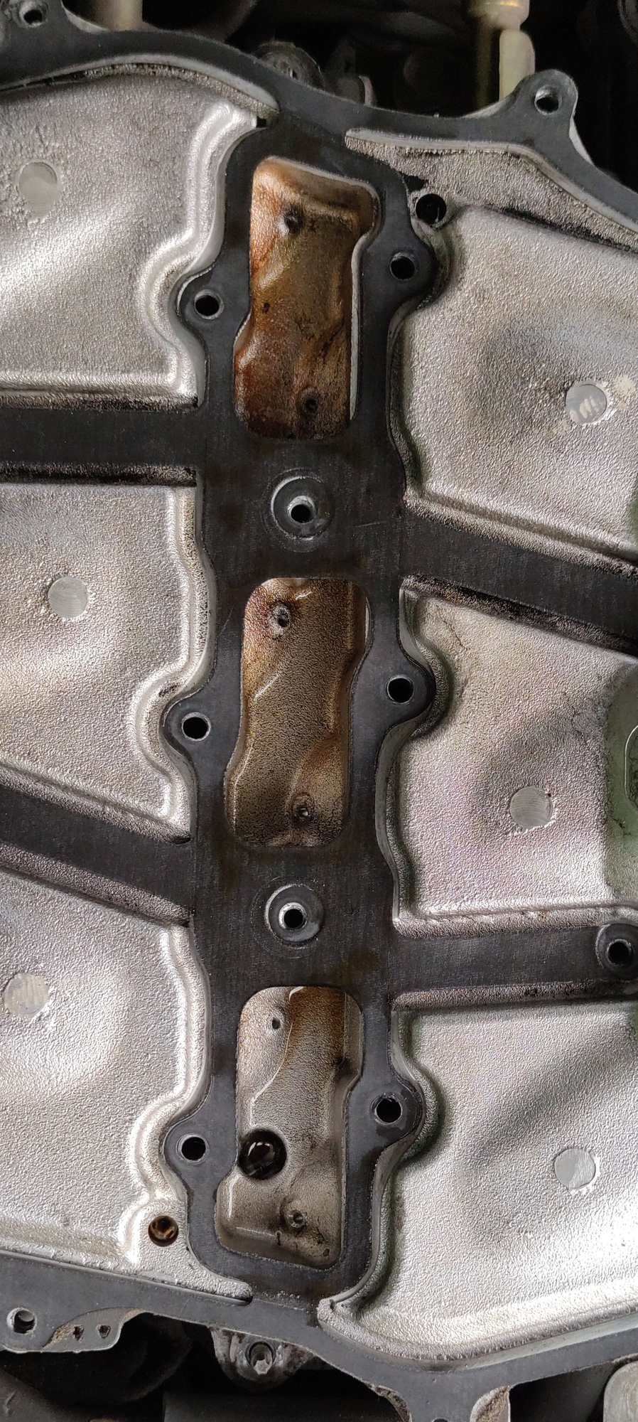

Oil in intake valves in my vq35de, does it look really bad?
Engine is bone stock, has 106k miles.
My symptoms: 1. Loud hissing from pcv valve (changed hose couse it was cracked, changed pcv valve, didnt helped at all)
2. Sometimes, but not always, when i rev it it produce a little bit of blue smoke (i can see it only if i stand behind a car)
My friends says that's becouse of worn out piston rings or bad valve seals, but can it be something else? Car runs smooth, it have power...
Ps. How much oil consumption do you have on these?

good time to replace the pcv, but this is absolutely normal and the plenum has a drain for this oil built in.. and is why some use a non breather style sealed catch can, but otherwise thsi is not needed and the pictures are normal.
Do not do that if you are boosted or youll run boost thru the can and smoke everything.

That’s really clean, most have much more oil. Any time you have a PCV, you will suck some oil down the intake
