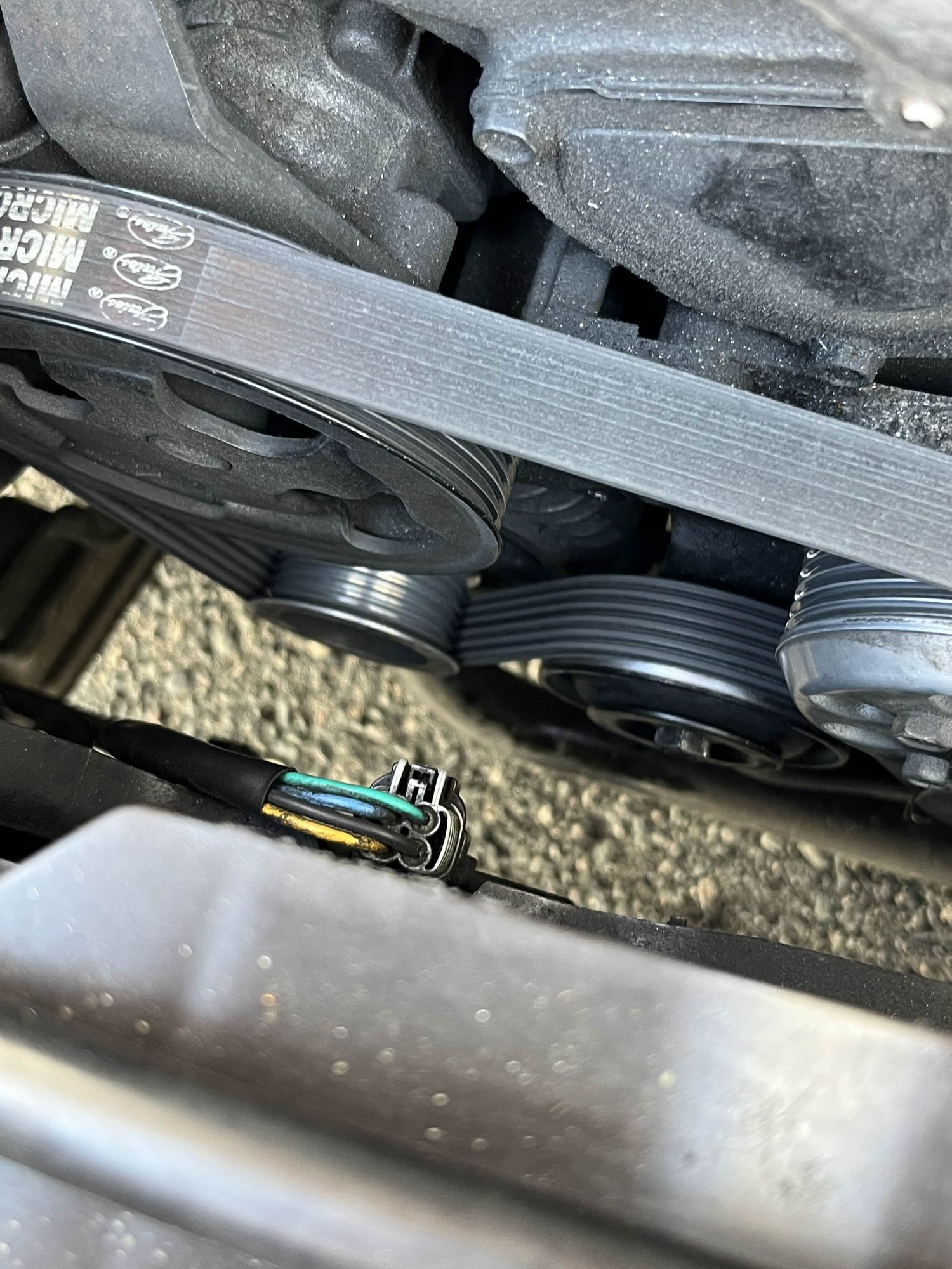

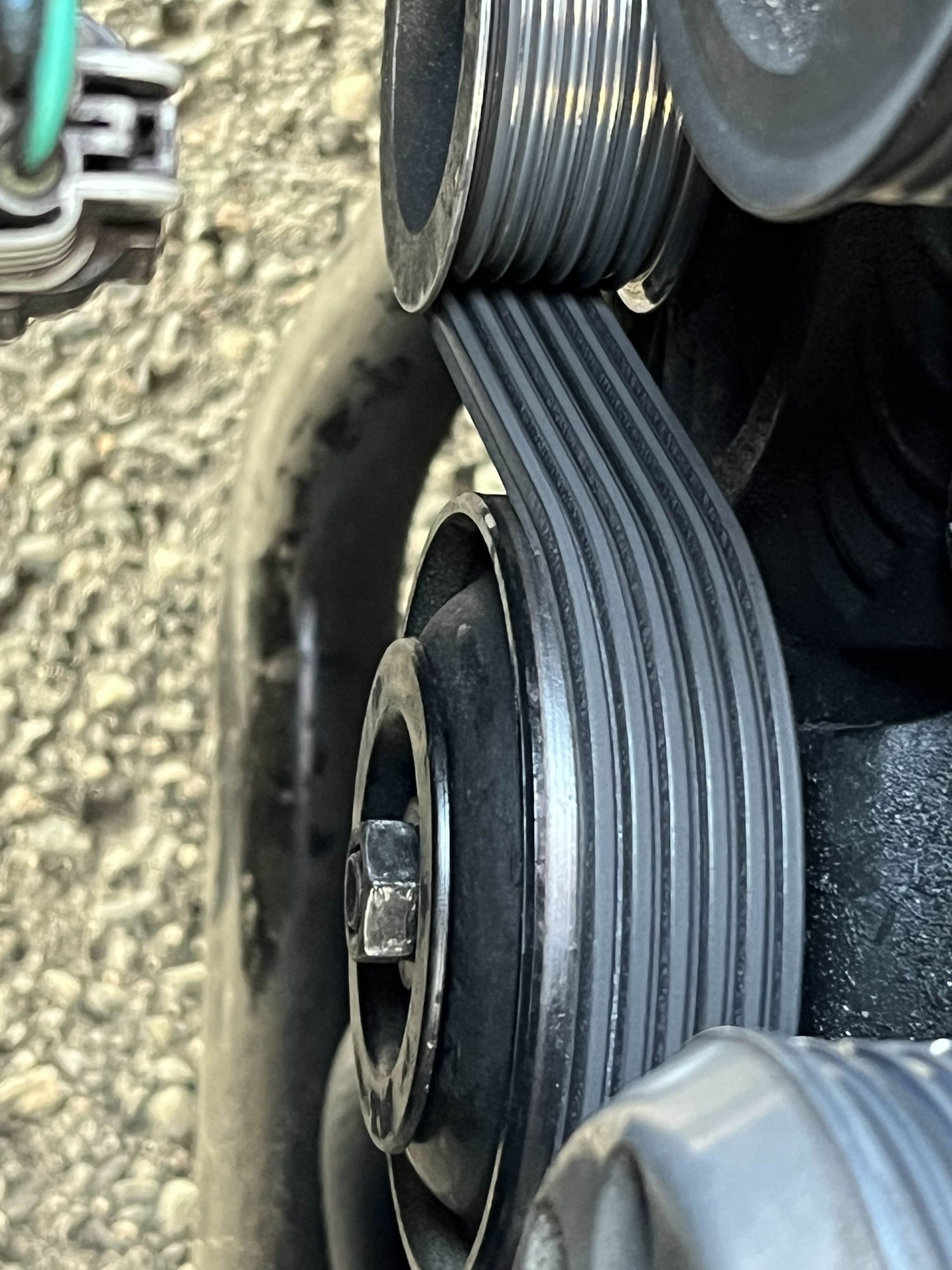

Hi, I've been having a belt squeal issue with my 350z for the past 3 years.
I tried : Changing the belt, putting a product so the belt sticks. putting a washer behind the tensionner so the belt is straight.
Basically my belt is a 5 Rib. All my pullies are 5 Ribs too but my alternator is a 6 Rib. When I put the belt on and push it to the last Rib on the alternator, it dosen't squeak. Its really nice. But when I start the car when it's a little bit humid outside, the belt slips back to the front of the alternator and starts squeaking again!!!
I just want to know if there is a solution for this without replacing my alternator pulley.
The reason why I think theres a solution is because it started after I did my ghallery gasket. Before that, it was fine.
Also, when the belt stops squealing, I can't put the alternator under any tension or else it will squeal again. If I put heating seats, AC/Hot air, Headlights or play music it willl squeal again.

I recommend the idler pulley delete mod, followed by replacing the belt with the updated OEM unit. But before that, have you tried simply tightening up the belt?
Also, I see a lot of oil residue all over the front of your engine. If any of the pulleys were contaminated with oil, it will cause the belt to squeal. If not already done, address the oil leaks, then ensure your pulleys are clean before replacing belts.
I take it the alternator is aftermarket? If the issue persists after trying what I mentioned above, I would try sourcing a used OEM alternator from a wrecker and swapping over the pulleys (I expect the shaft size to be the same). Personally I prefer sticking with OEM alternators and rebuilding them (same for PS Pumps).

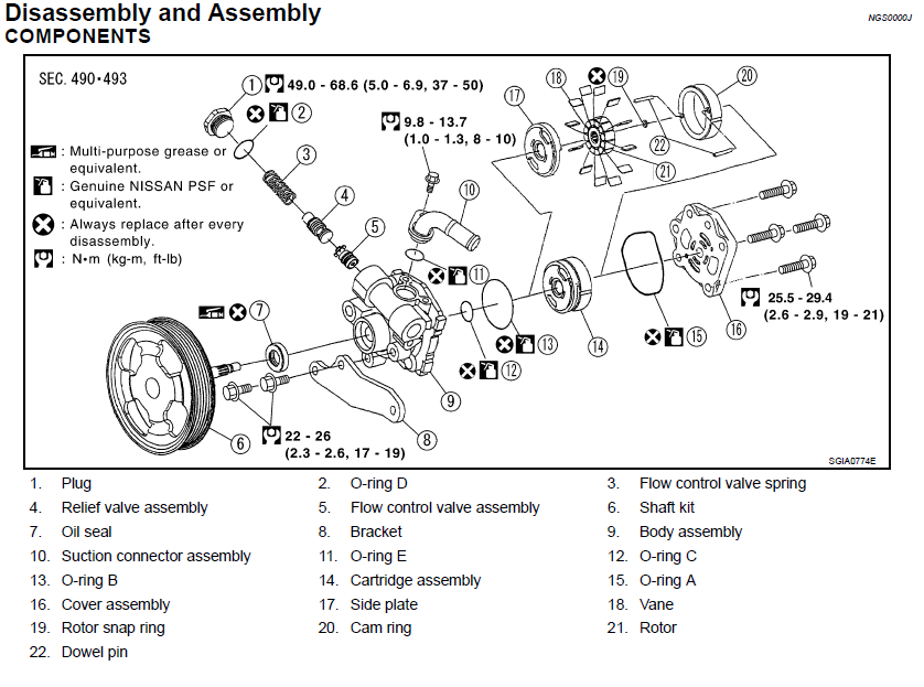

The PS Pump shaft play in your video is a little more than I would like myself. But this type of play is not uncommon on this style of pump. These pumps don't use internal bearings, instead the shaft is lubricated by the PS fluid, similar to how crank and cam bearings work with engine oil pressure. What sets the axial play in the shaft are the main seals on the pump and a snap ring. I just rebuilt a Honda PS pump with a similar design, if the front seal is pressed in too far, you will get some shaft movement, also the seals start to dry out as they age and that can cause similar effects.
Cheers!
-Icer
350Z PS Pump Diagram (Note: From 2006 FSM)
