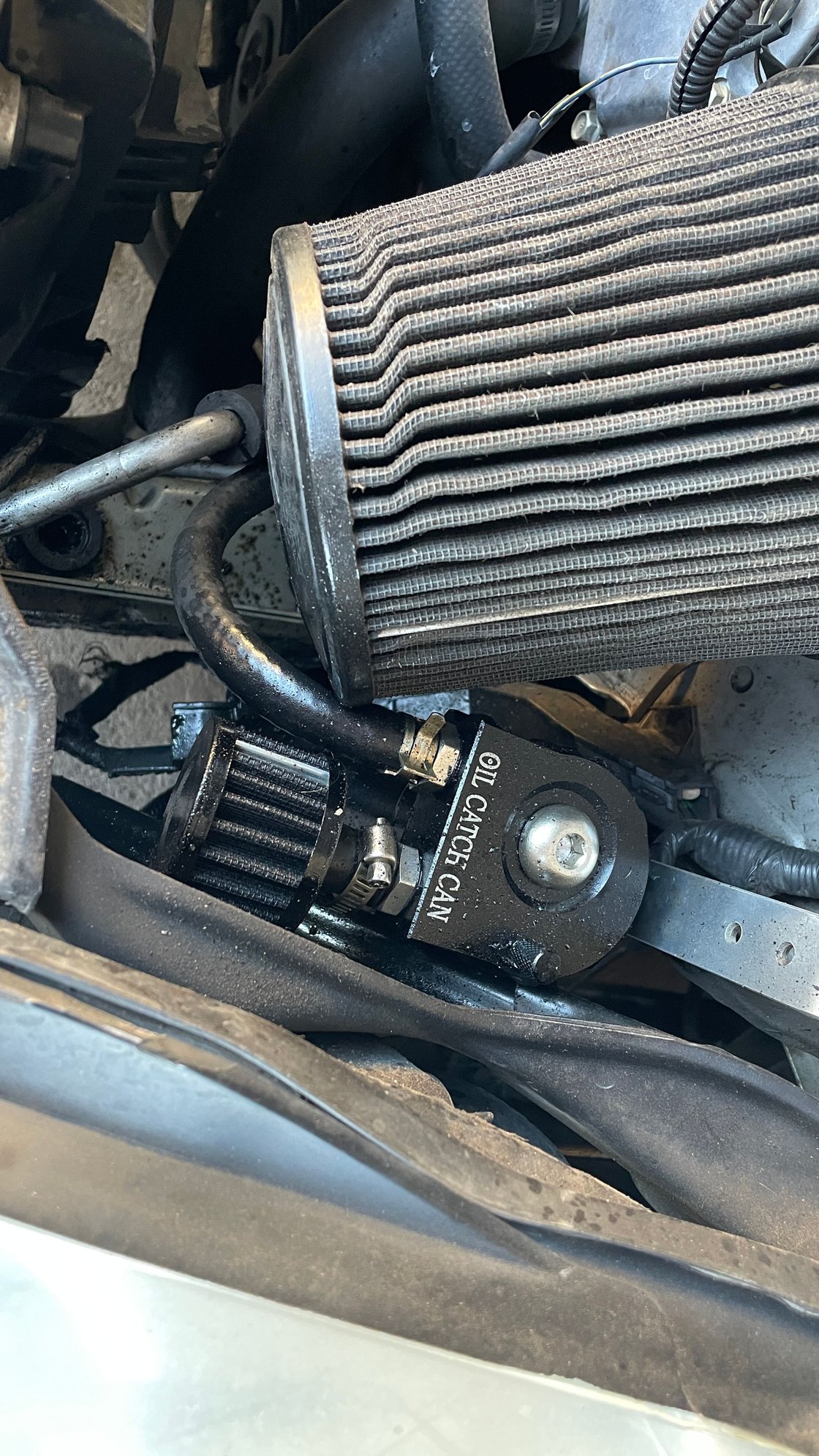

This is the rear pcv port Im referring to. This is the hose currently coming off it which we have routed to the second catch can shown below.
This is the second catch can mentioned.

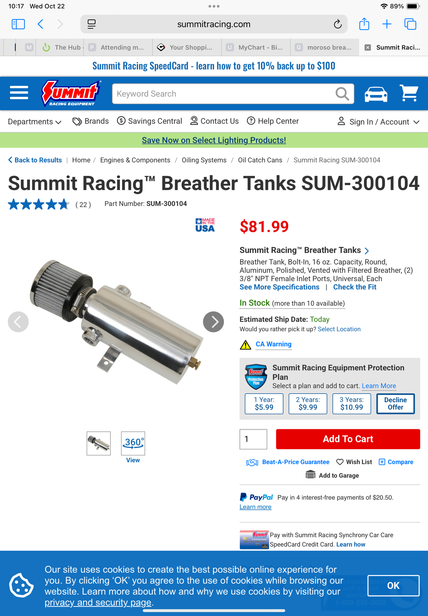

Plug the one on the intake , you don’t want to suck unmetered air as you are doing.
ran from my Pcv to a large moroso catch can with breather , then I ran another line from the drivers side valve cover to that same breather tank.
after every event I would empty the catch can that’s part of the breather , usually had a cup of oil in it
this one is similar, and what I would buy if I did it again

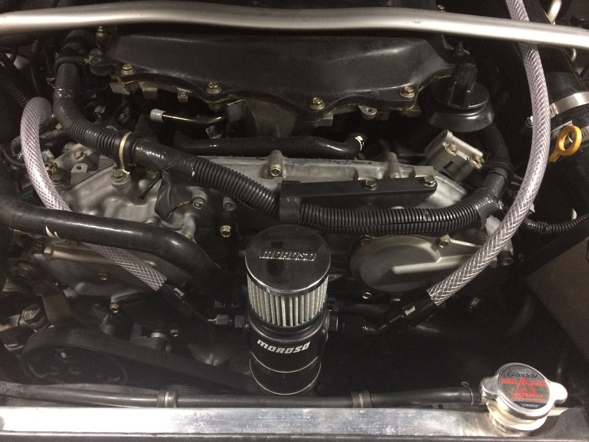

found a picture of mine
