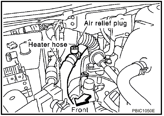

Where do I get the upgraded hose clamps??Autoparts store?
Can you tell me where the relief valve is so I can to get the water out of the system???

Be nice, he was.
There's about 2 pages in the service manual on draining/filling the coolant, I suggest getting it.
Attached Thumbnails Any tips on how to install Samco engine hoses??-relief-plug.gif

Originally posted by 350ed
Be nice, he was.
Thanks for the Diagram...I will try and locate a service manual..
