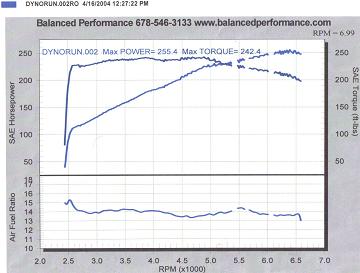

I got on the dyno at balanced performance last week my results are in my sig......
if you go to RWHP? Thread here https://my350z.com/forum/showthread....threadid=70153
I posted a link to very good article on dyno's
I ordered one of these also hope to have it thursday
heres my dyno printout

all over this forum people have said to dyno in 5th gear, i told the dyno operator to dyno in 5th, and he said no we wont do 5th, after i told him that everyone has told me to dyno in 5th on the forums he then said "oh ok, i didnt know, but its good to know cause we have dynoed alot of these cars" this tranny is very close in ratio, 4th gear probably wouldnt have yielded much higher numbers.
my numbers look almost identical to duflacci but mare about 20 hp lower, the cross of hp and torque is in the exact spot, the fall off of torque,
