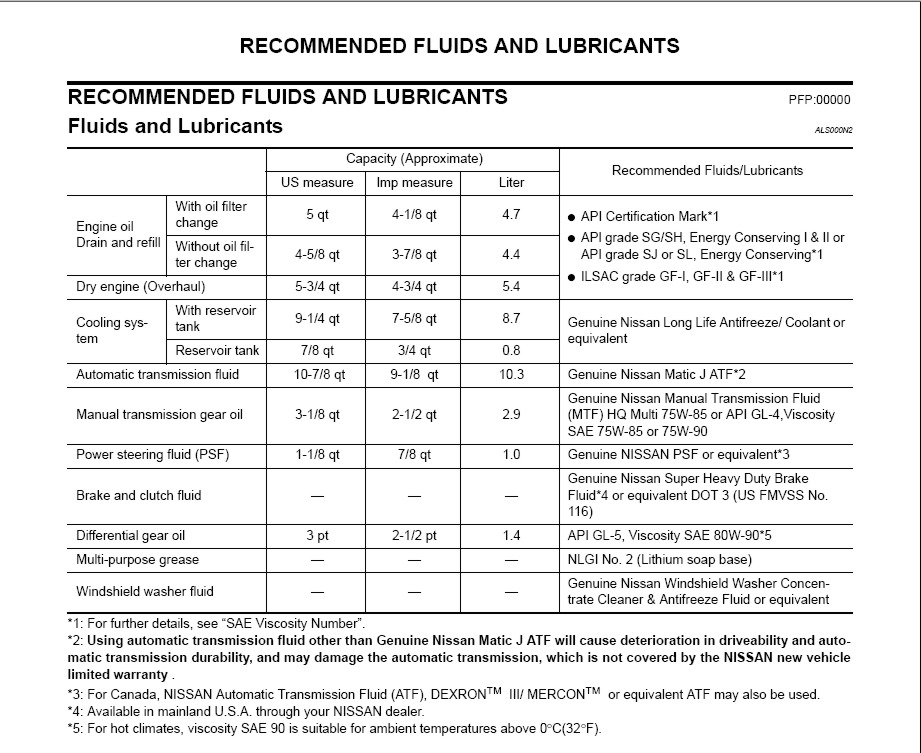

Here is a chart for reference.
Attached Thumbnails Changing the Differential / Transmission Oil-350zfluids.jpg
