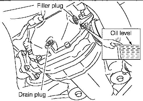

its in the rear. look under from behind should look like the picture below. can't miss it. hope this helps.

yup got it. thank you so much for the diagram.

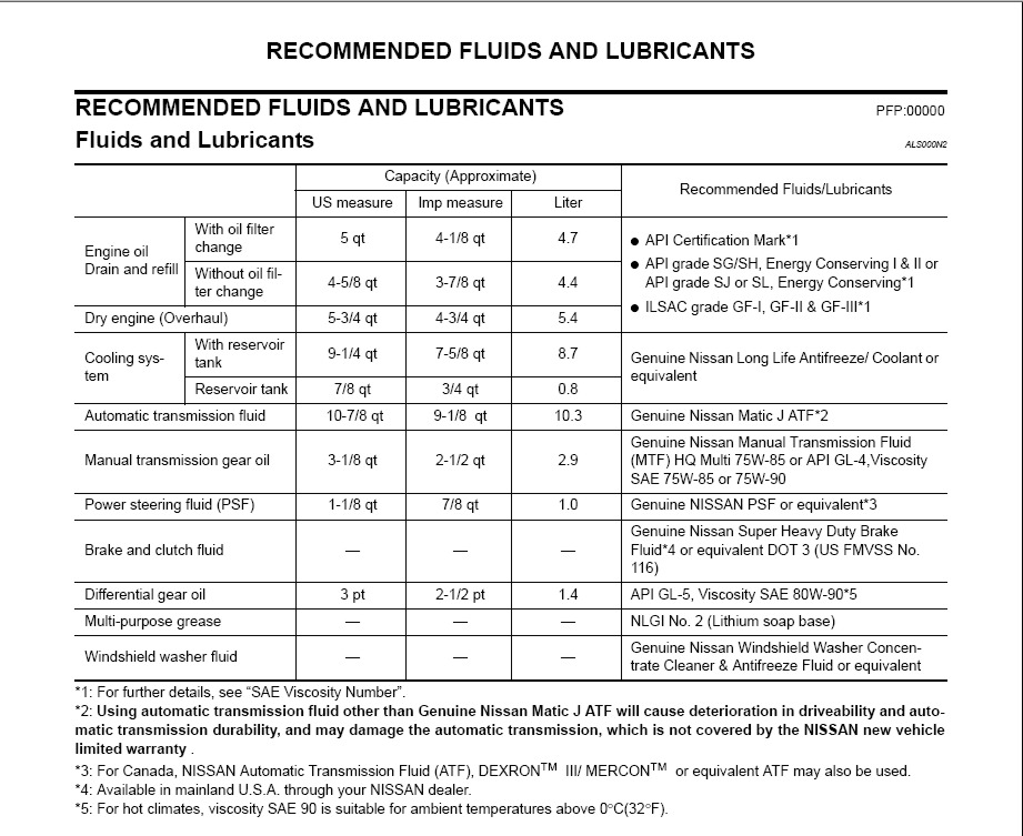

Just read the whole thread and just want to confirm with you guys if i got this all correctly before doing this procedure.
I own a 350z 2005 Touring Automatic.
1. For the differential fluid I should use 2 quarts of either one of these:
RedLine Gear Oil - http://www.amazon.com/Red-Line-75W90...4574818&sr=8-1
Mobil 1 - http://www.amazon.com/Mobil-98W573-7...4575900&sr=8-1
Amsoil - http://www.amsoil.com/StoreFront/agl.aspx
2. For the ATF should I buy 10 quarts of the Matic J ATF if I decide to do a Transmission flush? According to the 350zfluids.jpeg image it needs 10 qts. Just want to make sure. Also can someone give me a link as to where I can purchase the Matic J ATF, I can't seem to find it. Would really appreciate it if someone can't give me a direct link.
3. For the crush washer I searched for the part here and I'm showing for different kinds for the 110264N200. Which one should I get?
http://www.trademotion.com/partlocat...&siteid=214252
Attached Thumbnails Changing the Differential / Transmission Oil-350zfluids.jpg
