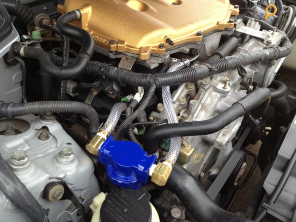

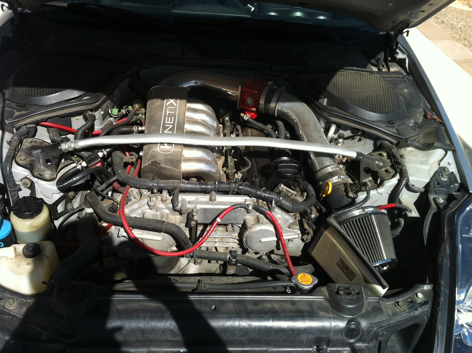

Has anyone else noticed less and less oil in the CC? I've had i8acobras (the one in the pics) on for over a year now, and I find myself dumping the oil out less frequently.

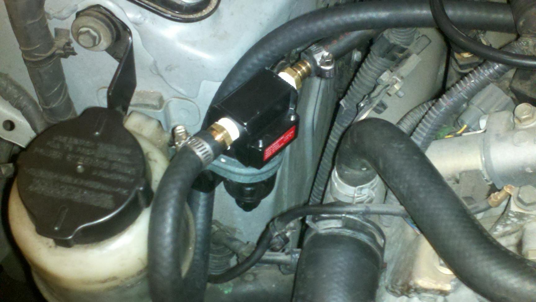

I recently replaced my valve cover gasket. While I was at it, I noticed my plenum had more oil in it than I would like. I decided it was time for a catch can, so I went ahead with this thread. I added a 1 1/4 metal hole strap, and bolted it to the power steering bracket. I might grab a 90 degree brass fitting to make it a bit straighter of a run though.
Attached Thumbnails Homemade Catch Can-2012-03-11_22-20-23_437.jpg   Homemade Catch Can-2012-03-11_22-20-30_254.jpg

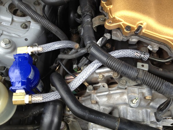

I finally completed my home made catch can...
I noticed quite a few members have used regular hose but I opted to use the clear braided hose so I can easily gauge the effectiveness of the catch can. It seemed quite natural to mount the catch can on the power steering reservoir bracket. Right now I have a few zip ties holding it on till I find an adequate and clean solution to permanently affix the can to the bracket.
I just noticed woody03 used the 1 1/4" strap, I'll have to give that a try.
Attached Thumbnails Homemade Catch Can-oil-catch-can-003a.jpg   Homemade Catch Can-oil-catch-can-005a.jpg

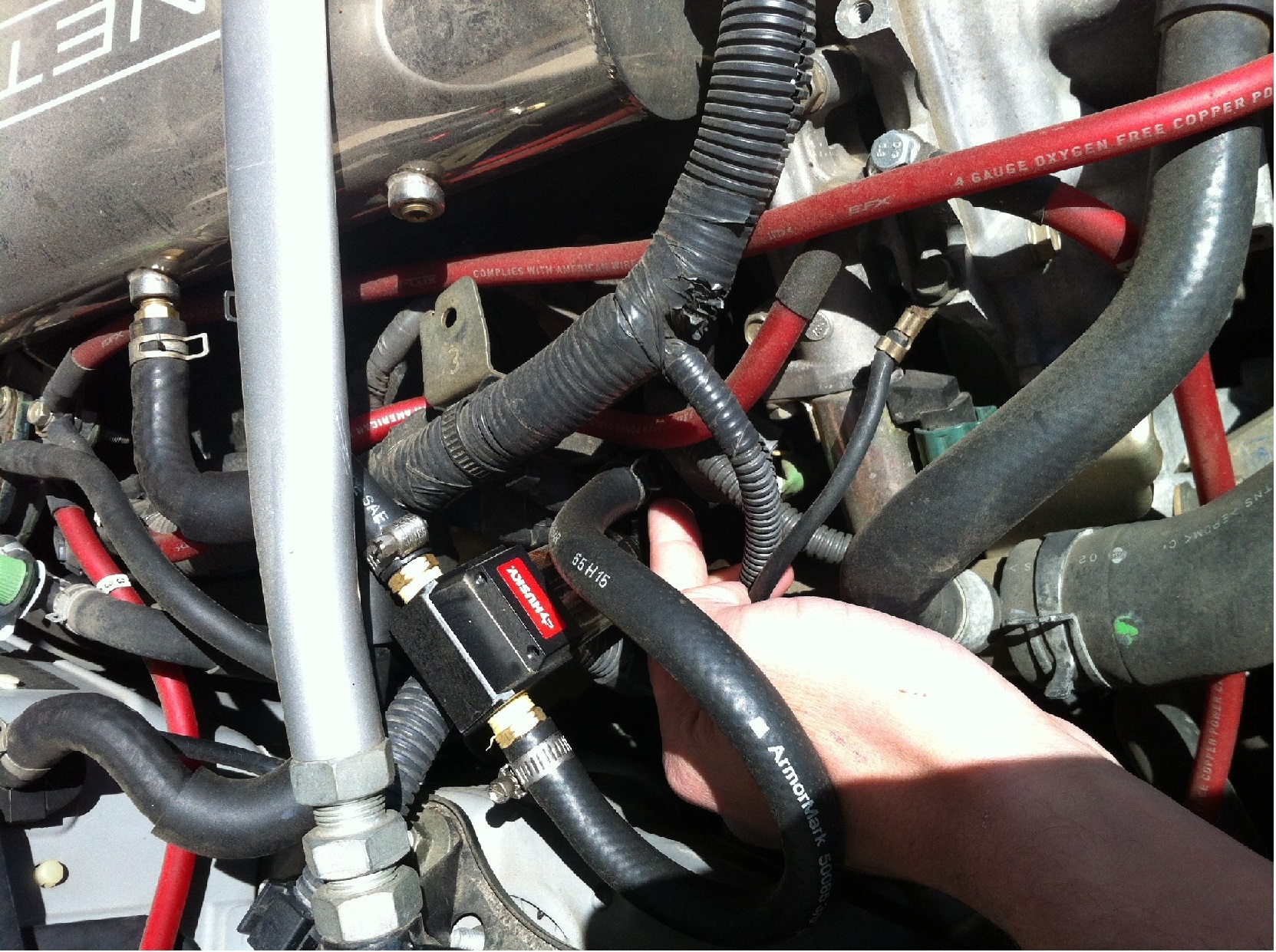

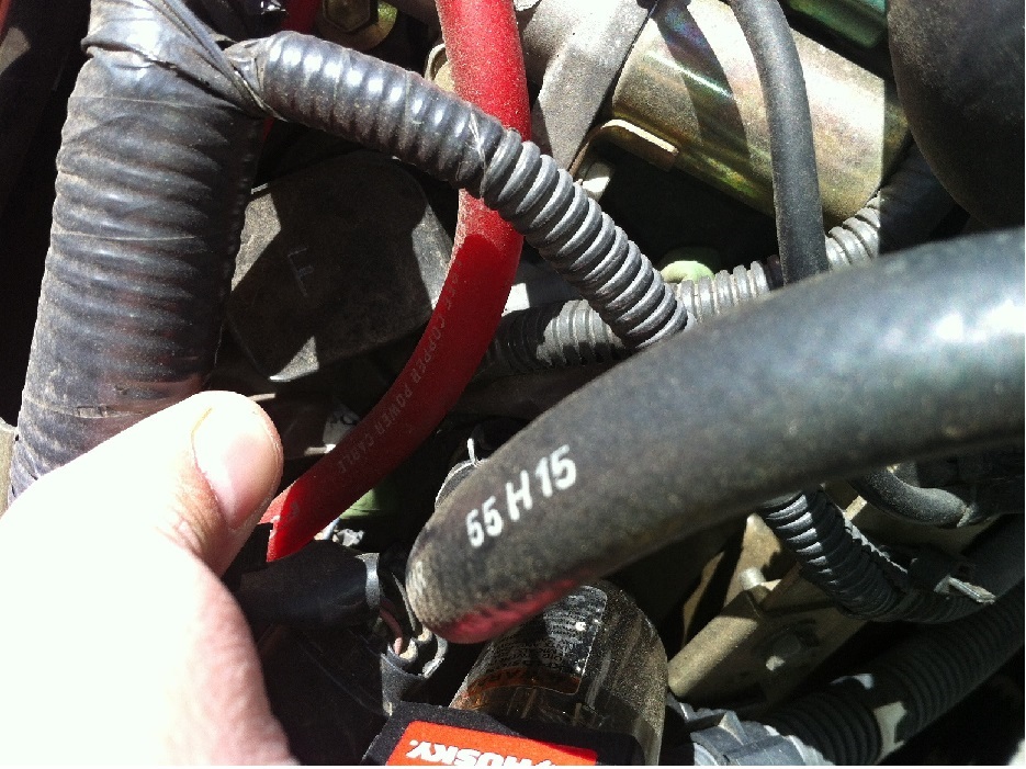

Old Mar 13, 2014 | 10:29 AM
  #279
npr350z's Avatar
npr350z
Joined: Jul 2012
Posts: 967
From: way down in the valley
the hose to be concerned with is right next to the first spark plug on the passangers side. just follow it up to the front of the intake manifold. see attached pics. i have a different intake manifold, but it shows you where the hose is at on the valve cover and just follow it up. sorry for the dusty cellphone pics!
sorry had to resize photos
