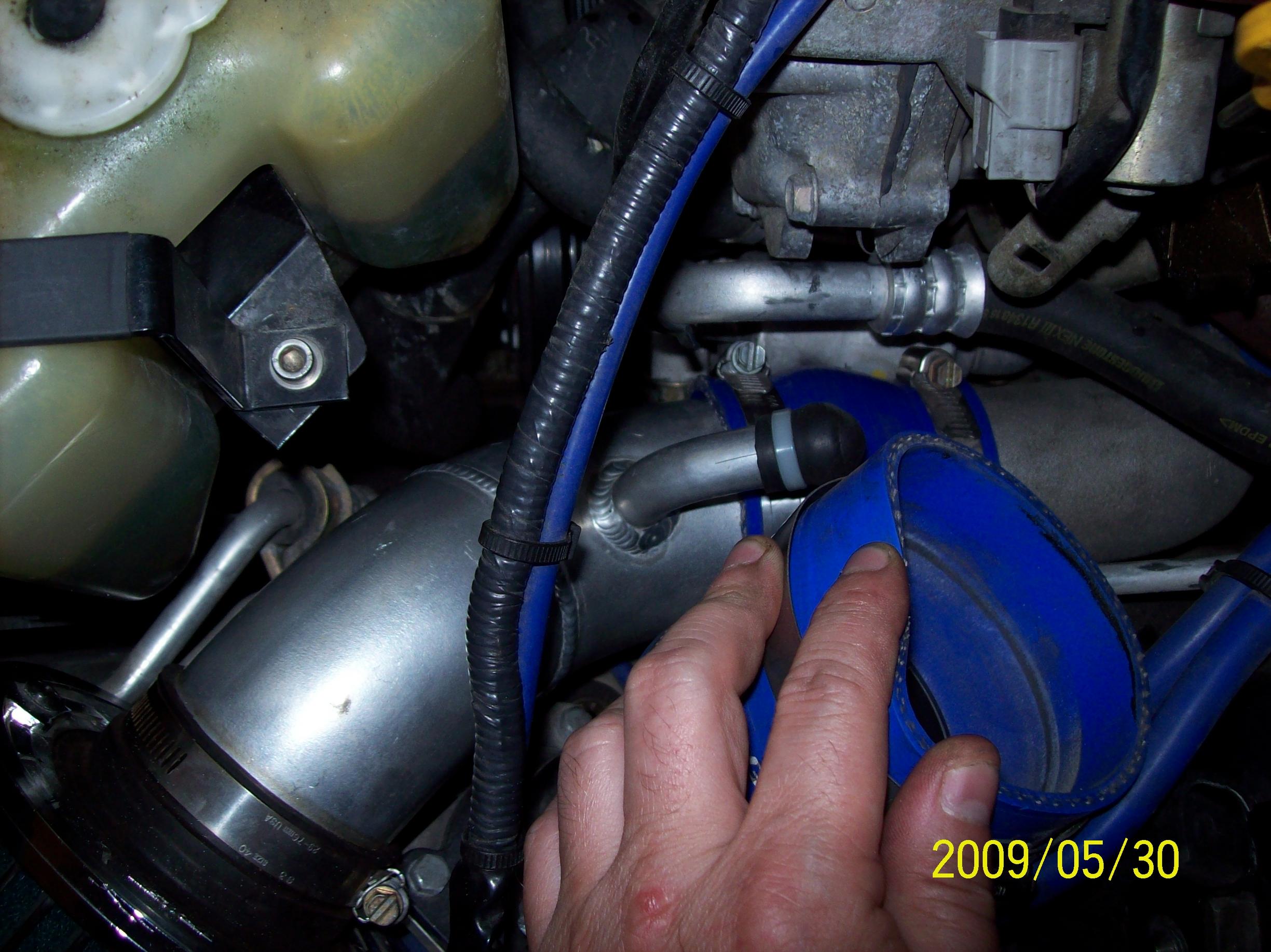

Just thought I would throw in my 2 cents, got my breather filters from advanced auto, all other parts from Home Depot
Attached Thumbnails Homemade Catch Can-100_0305.jpg   Homemade Catch Can-100_0303.jpg   Homemade Catch Can-100_0307.jpg   Homemade Catch Can-100_0302.jpg

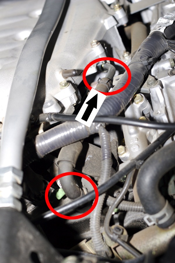

ok what i dont understand is that the HR guys are putting a catch can on the passenger side one, but isnt this PCV also on the driver side?

Since it goes from the crankcase to the upper plenum This should be the correctly direction of flow right?
About to install one on my Z. Long over due!

Old Apr 13, 2010 | 03:06 AM
