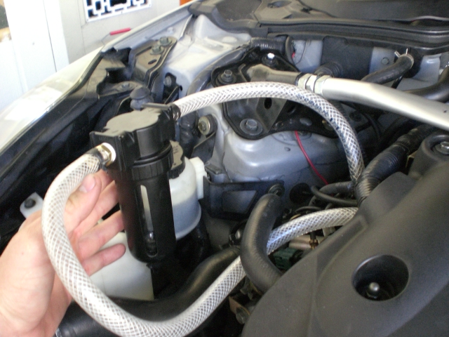

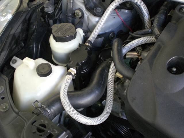

here's the one I made from the home depot husky version....
Attached Thumbnails Homemade Catch Can-catch-can-1.jpg   Homemade Catch Can-catch-can-2.jpg   Homemade Catch Can-catch-can-3.jpg
i got this hose from home depot also.. its not very good with heat
yea I figured I would give it a try since I was already there... and I've seen some buddies use it on some of their projects... but thanks for the heads up
