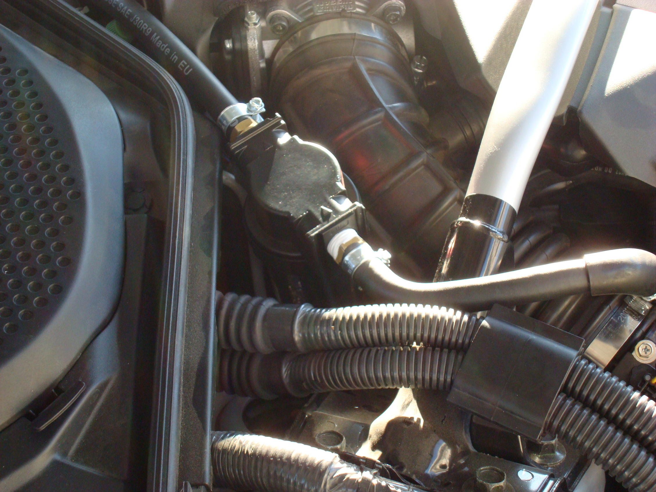

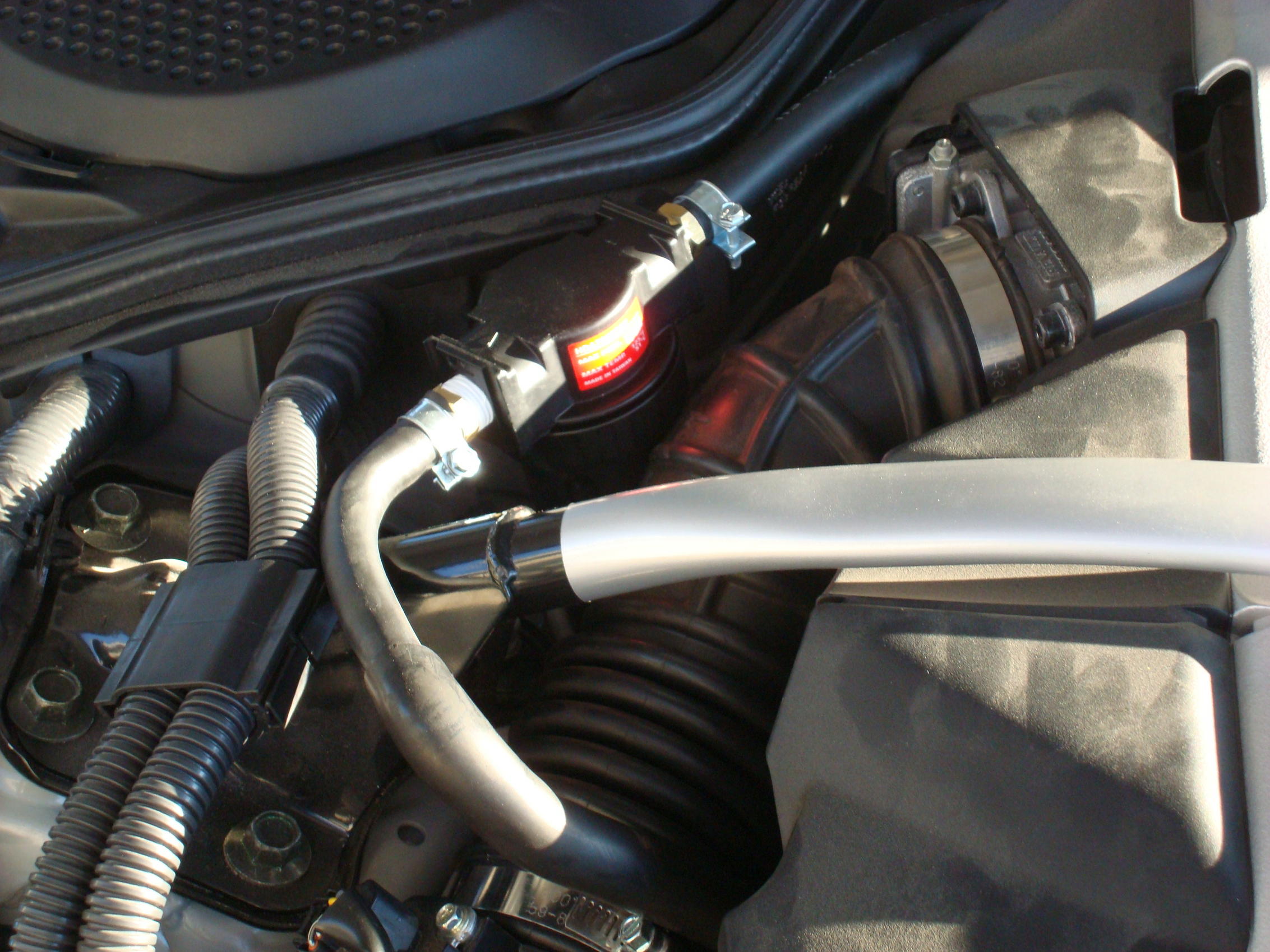

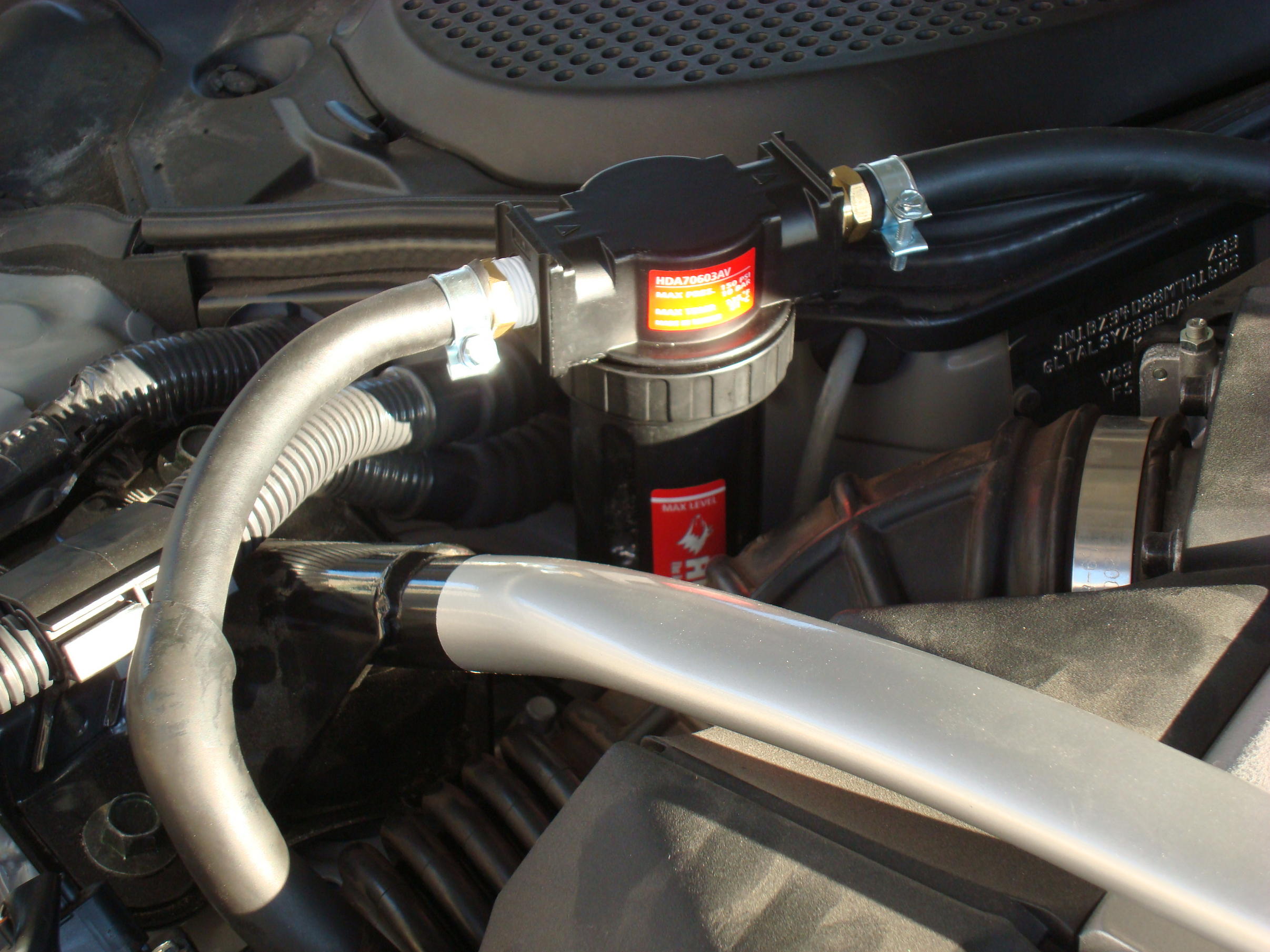

Just got done with mine. I hear a hissing sound and can't seem to tell if theres a leak or the bowl plastic is so thin you can hear the air rushing through it. Does anyone else hear a hiss. I already sealed the bottom drain plug. Here are some pics.
You most likely set it up just fine. The hissing sound is probably just the air rushing through the catch can. I asked the OP the same question a while ago, and that's what he told me.
Thanks thats what I thought also. Really wanted the aftermarket catch can, but just couldn't fit it anywhere. Even this home depot version is a little bigger than some of the guys here are using. As far as the hiss, from what I've read, the suction on the HR is quite strong, so its got to be the air rushing through.
