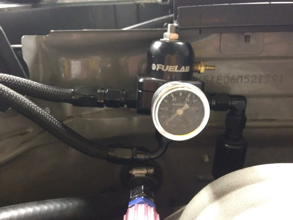

you need to use the CJM fuel correction kit if you are doing a full return system like i did. sideways here is a pic and info you needed.
Top line going is is the feed to the FPR. This comes from the passenger side bottom fenderwell.
The line coming out on the top is the feed line with inline filter attached that will run to the back side of the passenger side of the fuel rails.
The line coming from the bottom will be for your return in which you will need to have a line run from the tank under the car and to the FPR. You will need to use the CJM fuel correction kit for this as well. You can get the lines and fitting from jegs or summit ect.
