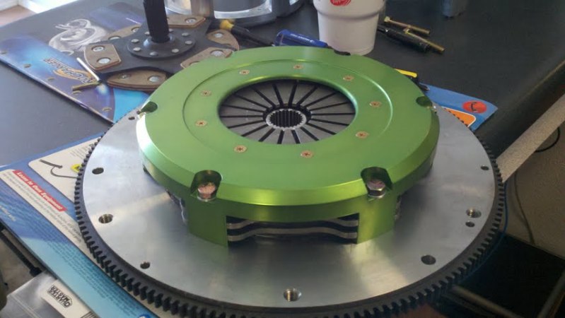

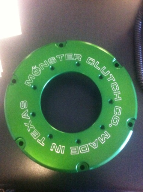

I saw this on some of the other forums. They are currently working on a clutch for us as well. Hoping that they are able to come out with a clutch to replace my RPS. Nothing wrong with it, just want to use their product and give them a chance to get into the import market. They have a great rep with the LS motors, so hopefully the transition to us is great as well. 24 WARRANTY ON THEIR CLUTCHES AS WELL.
Here is the write up I found.
Hello all,
FINALLY!!!! We are very proud to announce our twin disc lineup for the GM LSx based platforms!
Our new billet aluminum twin discs are designed, tested, built, and assembled here in house to the strictist tolerances to ensure you guys are getting your monies worth. We're so confident in our new twins that we put a TWO YEAR warranty on these units, that's yet another industry first! With the ability to hold from 700hp to 1500 and beyond we're confident we've got a twin for you. Every part of the clutch is made in the United States of America, absolutely nothing on these units are brought in from overseas. We feel these are the best twin disc units on the market, bar none. Not only do these have excellent street manners they can take a severe beating as well.
At two plus years in the making we're not screwing around. These things have to be an improvement upon our already incredibly popular singles and push the envelope of the twin disc market beyond what most of you are used to. You won't find any stamped steel import pressure plates stacked on top of two discs, you're not going to find any sub par parts inside, all you're getting is American made quality that will handle the rigors of daily driving and track abuse.
Billet Cover:
Pre Production billet cover:
Production Pictures:
Below are some key elements to our twins -
One piece billet aluminum covers
4140 floater and pressure plates
Progressive rate diaphragm springs (Very important! We don't use "break over" type springs on our twins, this means you have a steady pedal pressure and ZERO high rpm shifting issues as these have been tested to 10,000 rpm)
Organic with marcel spring and Ceramic Matrix Frictions
Billet Steel flywheels with two weight options (28# for the masses and 18# for the crazy road racing/autocross guys that are looking for the lowest MOI possible)
Fully rebuildable (Rebuilding your clutch also resets your 2 year warranty!)
An actual stable feeling clutch pedal (Gone are the days of the puny clutch pedal that has no feedback and gets limp when you're using and abusing it, our diaphragms give steady pressure every time)
Balanced from us as an assembly
Tested and proven at rated hp/tq, no gimics or bs
We are currently taking orders for these clutches with expected ship times (depending on sales volume) 1-3 weeks from your time of purchase. We'll be doing all we can to get these out in a timely manner, however, please understand that a lot of folks have waited two years for us to release these, there will be a bit of a delay initially.
