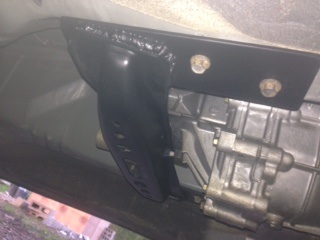

Here's the trans bracket

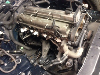

Old Jun 17, 2013 | 01:20 PM
  #140
3fidzhr's Avatar
3fidzhr
Joined: Feb 2013
Posts: 44
From: Ohio
