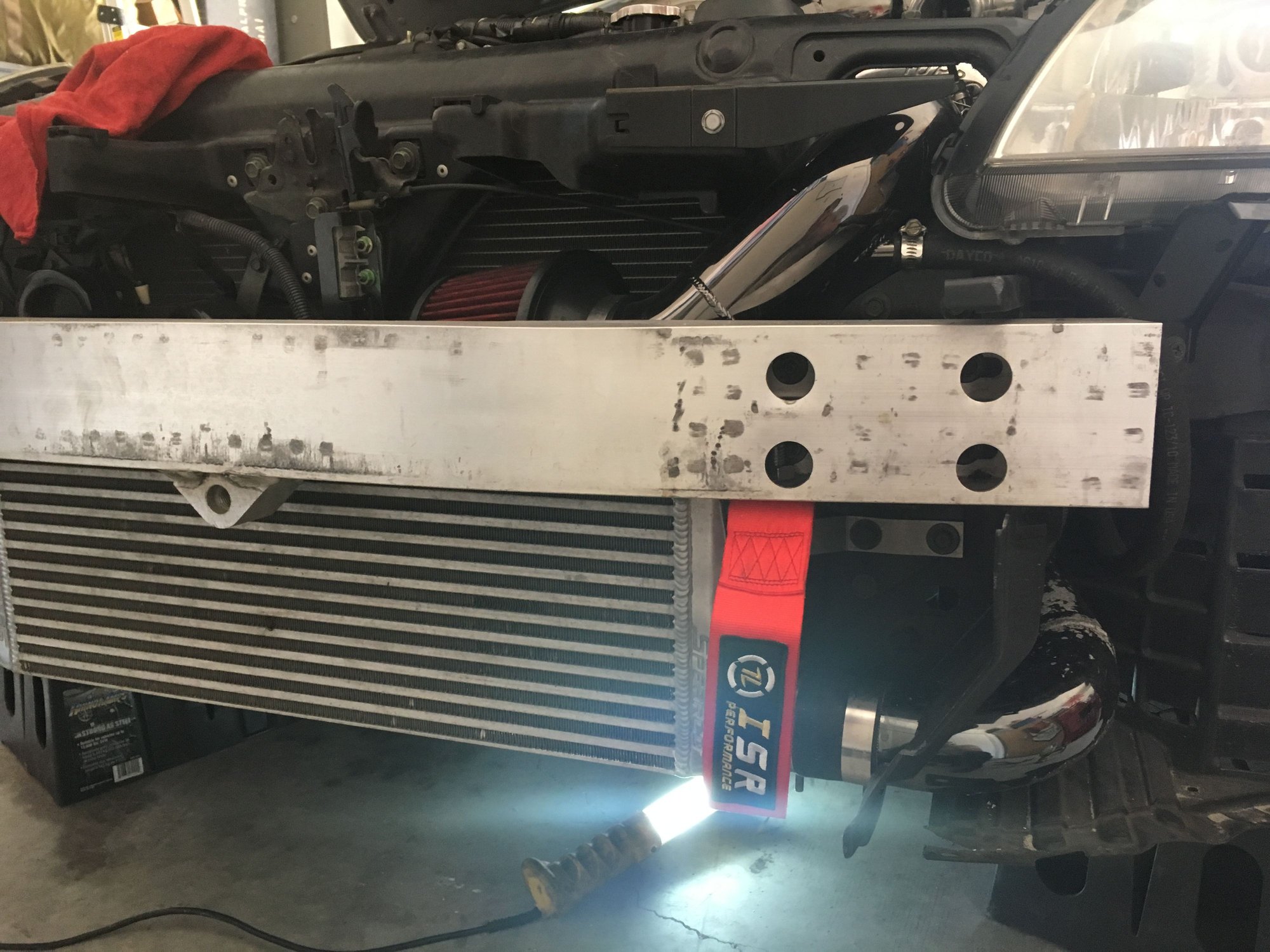

Here is the turbo setup, very clean and I currently have the motor, trans and turbo kit up for sale.

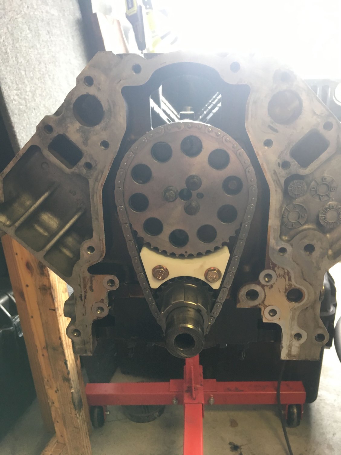

Ls2 timing chain/sprocket Timing chain dampener
