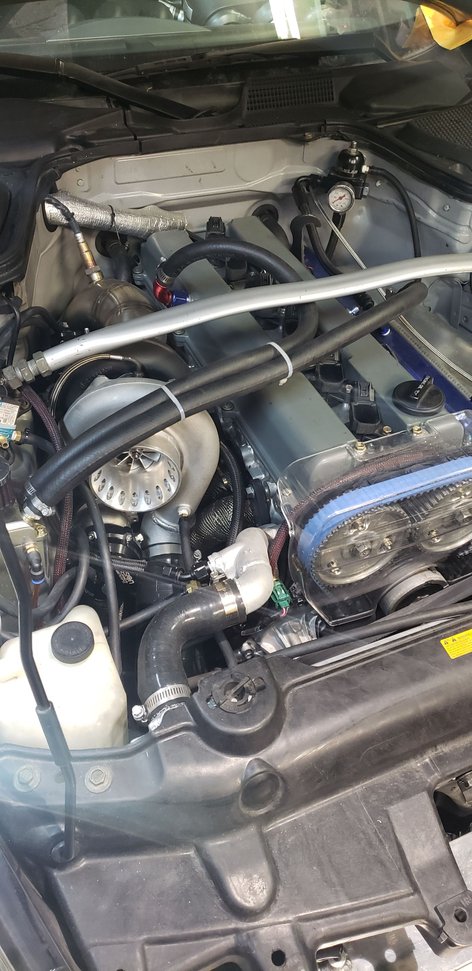

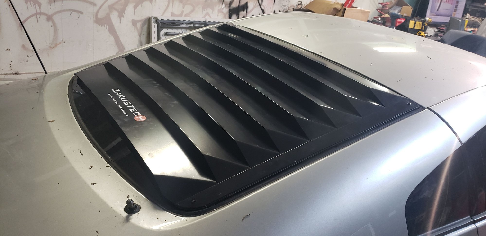

Soooooooooooooooo I spoke with the tuner today and the car is getting dyno'd tomorrow at 4 pm PST!!!!!
CORRECTION TODAY at 4 PM, didn't realize it's 12:30 AM pst!!!!
WISH ME LUCK BOY'S
Also installed the louvers just finished working on the car didn't have time to install the nismo suspension, I had to install new plugs and gap them to .026, change oil, put 94 octane in the car, and a bunch of other little things to get ready for tomorrow!!!!
Don't mind the catch can lines they are temporary.

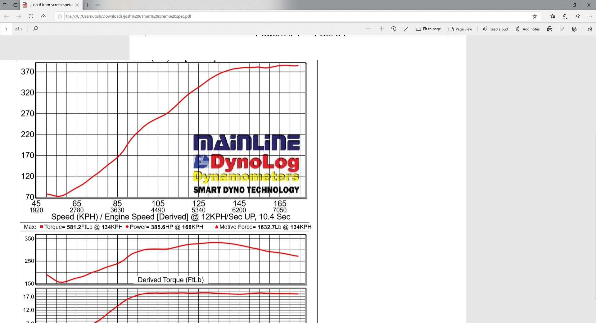

Final numbers dyno is reading 16-18% lower and peak hp is around 450whp on pump gas with stock cams, ran out of octane e85 will make a huge difference, that will be coming later.

From: North Denver
Right on - happy the car rolled on to and off of the dyno under it's own power!
What boost level got you to 450hp?
What do you think the engine will make on E85?
How was the Link to tune on?
Old Feb 23, 2020 | 09:36 AM
  #188
Raggan's Avatar
Raggan
Joined: May 2019
Posts: 162
Likes: 62
From: BC
18 psi
600 on e85 we ran out of octane
The tuner tunes links all the time he's very familiar with it, he almost only uses them specifically.
The car was tuned by a private tuner Bill from indy speed. He is a well known tuner that is no longer open to the public

Here's 3 dyno runs

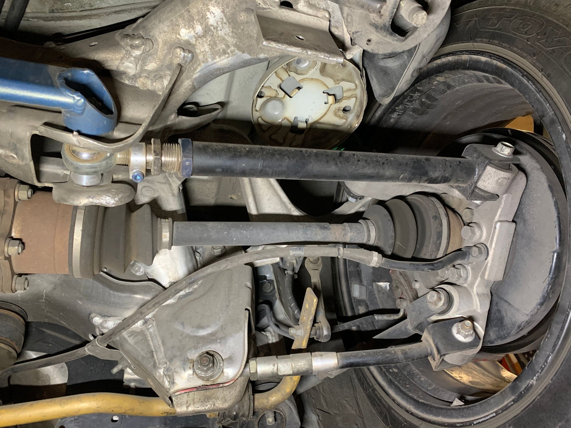

hey guys, how is the Z1 stuff ?
Looking at some, and some diff bushings with aluminum sub frame sleeves
Z1 Motorsports 350Z / G35 Adjustable Rear Traction Arms
https://www.z1motorsports.com/z1-pro...undledTogether
I was also looking at SPL but it's so expensive, maybe for good reason. :P
Old Feb 27, 2020 | 08:36 PM
  #198
rustyschopshop's Avatar
rustyschopshop
Joined: Mar 2014
Posts: 1,405
Likes: 374
From: Watauga, Texas
I have voodoo13 camber arms and they are pretty nice. From what i have seen from local guys the z1's are pretty good as well, especially for the money. If you can find out wether z1 uses forged or cast ends to determine which ones to go with. Z1's do look cast but don't know this for certain. One reason i went with voodoo13, they use QA1 rod ends. If i had a way to source the additional money i would def go with the spl titaniums. Superior quality and very easy adjustments that your alignment shop will appreciate and save you money when having adjustments made.
If it was me, Id buy the SPL. They are substantially beefier/bulkier, feel heftier (as compared to what's in Z1's picture). I have stillen camber & toe adjusters on the rear and I'm going to switch them to SPL as funds permit.
And nothing against Z1 - I think they make fine stuff.
Downside, yea, they are twice as much ...
