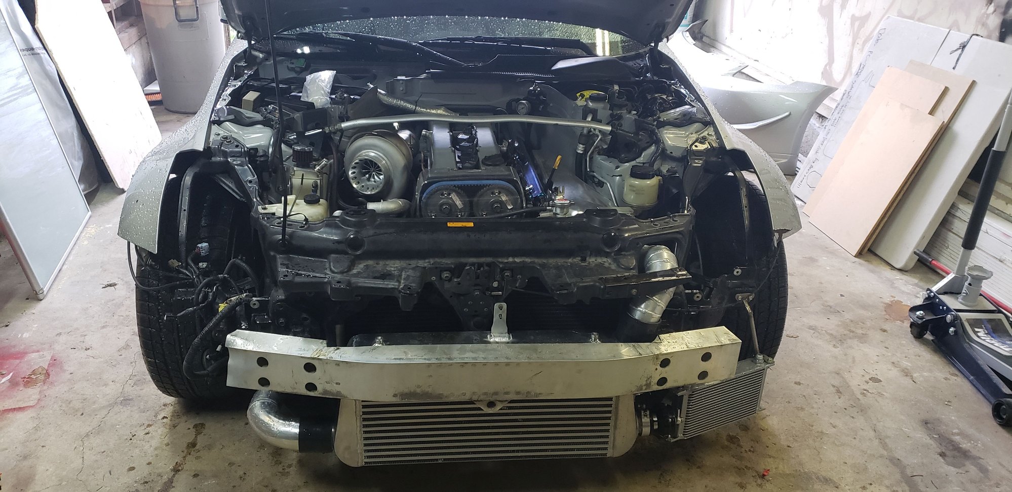

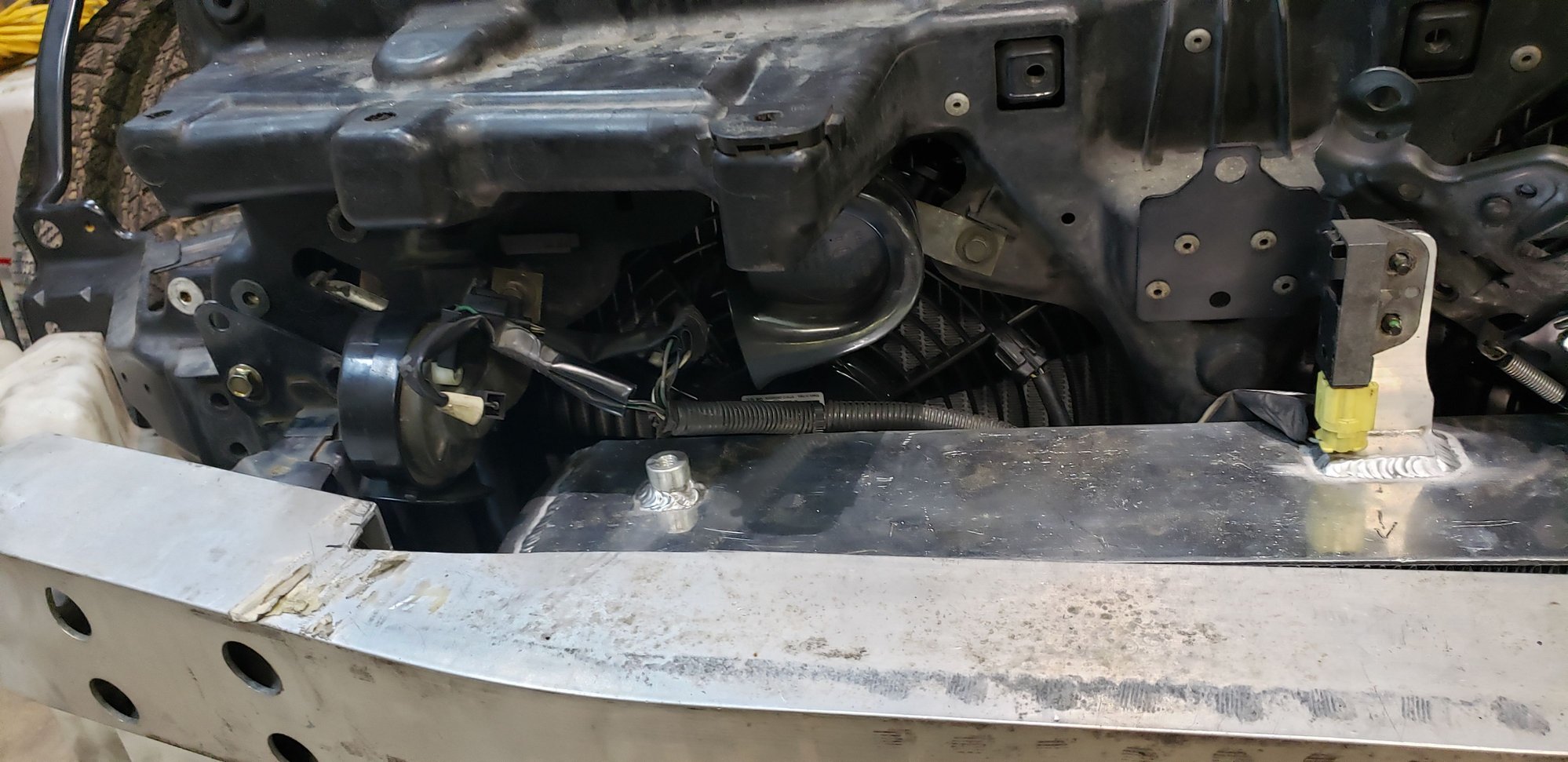

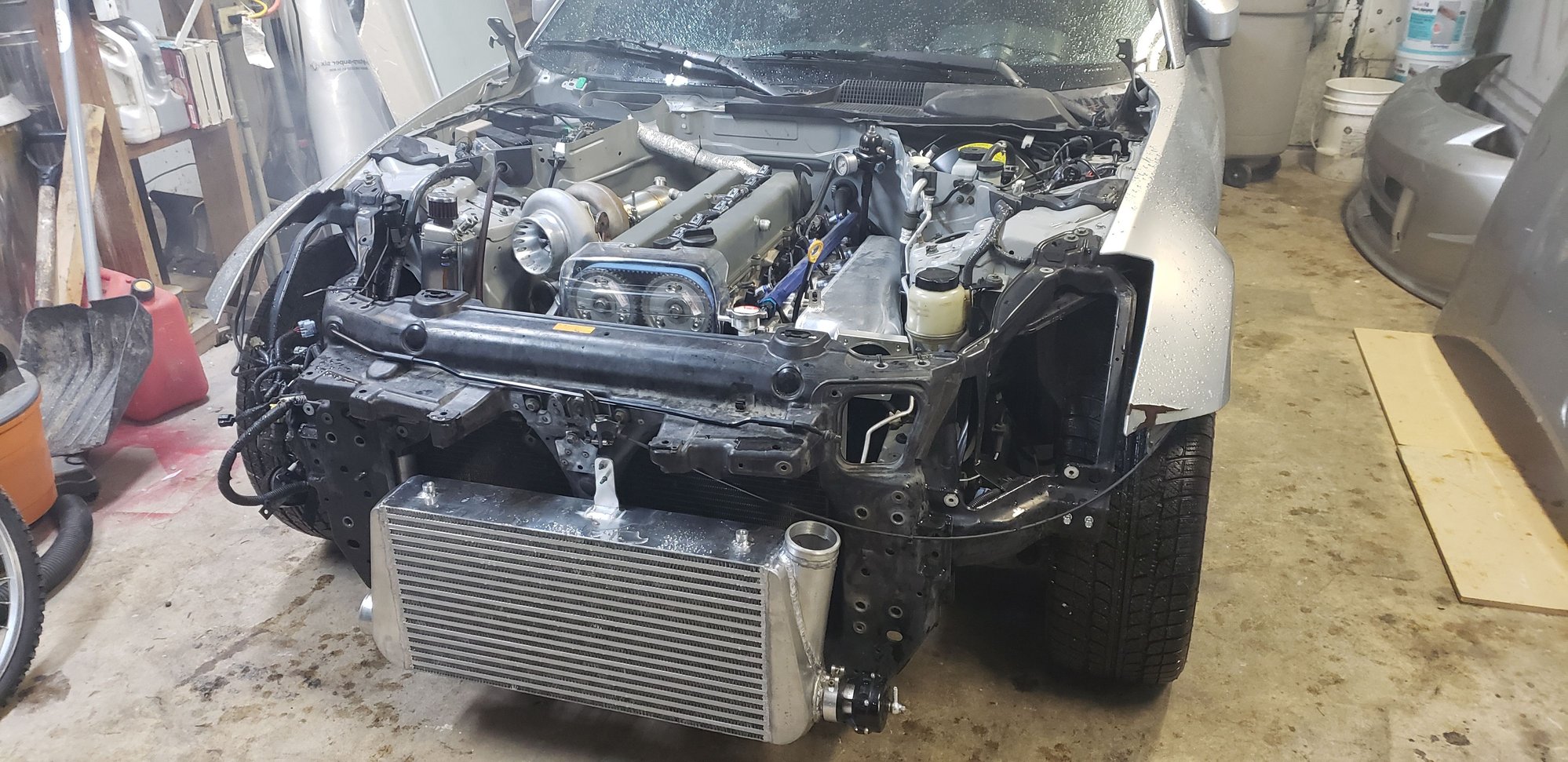

Installed new start motor connector as I ordered it with the old style and needed the new, Installed knock sensors.
I need some header wrap or to ceramic coat the exhaust manifold/housing before install, and that should finish up the exhaust side completely.
I need to install a throttle cable so i can close up all of the engine bay false firewall. not sure on what throttle cable to order....
I need to order some fans, I was thinking of ordering these [Spal 30101505 12" Straight Blade Low Profile Fan]
I have the lines for the oil cooler already(left over from fuel system) just need a few fittings to finish that up.
I need another precision waste gate as I only have 1 and im still also missing a clamp.
I need a wide band as i ordered the wrong one >.> Thinking about going multi boost/afr gauge just not sure which one.
Air filter, serp belt, I am probably ditching A/C because my compressor has the wrong connector and there isn't enough room for the fans with the AC condenser.
Looking for advice on fans and throttle cable if anyone has any input.

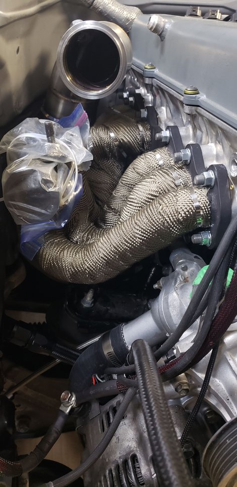

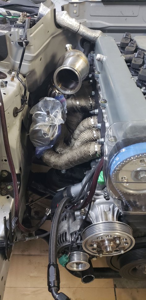

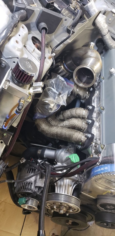

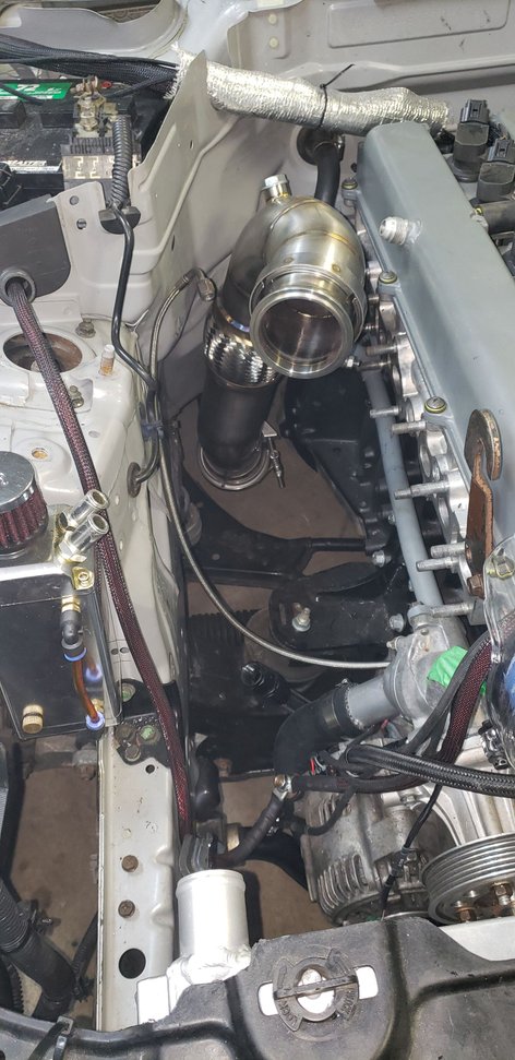

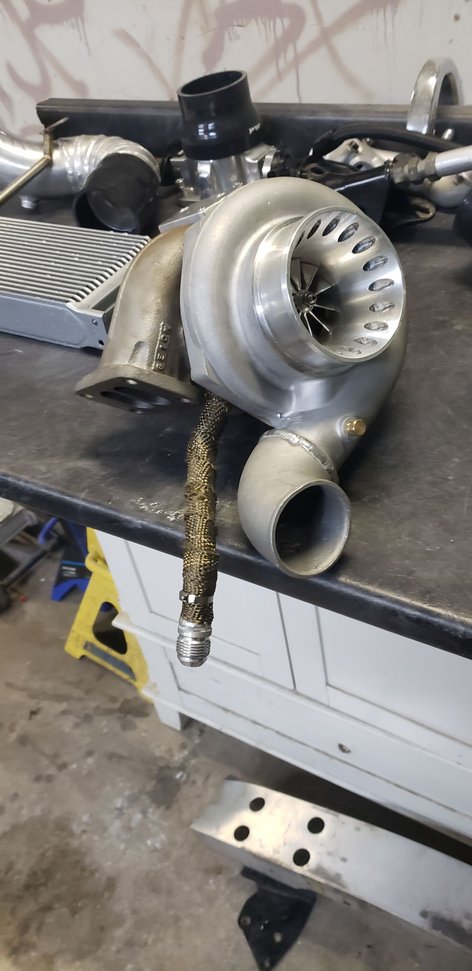

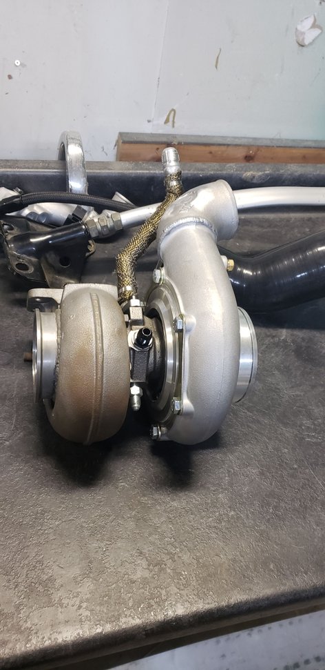

6 boost manifold ceramic painted and wrapped with titanium DE header wrap now installed.

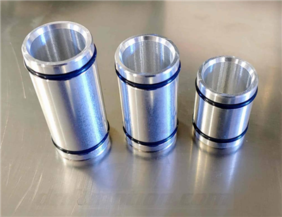

Had a couple more setbacks the waterneck pipe with the o-rings is too short for the 1.5jz had to order a custom one from driftmotion. Also went to install power steering lines and the fitting coming off the pump is at the wrong angle(goes directly into the manifold). So I ordered a new an fitting for the power steering pump. I also have to order a ac delete bracket.
This is what I ordered
Ordered the longer one the short one is 1jz medium is 2jz and the long one is for a 1.5jz

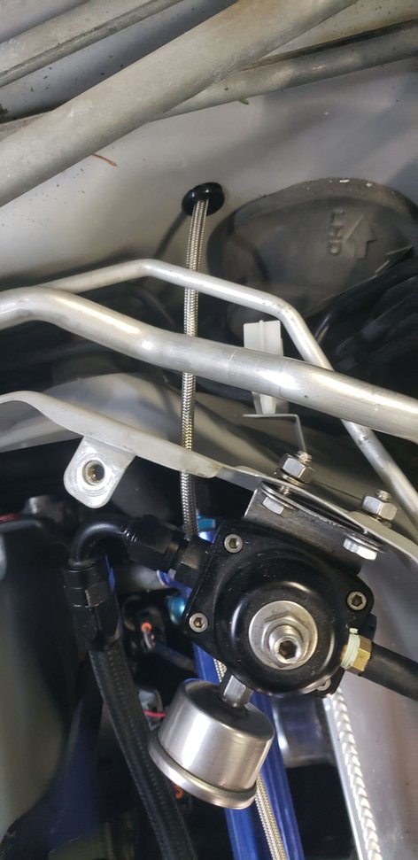

In the mean time the coolant pipe and power steering pump fitting showed up so I can start plumbing the power steering low pressure line as well as the oil cooler.

Dropped the turbo off to get coated, finished the vaccume lines on the intake side, started working on the power steering return lines.

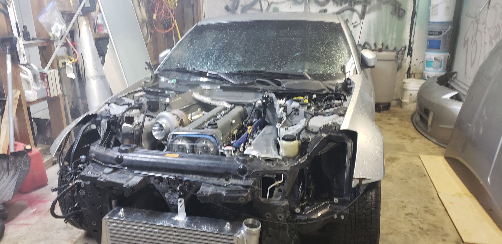

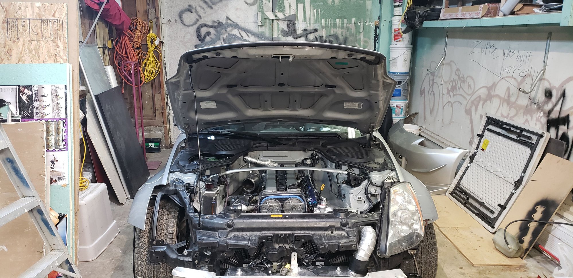

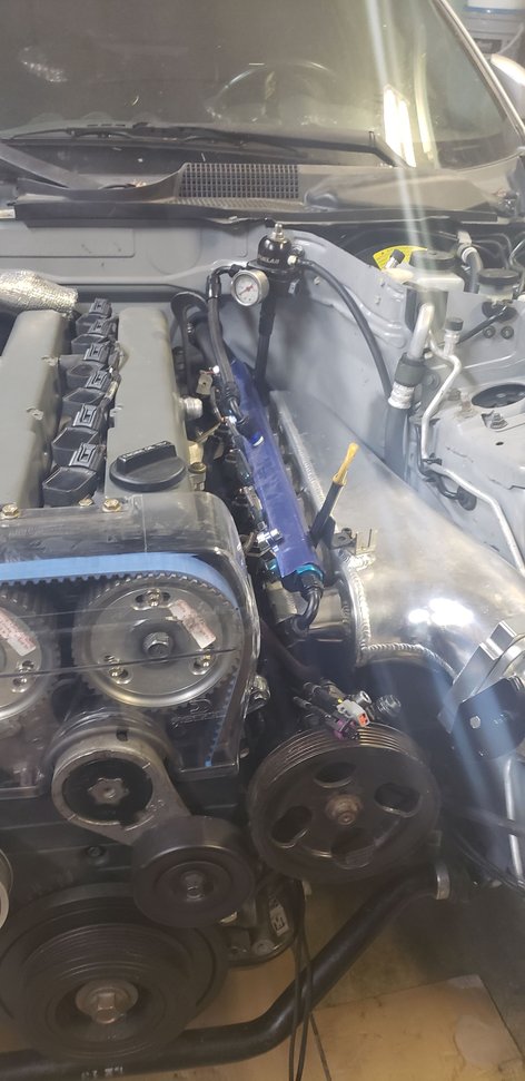

Started up the 1.5jz with open headers, it's super rich atm.

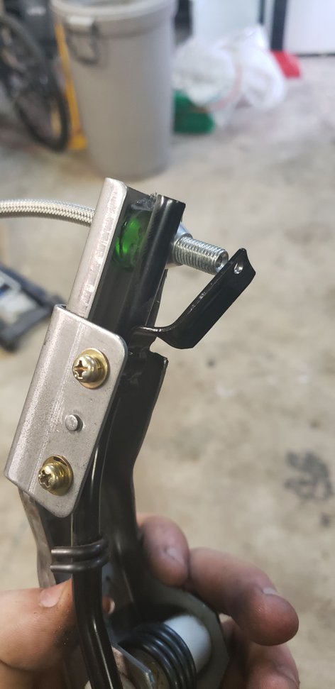

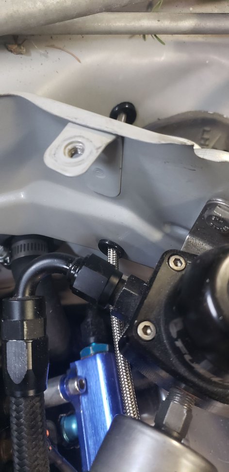

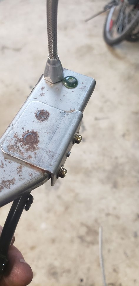

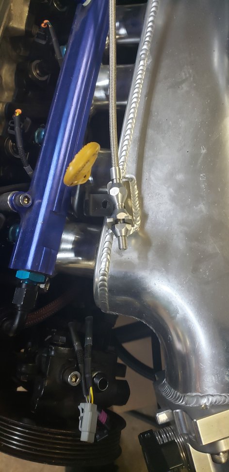

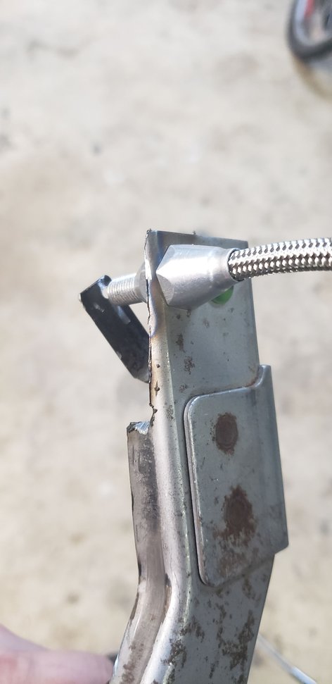

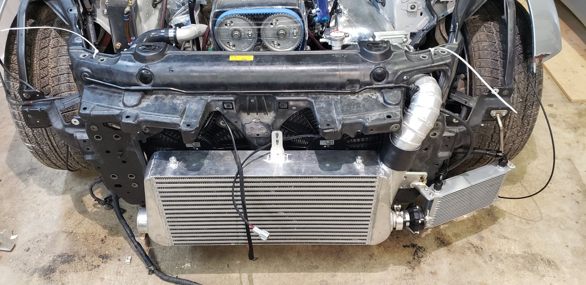

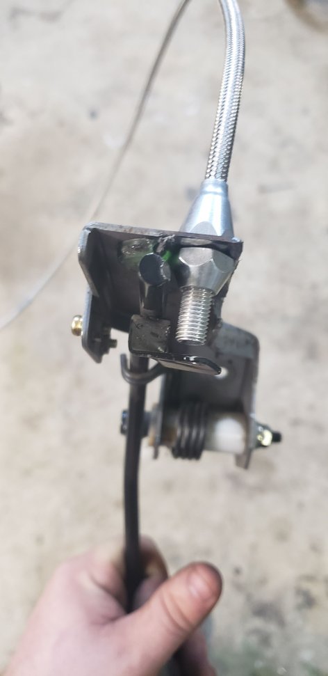

Throttle cable and spal fans installed, just waiting for the second wastegate and clamp to come in. The turbo is getting ceramic coated and should be ready Friday, I just have to finish the low pressure power steering lines, ordered the wrong fitting again... so i got my fabricator making me a pipe instead.
Installed AEM wideband gauge forgot to take pictures.
Here's a video of the fans running
