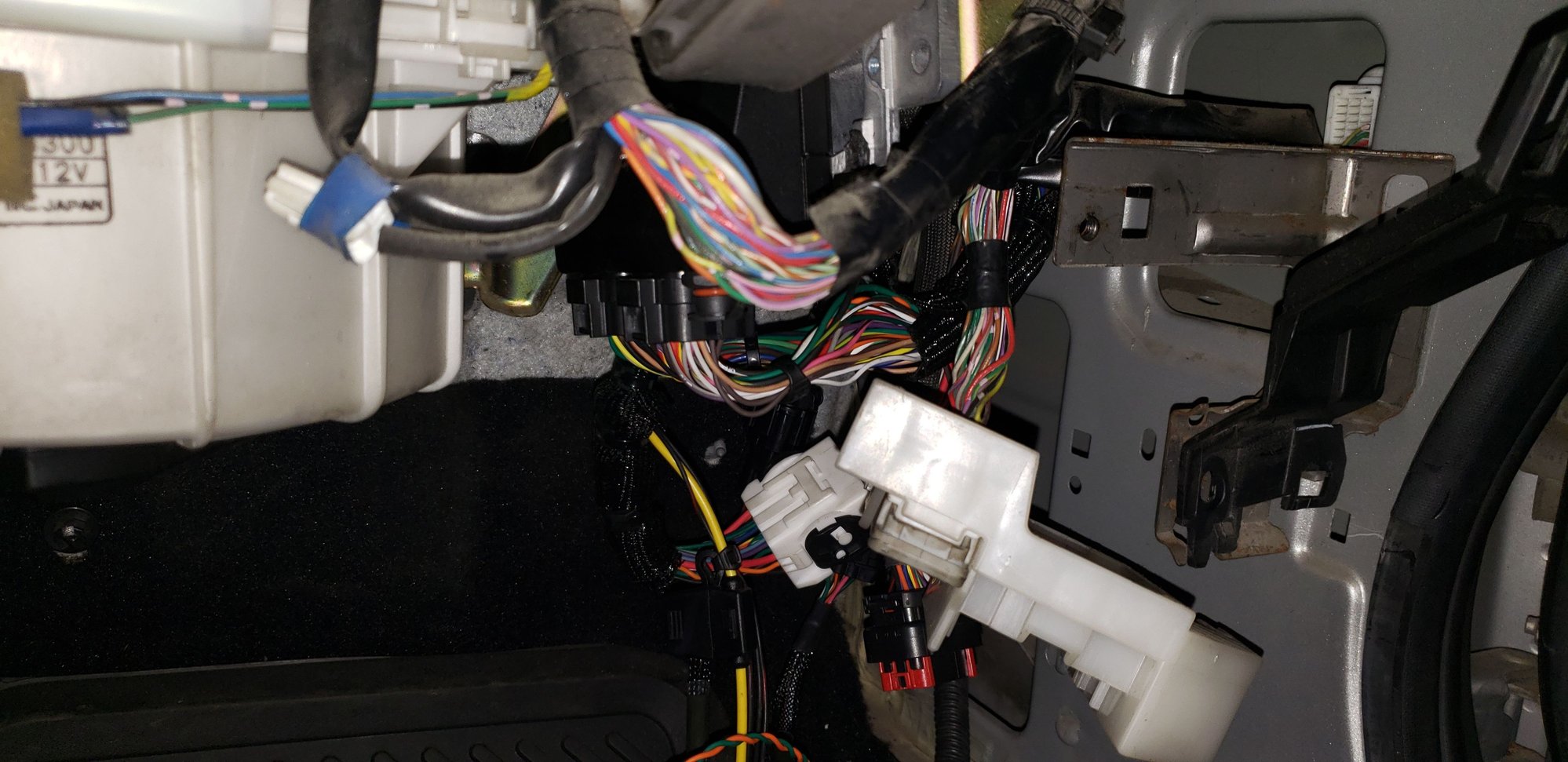

It's a mess but wiring harness is connected for the most part

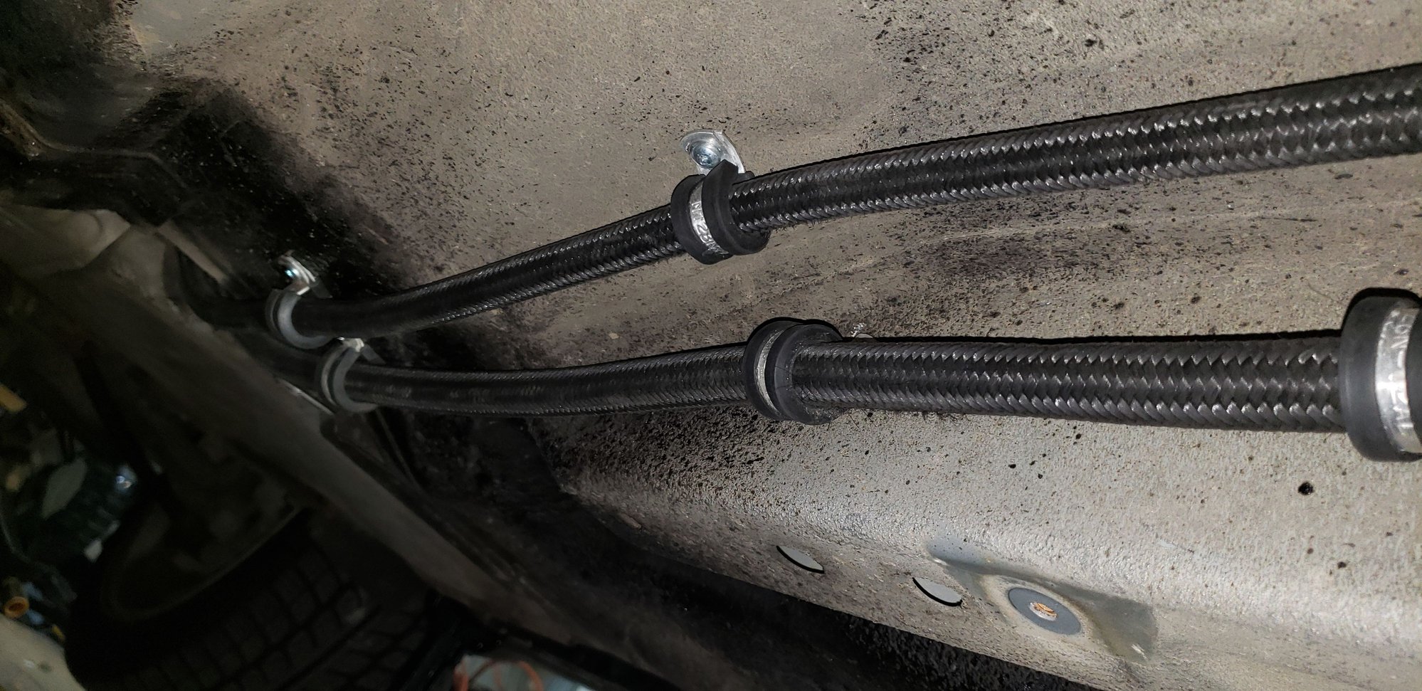

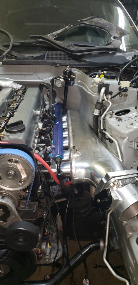

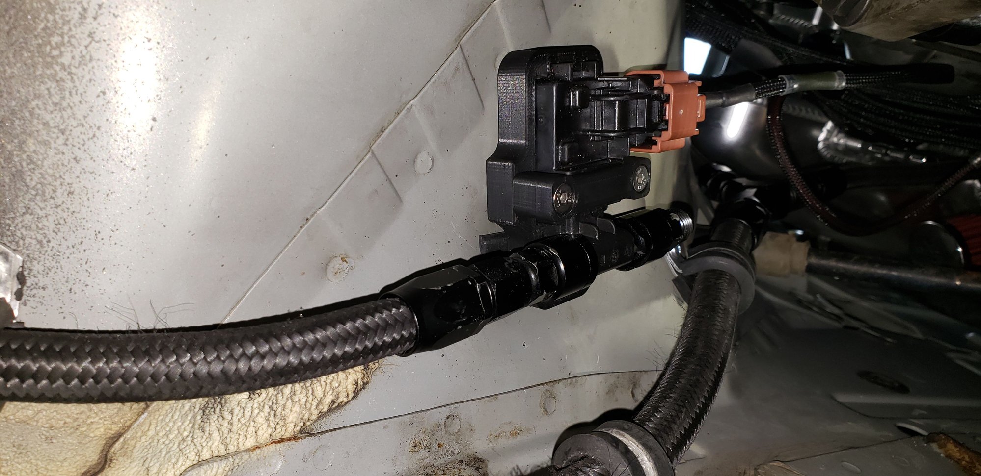

Flex fuel and lines installed, just need to run a line from the fpr to the rail and mount it.
after much thought and advice from the tuner I routed the fuel lines on the drivers side. I couldn't find a good way to run it without it being close to the exhaust.

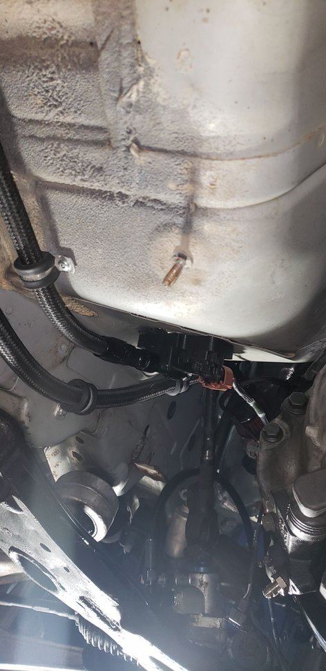

Fuel lines are done pressure regulator mounted now I just need to go over and tighten it all up and check for leaks

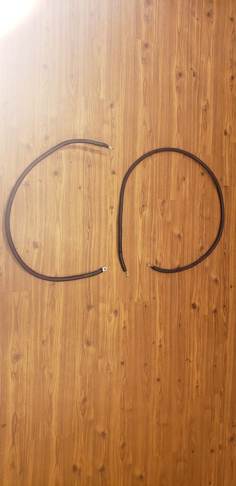

Finished up the 2 gauge power cables for the starter/alternator. Now I just need two nuts one for the alternator and the starter

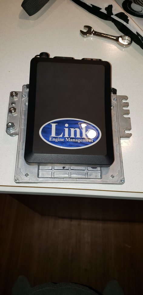

Also working on mounting the ECU(using the oem heat sink from the 350z ecu lol)

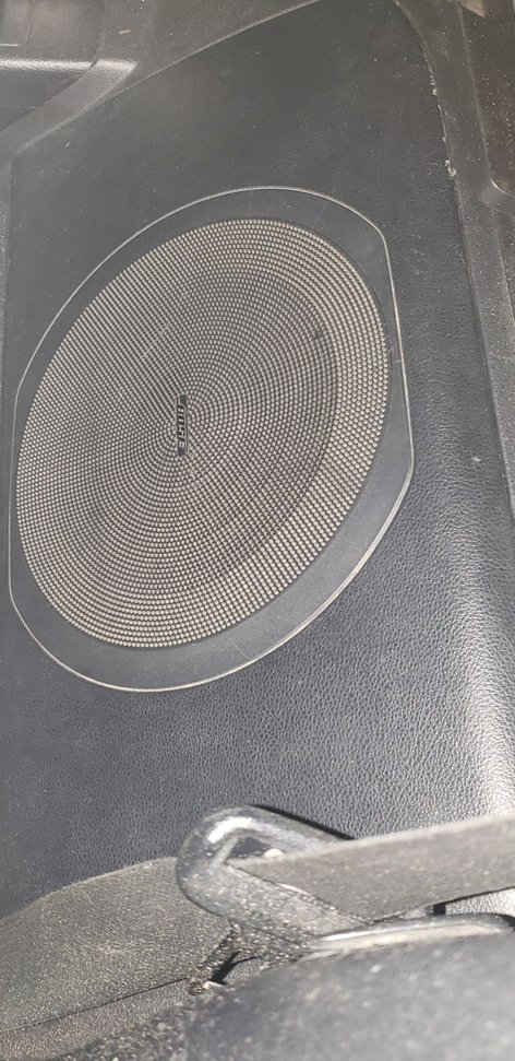

Remounted my sub

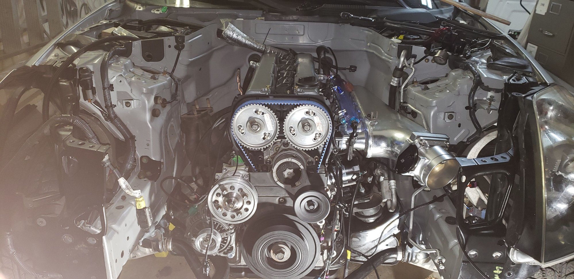

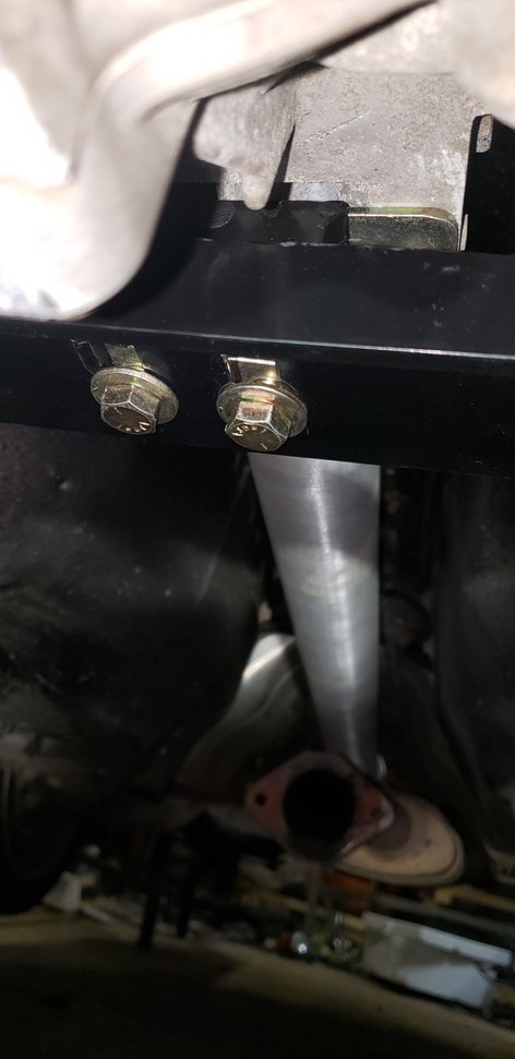

Removed the majority of the exhaust
Power cables installed
Front end partly assembled

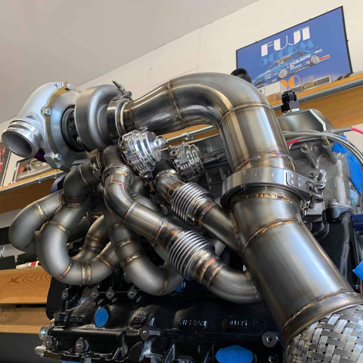

Here's a preview of some of his work ( NOT MINE )

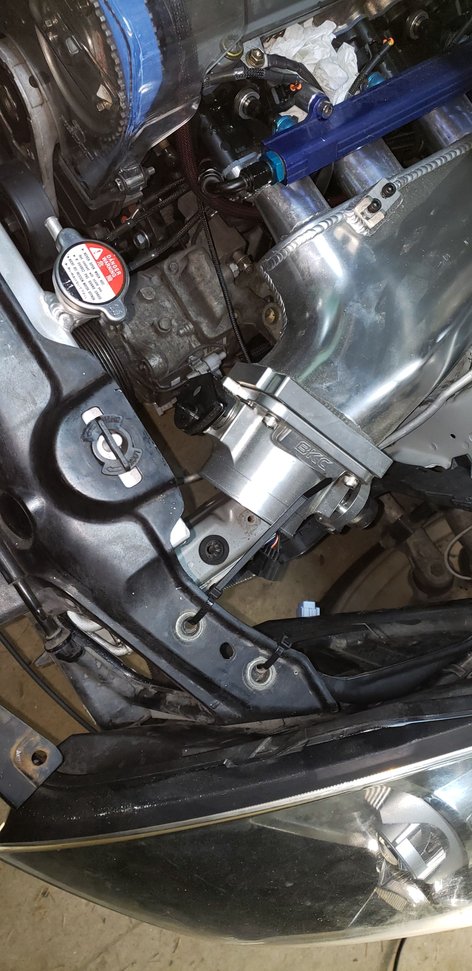

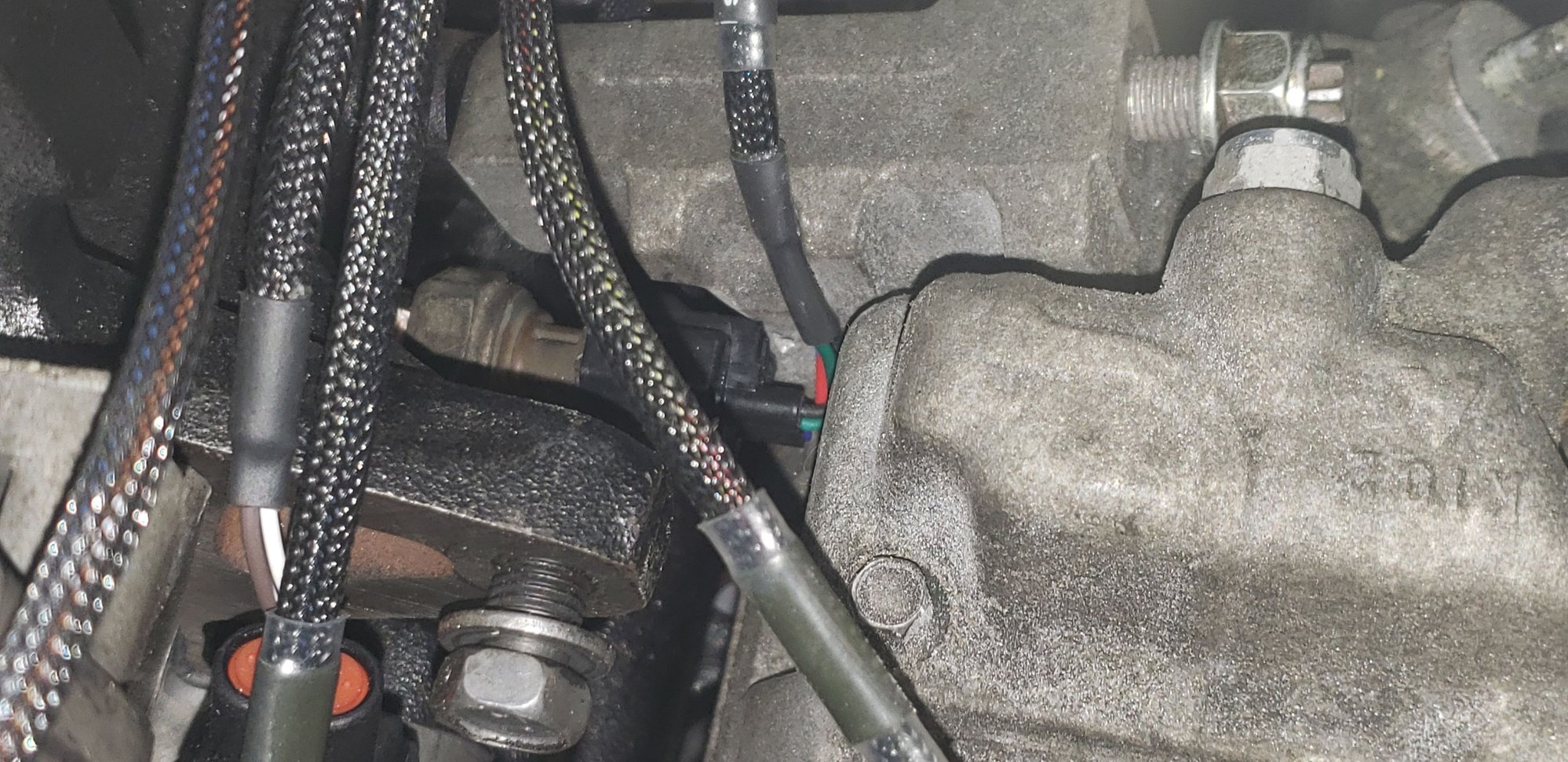

Mounted the ecu to the factory heat sink/computer base installed the factory 350z oil pressure sensor it was super tight had to grind a bit off the ac to fit it
That oil pressure sensor fitment was tight had to grind a bit off the ac compressor to get it to fit

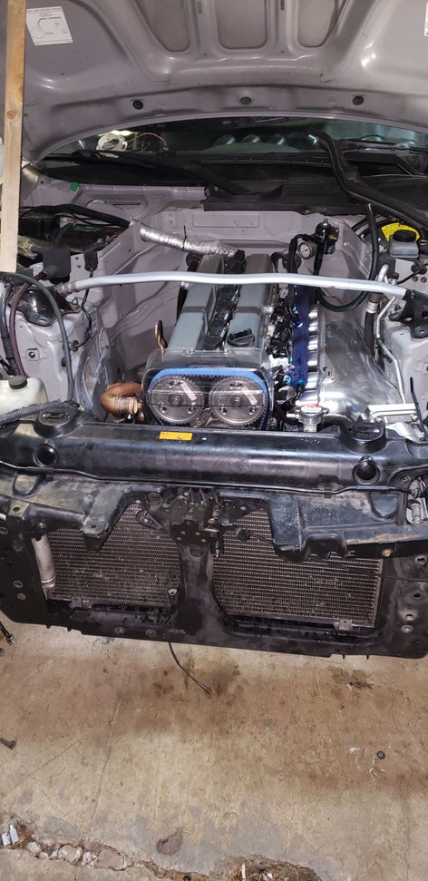

Computer mounted dash back together, interior peices is next there's not much. Gonna be sending it to the fab shop this week or next!
