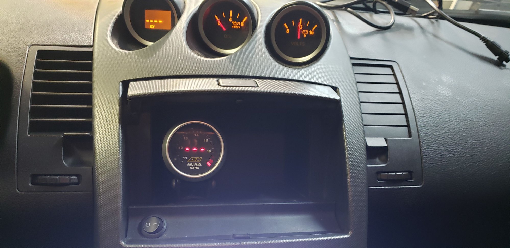

Wide band gauge installed.
I have completed the car except for power steering low pressure lines and waiting for the turbo/gates.

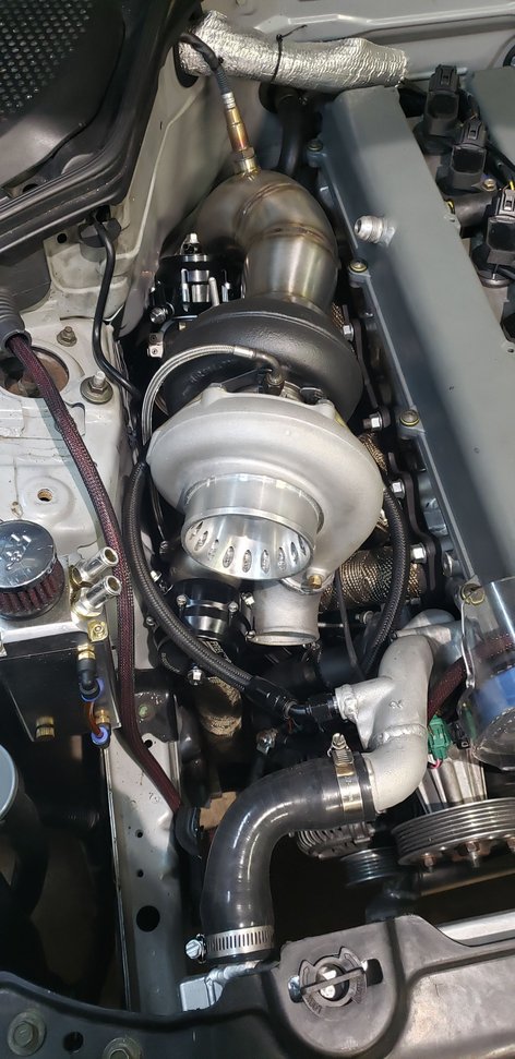

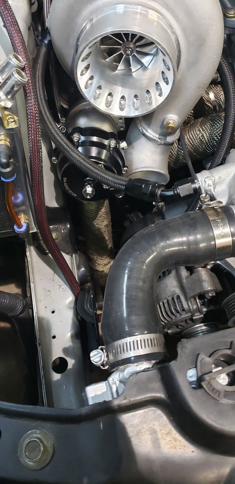

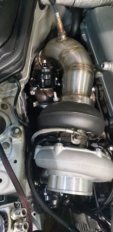

rear wastegate installed

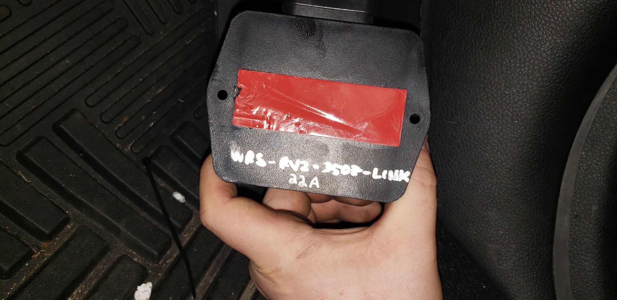

Also having an issue with my harness everything works except rpm gauge, talking with wiring specialties about it.
Wiring specialties believes it's the Dakota box

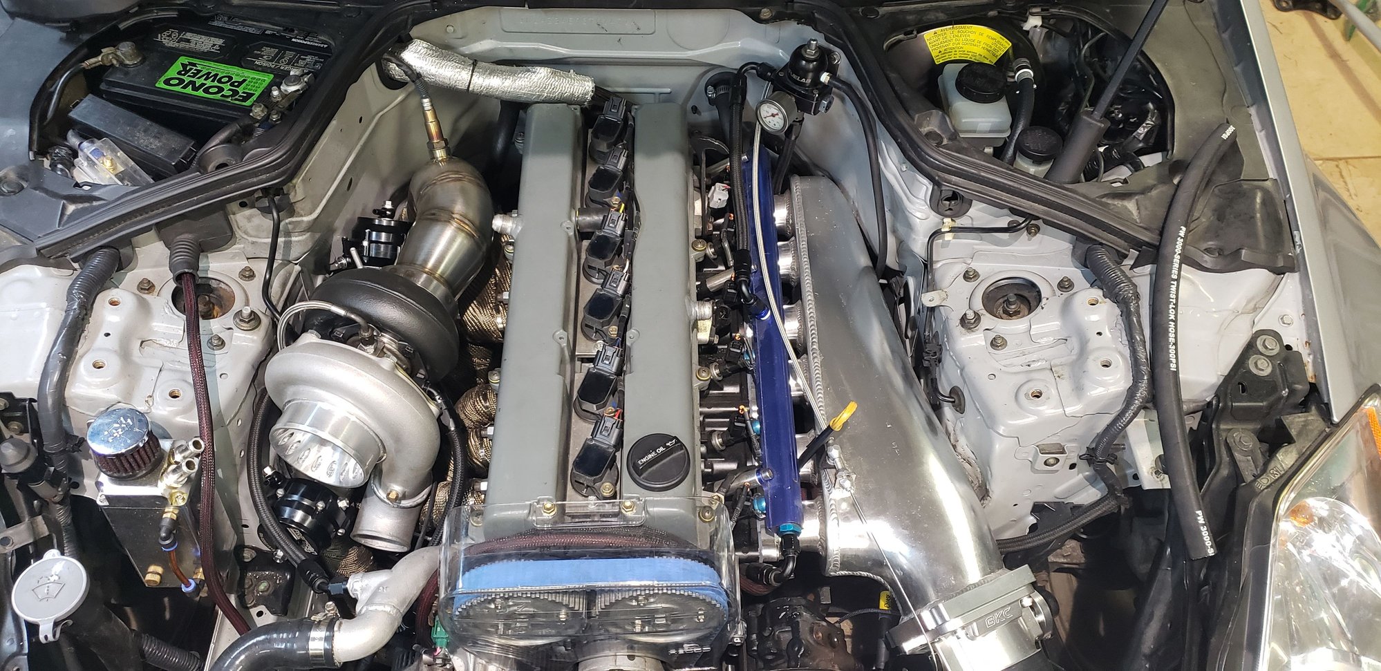

So my plan is to get the car tuned in the next 2 to 3 weeks.
I should have the turbo and wastegate tomorrow

It's the box wiring specialties sends with the harness to make the dash work with the ecu

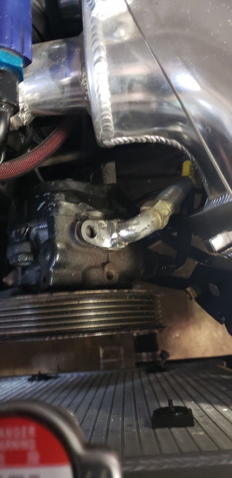

So the cars pretty much assembled / finished the swap, I had another set back - the wiring specialties box is not working correctly. The tach is not working the coolant gauge is not working and the fans are not coming on when the temp is about 88C. When i manually turn the fans on it stumbles the engine a bit, so ideally I would like the fans to work correctly as when they come on it can change the air fuel ratio of the tune etc....
I also learned how to weld with a mig welder, made the power steering fitting myself
I made this power steering fitting my friend bought a mig welder.

The fans are controlled by the CAN module(350z dash) wiring specialties set them up that way.
What i am trying to say is i don't believe those settings can be corrected when the fans are on permanently.
as of right now wiring specialties will be sending me a box to ship the wiring specialties box back for an update, hopefully that solves the issue.
When i manually turn the fans on the engine stumbles for a quick second, that's why i am assuming it's adding load and also the air fuel ratio changed.

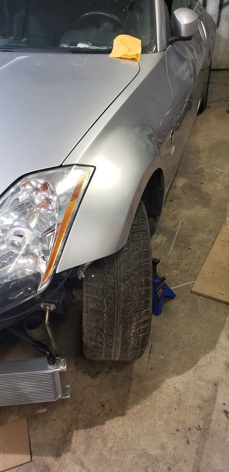

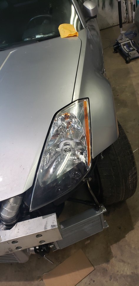

Found a new fender for 60$

I am trying to sort out an issue my wideband gauge is reading good, but the link is reading good one second then jumps to 22afr on the link outta no where happens every 2 or 3 seconds...I'm hoping it's just the analog voltage wire if not I will have to buy a new interface from aem.
