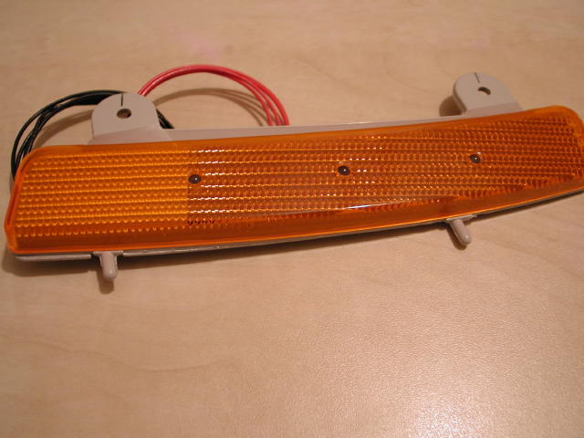

Just got my set in the mail yesterday. Thanks Yuichi! Ordered Tue, rec. Thu! Now if I only had a car to put them on. They look very nice and the mod is clean. They came with detailed photo instructions on removing the bumper and splicing them into the city lights. There are three small holes drilled in the face of the reflector at the points of the molded "Z dots" where the LEDs are placed. They are really not noticable from a normal viewing distance and appear very close to stock when not lit. The LEDs are clear and light up amber. Looks like the reason they did this instead of embedding the LEDs within the reflector is to get the three pinpoint dots of light when lit, otherwise, the light would be more diffuse and light the whole reflector up. All that protrudes from the back of the stock assembly are the two wires that that splice into the city lights and a couple of vampire clips. All cross-wiring for the LEDs and any resistors (if there are any) are concealed within the assembly. Overall, I'm impressed and very happy with the purchase. I might splice them in on my current car just to see them lit.

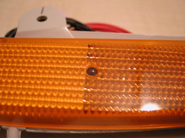

Default A close-up of one of the LEDs:
pic.

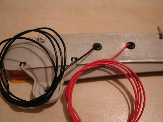

Here is the back:

Is it possible to use the original sidemarker so there will be no screw holes there?

Not quite sure what you're talking about. These are original OEM sidemarkers. If you are referring to the set-up shown here except without the LEDs showing through the surface of the reflector, you probably can, but it may not light up with the three pinpoint dots of light; it may light the whole reflector with a more diffuse light. See the link to Clearcorners.com for something like this. The goal of StrictlyZ.com was to create something more like the lights on the original concept car and maintain the 3 "Z dot" pattern that runs throughout the car. As I stated earlier, the LEDs are not really that apparent when not lit from a normal viewing distance.

Oh I see, so those are not screw holes but LED light bulbs

Right, there are holes there, but they are filled by the LEDs which are clear. They really don't show as much as the pictures imply.

In your opinion, will the light bulb easily damaged since they are exposed ?

I don't think so. Only the very tip of the LED is exposed; they are mounted flush to the surface of the reflector. LEDs aren't like regular light bulbs either; they are solid plastic molder around a diode, so even if a rock or something happened to smack into one, it might just scuff up the exposed tip of it and not effect the operation of it. If one was worried about it, it would be easy to put a small, fitted piece of the 3M film over the reflector for extra protection, though I really don't think it's necessary; the reflector is faces to the side and isn't in the direct path of any flying debris.
