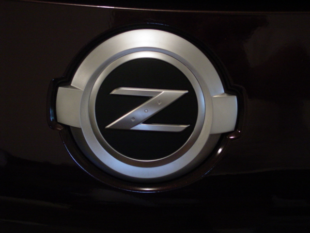

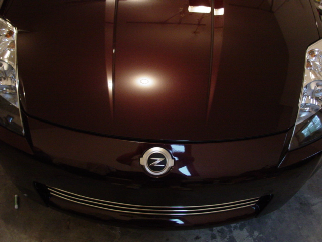

Old Jun 7, 2003 | 03:43 PM
Dr Bonz's Avatar
Dr Bonz
Charter Member #19
Posts: 6,490
From: Zainoland
I second that emotion!
I used a thin putty knife padded with soft athletic tape and pried (after heating) inside the Nissan emblem as opposed to on the periphery. I figured if I scratched anything there, the new Z emblem would cover it.
I tried the fishing line and almost cut my fingers off with no luck.
The grayish adhesive left behind came off really easily after I heated it up as well. It then sort of rolled off with simple finger pressure. I then wiped with a cloth and popped in the new emblem:

Old Jun 7, 2003 | 03:44 PM
Dr Bonz's Avatar
Dr Bonz
Charter Member #19
Posts: 6,490
From: Zainoland
Close up:

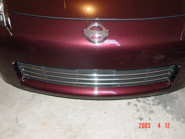

Originally posted by Dr Bonz
Close up:
Bonz,
What kind of front grill do you have on your car, and where did you get it?
Old Jun 8, 2003 | 08:34 PM
joust75's Avatar
joust75
Posts: 5,096
From: Sesame Street
Originally posted by alex30327
Bonz,
Ha! It looks pretty good dont it Al boy? It is a $12 mod. It is chrome door guard trim, that crafty owners have put on their grill! Many have done it! Do a search and you can find loads of pictures and advice for install!
Old Jun 9, 2003 | 02:57 AM
Dr Bonz's Avatar
Dr Bonz
Charter Member #19
Posts: 6,490
From: Zainoland
Actually mine was about 8 bucks. You buy that flexible "chrome" door edge guard at Auto Zone and peel off the adhesive backing and stick it on after you cut it to length.
