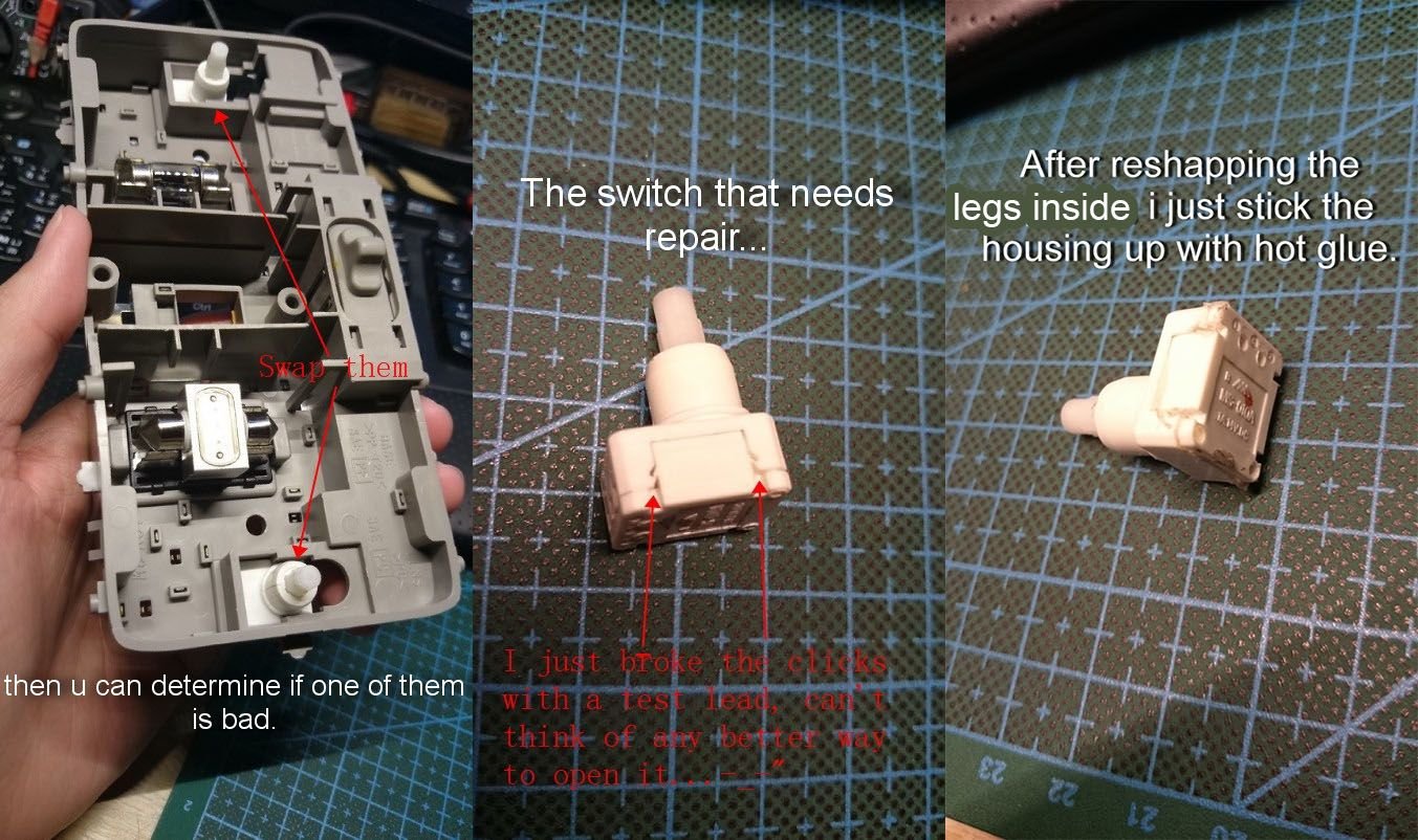

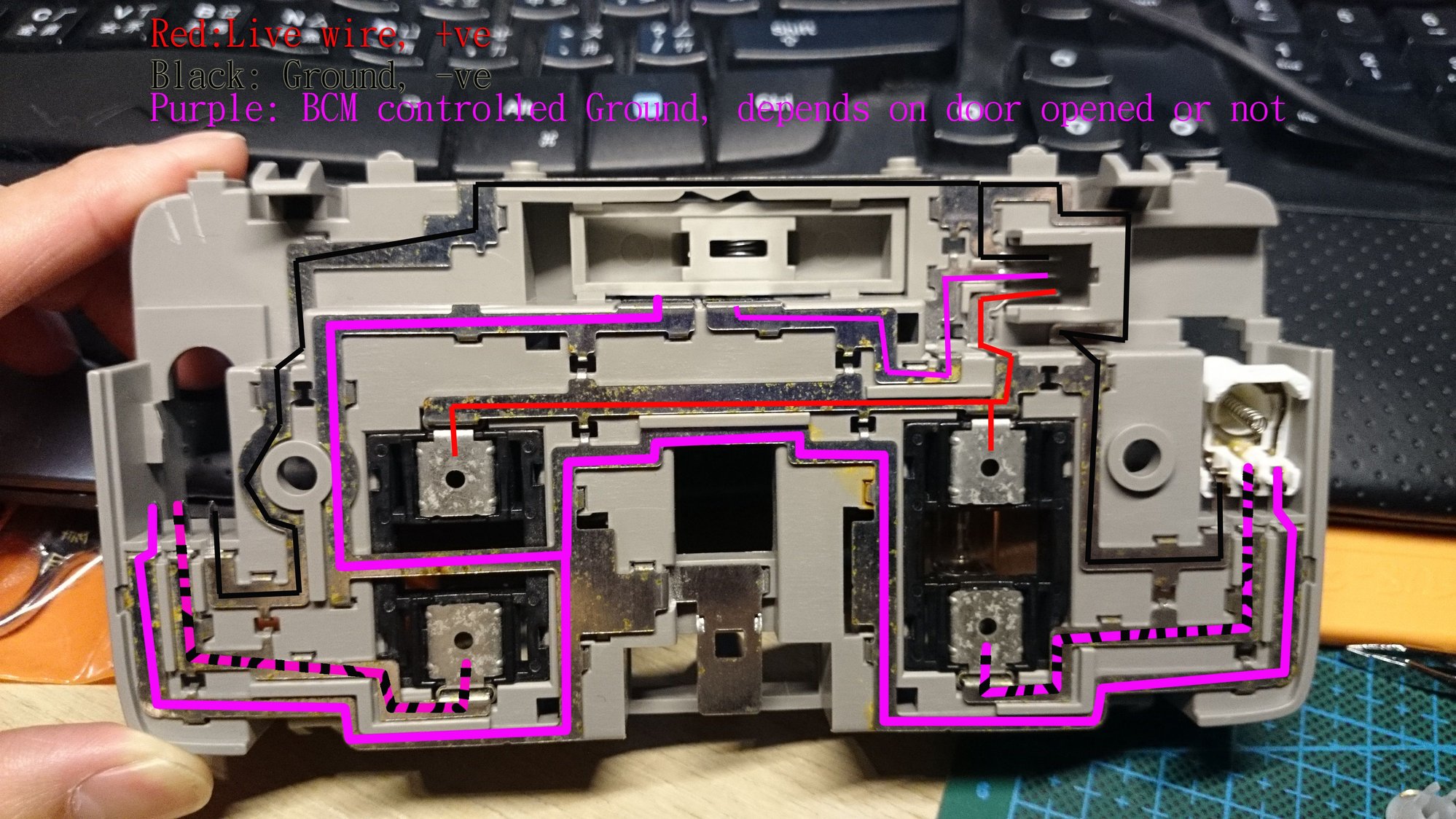

Hi, dynomike6, it was the white spring switch that matter. Check it out simply by swapping the left and right switch if it works then thats the problem. Like u, i tried to put LED blub in it but the barrel is a bigger metal housing...... then it shorted! Two subsequences:
1st is the fuse that actually blown , u might find it looks good visually but like my one just failed continuty test with a multimeter (it won't beeps for the test>> broken).
The 2nd is the white switch, u won't understand what happen until u open it up~

If the switch is the culprit, this is how I repaired it for your reference.
