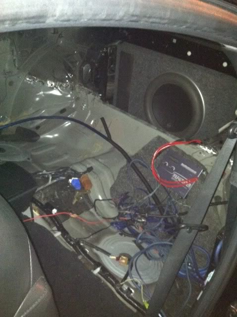

Jackson!!!! I did it bro!!! Lol
Thank you for all your help
Pic
The rest of the pics are in my build thread
https://my350z.com/forum/audio-and-v...dio-build.html
Thank ALOT bro!!! I'm FKN stoked right now!!! Lol almost to my goal!!
