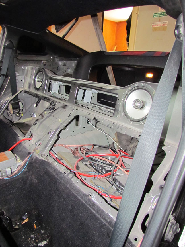

Progress report: taken advantage of these snow days, stayin away from my office, trying to work on the z
for those who think im not following through with this:
let me just say that was FAR FAR from easy to do. A lot of drilling, a lot of grinding/cutting and even had to use and hand saw in 1 or 2 spots. and im not even quite finished. still have to drill the front piece out but i broke my spot-weld drill bit, and it is REALLy close to gas tank. (if i empty it, it will only be filled with fumes, advice?)
as far as the g35 backseat goes (see below) i will be extremely surprised if it doesn't bolt in directly with no modification. not sure about the back, im really only concerned with the bottom pad

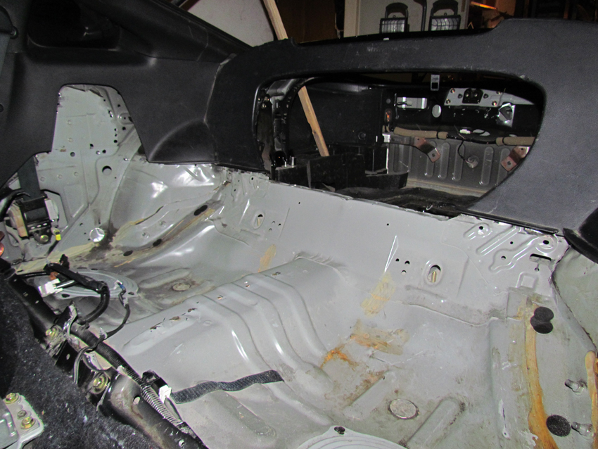

Do you have a pic of how it was when all you had done was remove the plastic trim?
Old Jan 21, 2011 | 12:29 PM
  #59
jruocco's Avatar
jruocco
Joined: Nov 2006
Posts: 1,514
From: Fort Lauderdale, Florida
awesome project! i'm in for results.
Old Jan 21, 2011 | 12:35 PM
  #60
Jackson0927's Avatar
Jackson0927
Joined: Jan 2010
Posts: 608
From: Kansas city
yes i do
