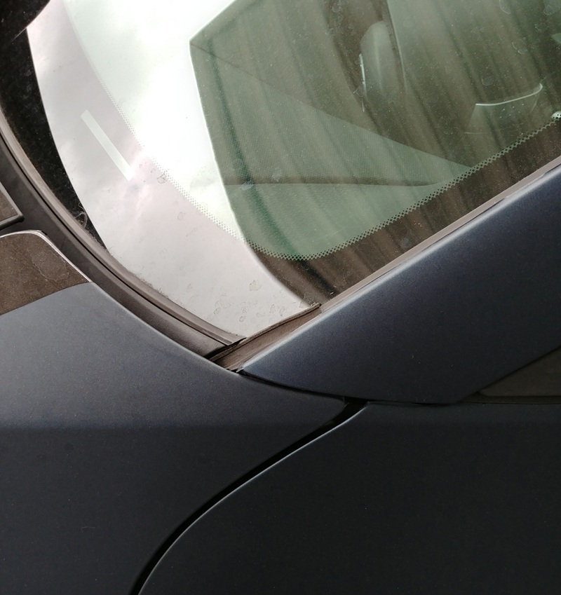

Lightbulb A-pillar rubber trim possible solution
Hi guys,
as the years go by rubber trim deteriorates. Used to a BMW where you could get mostly all the parts separately and relatively cheap I am not amused at all seeing Nissan never adopted this logic. A-pillar rubber trim comes only with pillar plastic building up a price tag of 500USD per piece/side and parts are not even painted. I mean Nissan what the hell were you thinking?! Anyhow, this rubber usually deteriorates at the bottom and top of the windscreen where they used different type of rubber and glued in together.
(this photo is borrowed from internet, not actually my car)
Soft and brittle rubber eventually starts to crunch away. Catch it soon enough and you just might fix it. From my motorcycling experience I remember we had to solve a lot of riding boots issues. Boot's sole falling off, leather falling off, boots cracking and so on. 99% of the time this problem was solved using an amazing product called ShoeGoo. It is quite messy, but used with soapy water you can easily shape it. So, having some rubber left I believe you can add this ShoeGoo on top and under it. If you have some rubber left to adhere to.
Just an idea. I haven't tried it but ShoeGoo would be the only product that would resemble rubber properties. I haven't seen any products called "liquid rubber" or similar so this is the closest.
Again I haven't tried it yet. But how would I do it? I would either take A-pillar plastic off. I would mask it well. After that I would place a piece of silicon or soap covered credit card underneath the crunching rubber part. Than apply black ShoeGoo and shape it in that part only. Start from underneath the rubber, push ShoeGoo up through the cracks and flatten it on top.
Right now I have many other detailing areas on the car and my rubber seems to hold up. But eventually as the years go by I'll have to tackle this issue also. And coughing up well over 1.000 USD for a pair of plastic pillars and painting them just doesn't seem sensible to me. So if anyone will try this, share your results and pictures. If this method will prove successful many people will be able to spend 1.000 USD elsewhere or even on other parts rather than a stupid seals which should be sold separately in the first place.
