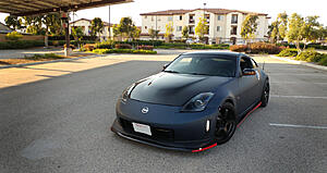

1. Current, Matte Mariana Blue.

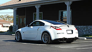

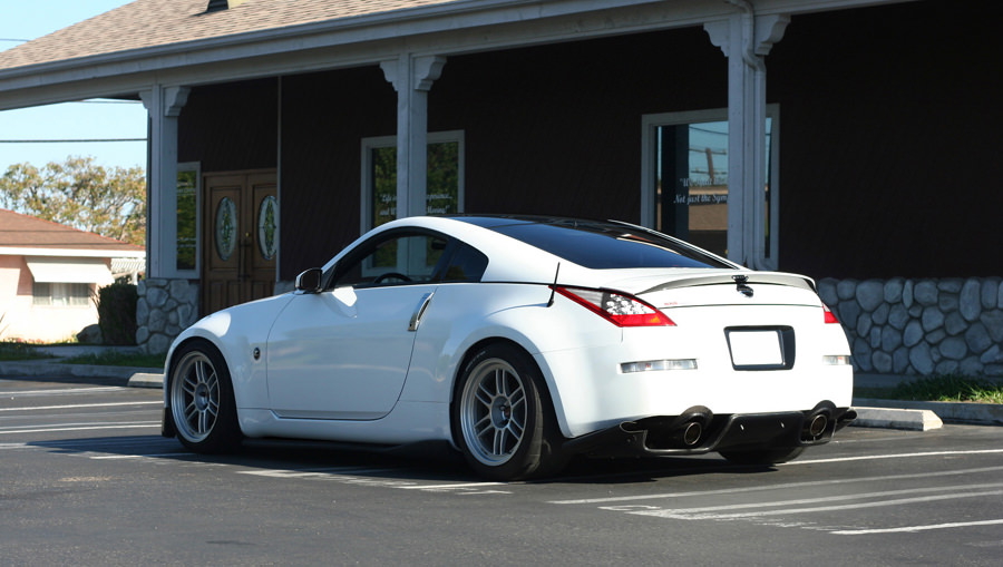

2. Gloss Arctic White.
3. I also did it in a Gloss Pearl White, didn't look any different in pics.

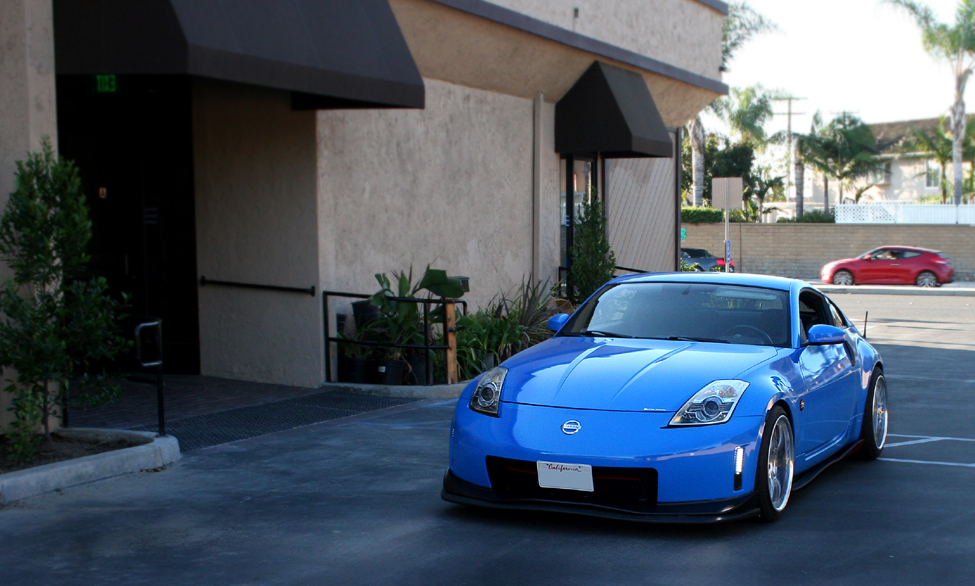

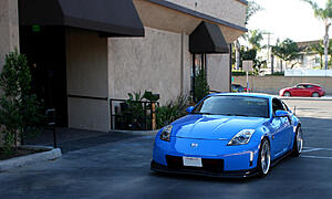

4. Gloss Intense Blue.

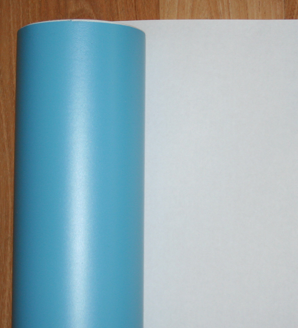

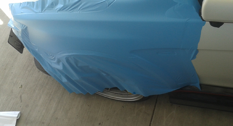

5. I had it in wrapped in Matte Balloon Blue but never took pics of it. Only had it on for a week and didn't like it. Wrapped my Evo X in this color as well.

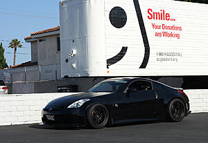

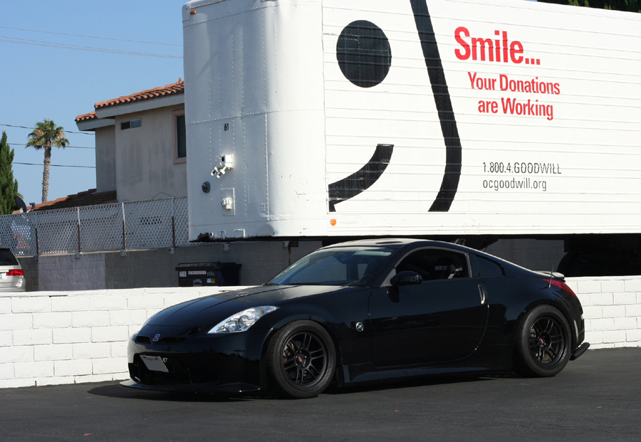

In the nude

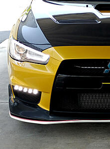

Will probably wrap it Gloss Hornet Pearl Yellow to match my Evo X next.
When I first "met" Mistuh Sparco, this was the color that put his car on the "Mic Top Ten List" (surely you know of this list, yes? ) Had no clue it was vinyl. Thought it was painted Monterey Blue (my favorite 370Z color, next to white like mine was). I still love this "version". My car needs paint on certain areas. Maybe I'll finally try my hand at vinyl..... (So I've been saying for 5 years)

I'll admit that blue is gorgeous but shine of paint and vinyl are different enough that you can tell in person whether it's paint or wrap. Bang for buck is definitely in the ballpark of wrap, but if you like the crystal like appearance of paint, wrap falls short there.

To get nearly a perfect paint sheen, I will clear bra over the entire car after wrap. That's mostly due to my OCD. Some vinyls are multi-layered for example Arlon uses a base, color, and clear, such as the vinyl on my Evo. It is pretty damn high gloss. Some 3M vinyl has a clear layer but for the most part uses a "single stage" vinyl like the Gloss Intense Blue. Many installers will also use too much heat and warps the vinyl so its somewhat less glossy. I rarely need to apply heat when I wrap, only when there is extreme curvature. When an installer clearly understands how the vinyl behaves, heat is almost never needed. Only the crap installers use a torch, intermediately skilled installers will use very little to no heat at all, its actually easier to wrap without heat.
that looks so good!
I need to do my hood. My OEM paint / clear coat is showing its age so it's time to do something about it
