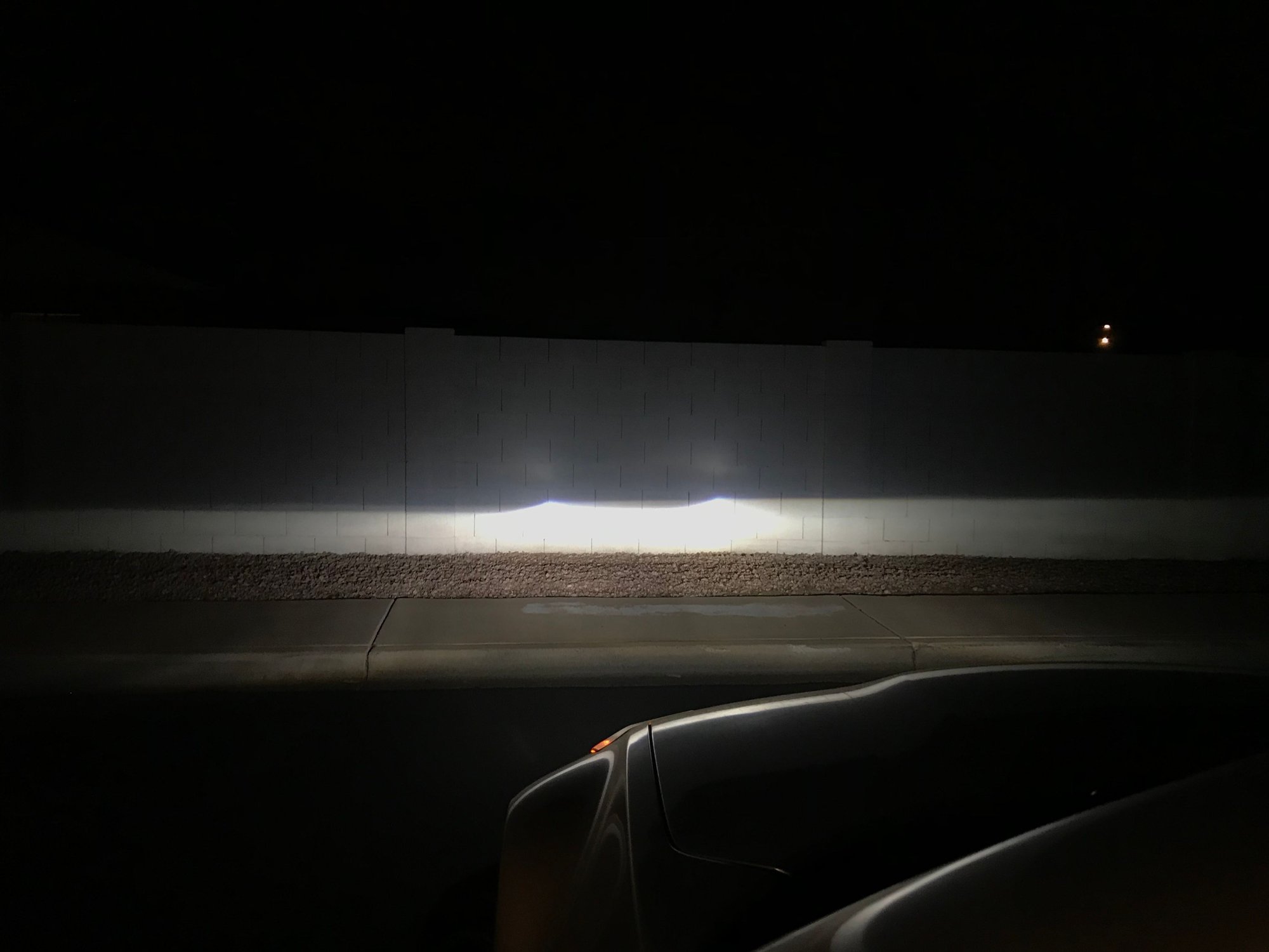

I recently had the STI-R clear lens installed in the Z and while I'm happy with the color band, the cutoff doesn't seem to be as sharp as it should be. Does it seem like the case or are the photos posted by others edited to make their cutoffs seem much sharper? They always seem to have a single clean and crisp cutoff line with no glare above.
Is it a case of improper adjustment or are the bulbs not seated properly or something else...or am I just imagining things?
Old Nov 15, 2019 | 07:20 AM
813_350Z's Avatar
813_350Z
Joined: Dec 2013
Posts: 1,051
Likes: 318
From: West Coast, Florida
Look good to me.
Old Nov 15, 2019 | 01:34 PM
Freise's Avatar
Freise
Joined: Jan 2015
Posts: 152
Likes: 32
From: Pennsylvania
Overall looks fine. You can "fine tune" with spacers between the [STI-R] lens and the lens housing, even just a mm can make a difference in clarity, but it's marginal at best and up to you if that's worth the work of separating them to get to.
Old Nov 15, 2019 | 06:16 PM
DarkZ03's Avatar
DarkZ03
Posts: 2,814
Likes: 549
From: Des Plaines
Looks like my stock lights.

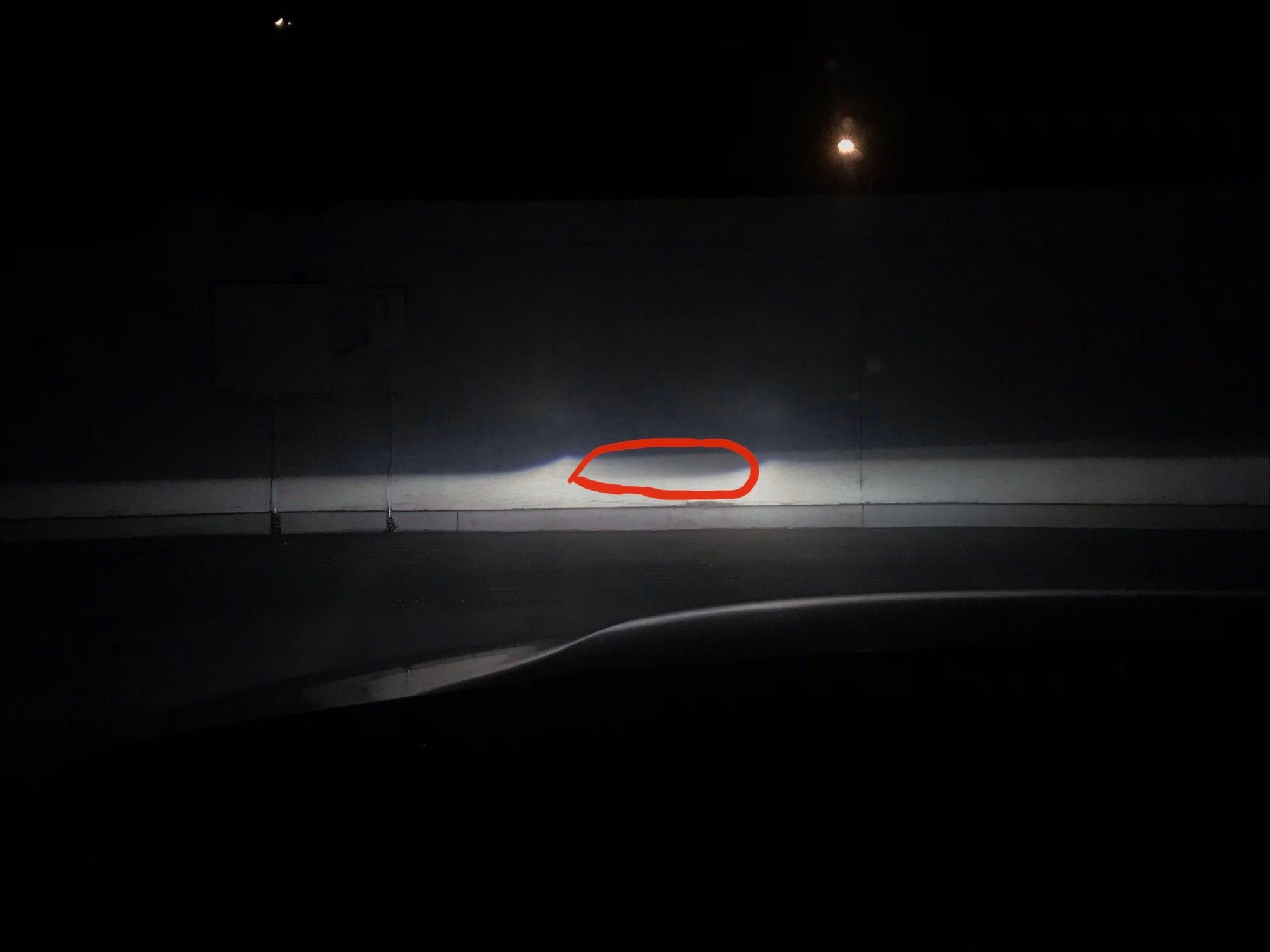

Thanks for the replies, I appreciate it. I guess the part I would want to see changed the most is simply the space between the peaks - to sort of "close the gap" roughly in this area:
I've seen photos that others have posted and it just looks so much more dramatic, like this one:
Is it just heavy editing?
Old Nov 16, 2019 | 07:45 AM
travlee's Avatar
travlee
Master
Joined: Jul 2011
Posts: 49,725
Likes: 9,296
To me it appears your right light is a touch lower than the left
Old Nov 16, 2019 | 08:04 AM
MicVelo's Avatar
350Z/370Z Tech Moderator
Joined: Oct 2014
Posts: 10,316
Likes: 3,380
From: Northern California
Unedited. This is how properly adjusted beam pattern should appear - note what looks like a single "peak". (The other peak is obscured by the light overlap.) Your light height and projector spread is off. The left hand beam, after height correction, should have enough overlap to cut the RH peak down so its not so obvious. However, if there's still a peak after the height adjustment, the next fine tune adjustment requires opening the lenses to correct/align the projector spread (side to side).
That all said, however, in functional day to day use, the projector spread issue is not nearly as critical as the height adjustment so recommend you do that - and be done with it.
Old Nov 16, 2019 | 08:25 AM
mr. sparco's Avatar
mr. sparco
Posts: 7,090
Likes: 460
From: Sunny Beaches
@ OP- Do you have OEM bulbs? Your color looks closer to 6k. Mine looks spot on to the other picture you posted. The beam is laser sharp and the cutoff is exact with a slight blue hue at the cutoff.

Old Nov 17, 2019 | 01:18 AM
LevatZ's Avatar
LevatZ
Joined: Aug 2016
Posts: 4
From: Phoenix
Thanks for the response again, I appreciate it. So is the left beam too high or too low? Or does the right one need to be adjusted also? Which way should I adjust the height?
No, they're not stock...they're the 5500K Morimoto bulbs. They were highly rated online and I wanted something a bit cooler in light temp than the 4300K OEM bulbs. The person that owned the car before me had something ridiculous like 8000K installed so I never saw what the stock output on the 06+ Z looks like. Do you think going with the OEM bulbs will help? Because I'd certainly trade the color difference for that really crisp cutoff and the even distribution of light at the top.
Old Nov 17, 2019 | 08:52 AM
mr. sparco's Avatar
mr. sparco
Posts: 7,090
Likes: 460
From: Sunny Beaches
Morimoto is rebranded made in China parts with slightly better quality control. TRS does offer pretty good customer service, I would reach out to them in regards to your concerns, though you really can't beat OEM.

Old Nov 25, 2019 | 11:57 PM
LevatZ's Avatar
LevatZ
Joined: Aug 2016
Posts: 4
From: Phoenix
For anyone interested, I adjusted the right beam a bit and it definitely looks better now. Thanks again for all the replies.
