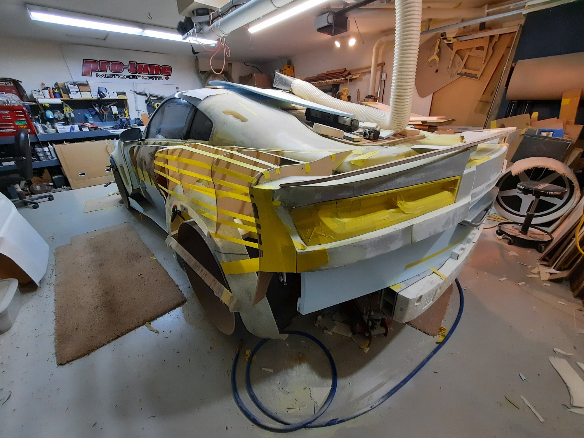

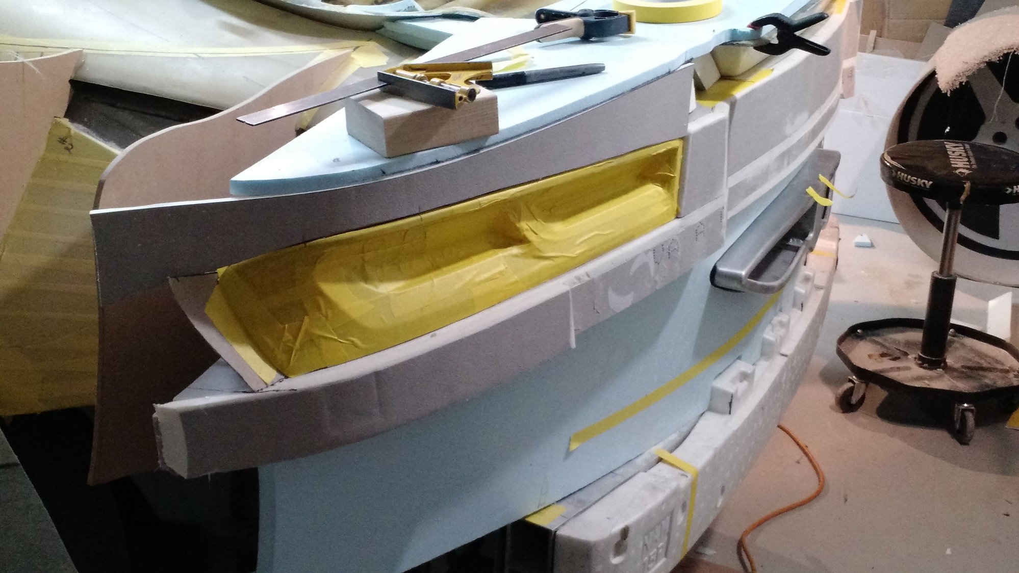

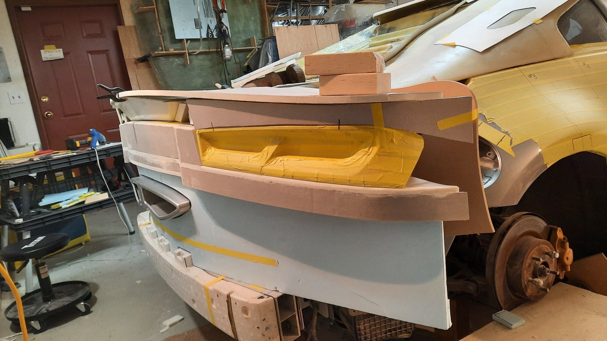

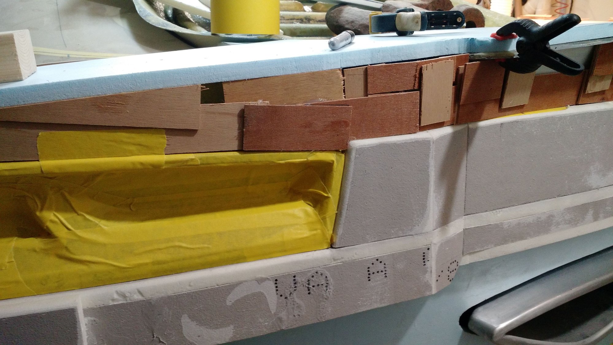

Some more on the tail light tray .
Making the pieces that go over the top of the lights .
I used my method of making the pattern with strips of thin wood and a glue gun ,
Have to make a pattern for above the light
this is gluing the sticks together
once your done you trace it out on some thin cardboard
cut that out and trace it onto your material
I am so looking forward to filling in the quarter panels !!

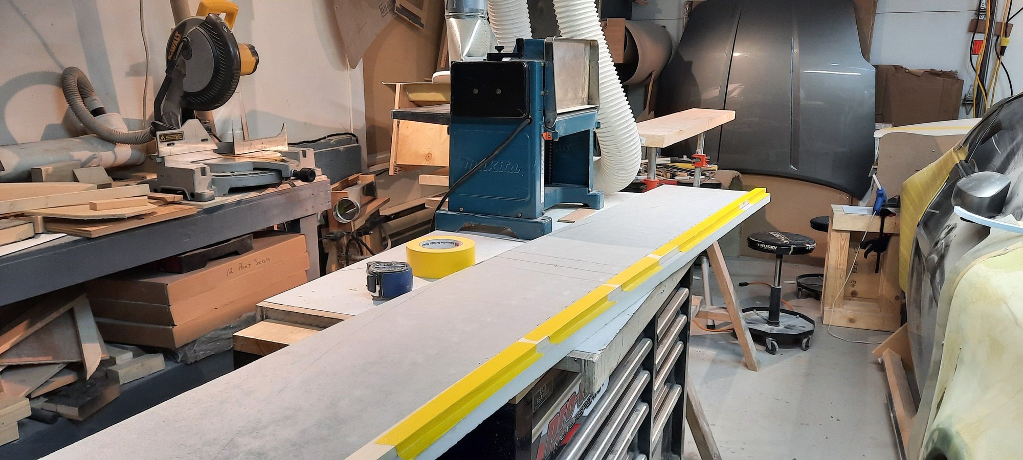

So I have been busy remaking all the pieces I had made in the blue foam with a few changes along the way .
Here I taped a couple of strips of wood on the foam and ran it in the planer to make a taper , seemed to work out , these pieces are to make the big piece that goes across the back thicker and have a taper

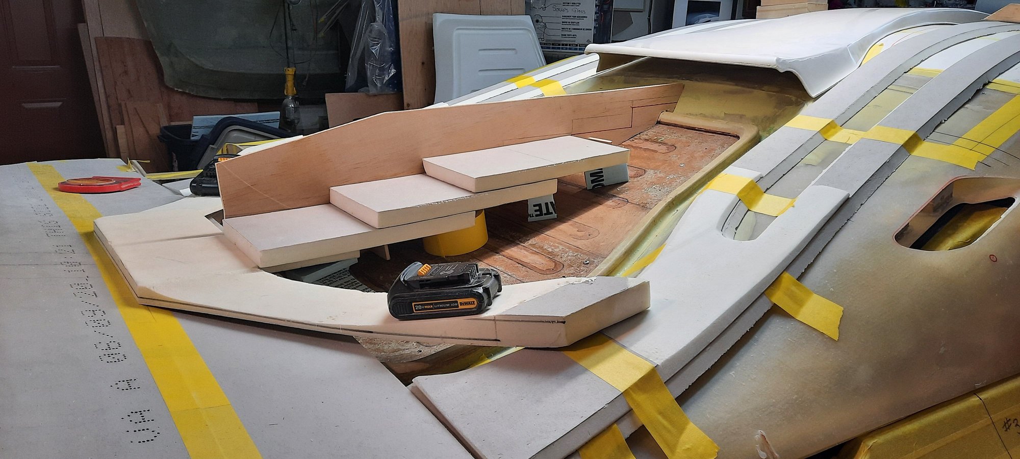

Default Falcata
More .....
So I remade the pieces for the batman humps that go on the roof in the new foam , the new foam is going well at the moment , its a little fragile as in density , so machining it takes extra care , but it can be filled or patched , so it should be good .
