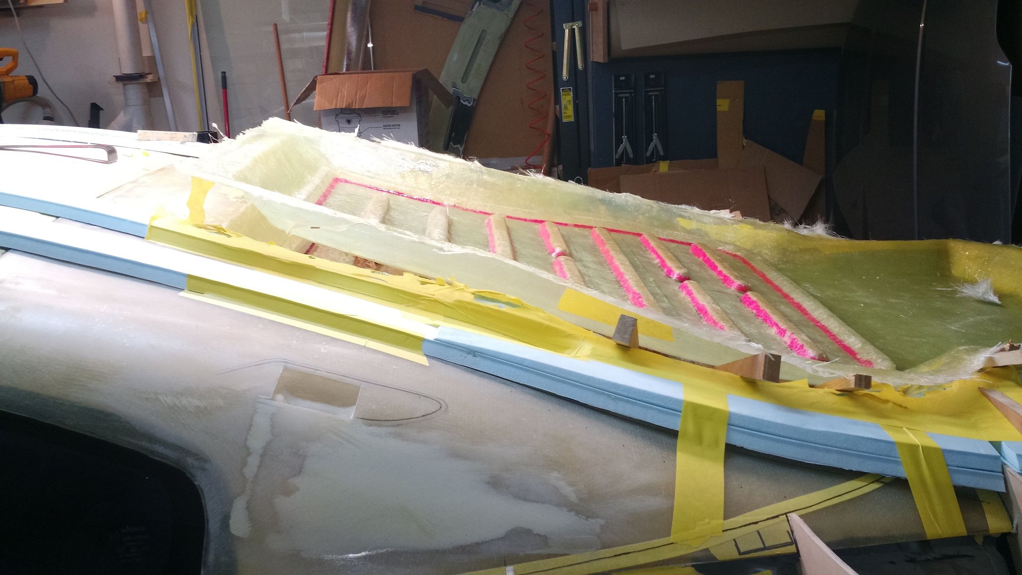

Had a big problem with the trunk , I had it all prepped to make a copy of the trunk bottom and the surrounding area so I could build it off the car .
The car is so wide it's back breaking to work hanging over the side .
Waxed and prepping for the mold release PVA
Spraying the pva
I was on my third layer of fiberglass and for some unknown reason the top layer started kicking off before the bottom and I had no time to steel roll the air out and had to tear it all off and toss it out ................not happy So this is what I had to deal with little glass hairs left on the surface.
So I cleaned up the mess and re-fiber glassed it . This is getting it off the car .

More on the trunk lid
As you can see here it tore off all the slats
Melted the foam
broke the back part where the trunk ends
it was a big mess , the slats were embedded in the part by resin getting underneath them
Man the part was pretty rough , very disappointing , nothing a weeks worth of body working won't Fix
