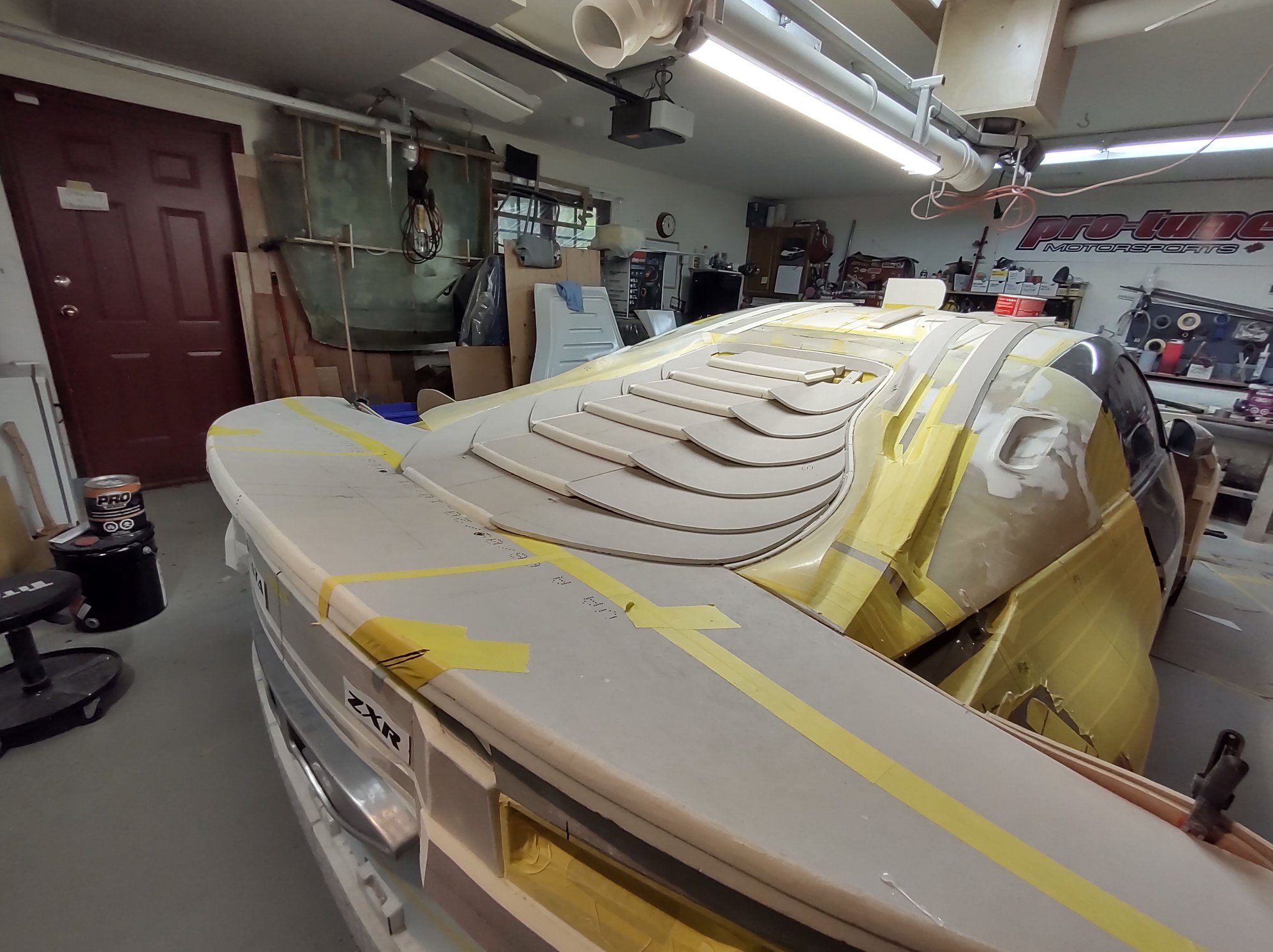

Hi EveryoneBeen busy it seems to me , I know I built a mock up trunk to build the trunk and make it function off the car but it's hard to know if it looks right off the car , so I have been doing some mock up stuff .
My original plan was to make each louver in one piece , it is too difficult , so this is what I am thinking .
This was the original idea
built some stringers to hold the louvers
They needed two sets , the outer are a different size because the outer ones are thinner so they can have some contour
you have to use a bit of imagination here and picture it all body worked

Well I didn't like the bars going down the middle , and it would be a nightmare to sand .
So I came up with an idea to make my original idea work , of course I had to make all new pieces ....
It's getting there , the plan is to lay up a few thin layers of fiberglass mat and then cut the part where the trunk lid opens . then I can finish the trunk lid off the car with the mock up
rear body part I made for that purpose , I know it's all a bit confusing .
So hang in there !!!
This is how many times I tried different ratios of height and length to get what I thought was right , just like CAD ( computer assisted drawing ) only WAD wood assisted drawing
LOL LOL
Just the top to sort out and then filler and fiberglass

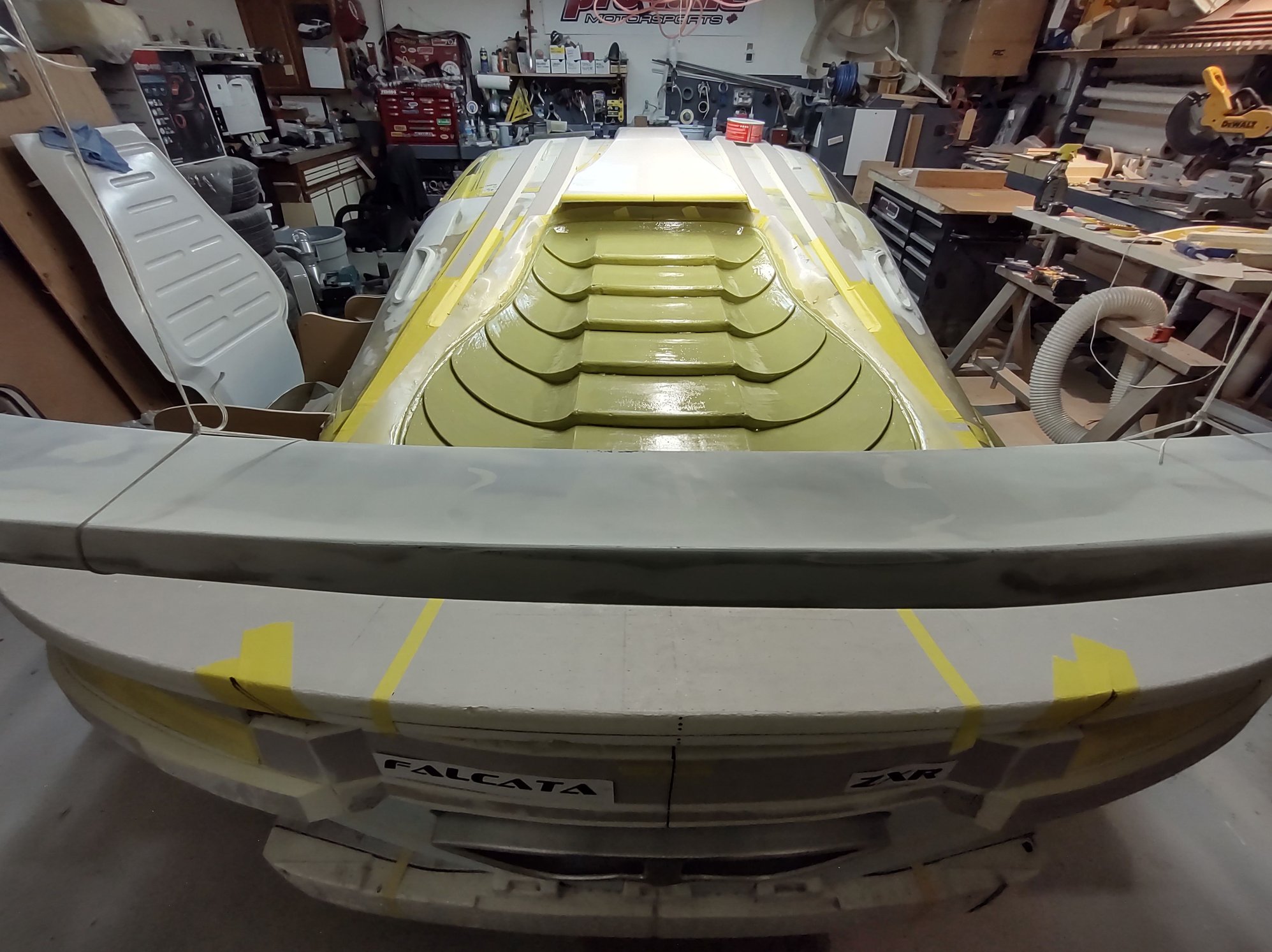

From: Victoria B.C.
So Porsche had the Whale tail , the Falcata has the Lobster tail lol
Everyone seems to really like it .
First couple of pics finishing the foam at the top and filling in the gaps .
I tried this for the first time yesterday , it's known as Rondo a mixture of Fiberglass Resin and body filler Bondo , blend and you get Rondo .
It helps to seal the foam for easier fairing ,sanding , filling and fiber glassing .
Seemed to go well , will know later today .
I set the roof scoop on and hung the wing up to see how it was coming together
Oh boy can't wait to see this all finished !!!

A couple more pics of the rear deck .
Rondo to seal the foam
Products I use
Rondo kicking off
I was having a hard time getting the foam to sit down where I needed so I made up a jig with a weight to hold it and fiber glassed it to hold it in place
checked the deck for level with the laser
second layer of glass
Rondo over the glass
these 2 pieces of foam are to fill where the rear fenders start to rise .
checking the fender rises with the laser before adding the foam
glassing over all of it
it's coming along !!!! Hang in there
