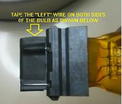

AFAIK this is as simple as swapping the housings and plugging in the connectors. Except for one thing: The turn signal will stay on all the time when the running lights are on.
The issue is that your 06 turn signal bulb which now has two filaments has three wires going to it and is plugging into a harness on the 03-05 vehicle side that has only 2 contacts spanning the same space..
Originally Posted by amr_electron
It happens when you upgrade the 03-05 HID headlights to 06-08 ones, Since the turn signal bulb has two filaments.
And the fix for this is described here:
Originally Posted by daniel123588

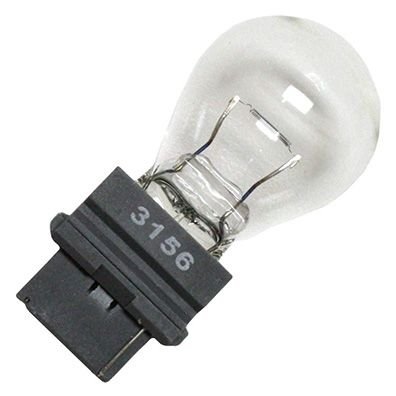

What you can do more a more nice set up is to use 3156 bulbs which only have one filament which will turn on only when you signal, this makes it more attractive at night instead of seeing that ugly amber with your parking lights.
I'm not seeing that anyone tried this and confirmed. I do see a lot of people taping or cutting the left side pin on a 3157 which would come with the OEM housing. Just want to make double sure that using a 3156 instead would work so as to avoid any issue with the install since I won't be the one working on it.
3156
3157

In theory, that should work. 3156 and 3157 have the same base. As you mentioned, 3157 are dual function. As long as the two contacts from the harness line up with the two wire contacts on the 3156 bulb, it will illuminate.
