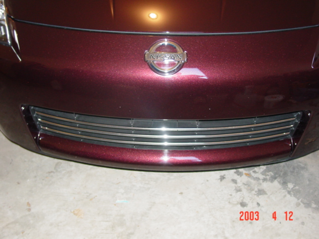

Default Chrome strips.........
They work good - be sure to coat the cut edges with clearcoat to keep moisture from getting inside between the chrome and the clear outside sheathing.............
That looks awsome. I am going to do this mod in the summer

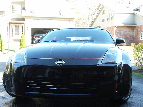

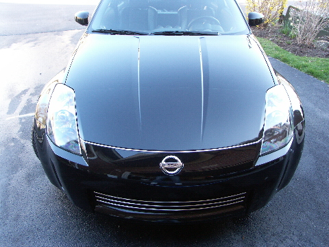

Here is my homemade grill
Old Apr 3, 2004 | 02:52 PM
350Chas's Avatar
350Chas
Posts: 39
From: Chicago
Another view

350chas , how did u make that?
Old Apr 4, 2004 | 12:02 PM
350Chas's Avatar
350Chas
Posts: 39
From: Chicago
Its door edge molding from pep boys.
It was like $10 for a strip that was like 20 feet.
it was more than enough to do the grill and the strip filling in the space between the bumper and the hood.
Not sure that i like it there but for now it stays.
It's in-expensive so i can take it off and put it back on as i feel the need.
Its installed by cutting the plastic strip to size, peeling off the adhesive backing and putting it on.

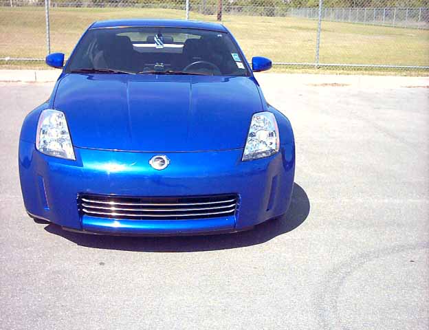

I did the same...
Attached Thumbnails Installing Grille with door edge guards?-z-grill-copy.jpg

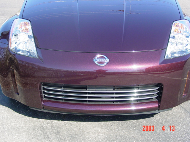

Attached Thumbnails Installing Grille with door edge guards?-front-grill.jpg

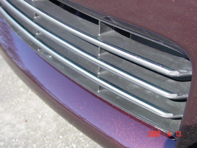

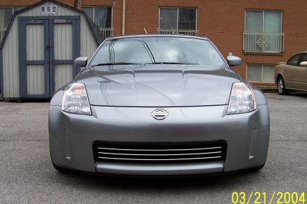

Almost a year on mine too and no cracking fading or loosening. I got the $10 strip at AutoZone. Peeled off the backing and measured to fit before I cut them. I beveled the ends to fit the contour of the edges of the stock black grill.
Attached Thumbnails Installing Grille with door edge guards?-front-grill-mod-3-.jpg

From: Zainoland
Attached Thumbnails Installing Grille with door edge guards?-grill-mod-3.jpg
