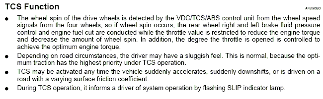

Old Dec 9, 2004 | 08:12 PM
ether's Avatar
ether
Posts: 694
Originally posted by gq_626
The VDC doesnt cut fuel....it closes the throttle plate.
So no chance of fuel starvation.
from the service manual it appears to say it does cut fuel but also as you stated the TP..
the manual decribes the TCS and then in the VDC section mentions that in addition to the TCS, VDC does x,y,z
