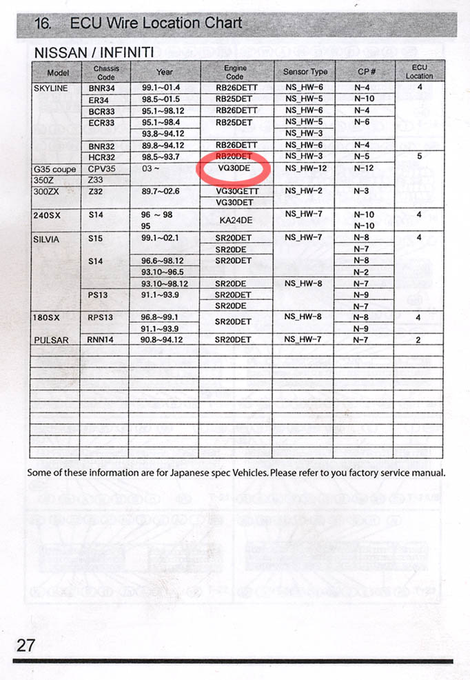

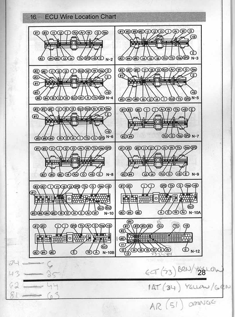

here's a scan of the main page in the manual he was using
I circled in red at least 1 mistake
If the manual IS wrong, then I guess I can't do anything except bit*h that greddy sucks

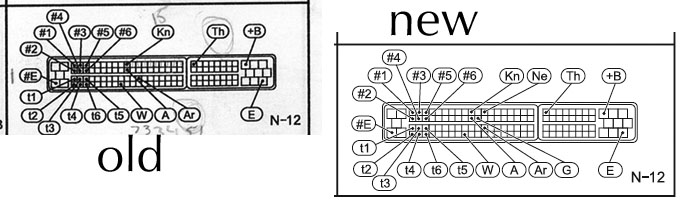

ok
so I went to greddy's site and their PDF manual is different. I included the PDF manual on the CD i brought them. But I didn't tell them to ditch the printed manual.
So maybe this is MY mistake because stupid me assumed the printed manual that comes with this POS might actually be correct...
first 2 pics are from my printed manual
3rd pic is a comparison from my manual vs the newest pdf

page 7 of the ultimate installation manual has all of the pins labeled...on all 3 connectors!!!
the only wires they had to locate on the harness is the 6 injector wires, 6 ignition wires, and a few other powers and grounds..this info is EASILY accessable to most anyone, especially a shop!!!, you shouldn't have paid a dime...ask for a refund...

The page from the instructions you posted is not the one people should be looking at, and I havent checked it for accuracy. If they used that, then its possible that the wiring diagram was incorrect.
The best way to wire this up, is to you use the wiring diagrams in the first few pages of the manual, the describes the pin locations and their purpose. You mate that with the part 3 of the Greddy TT instruction manual, which shows the factory pin locations.
Or, you goto this thread, and I list all the pin locations for everyone to use. Your eManage is not defective...I can almost guarantee that. The red/green flasher means that your wiring is not correct, or the firware is corrupted. Based on the skills demonstrated by this shop, either of these are a possibility.
