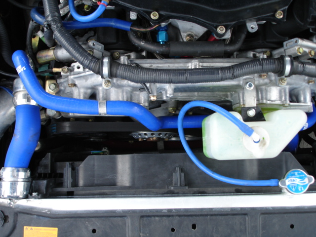

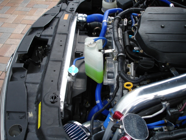

This is my post. The PE radiator is awesome. For 350z guys it is a direct fit without modification. I only needed bracket fabricated, but no shaving. By the time you pay for the labor of shaving down the fans and shroud, or buying new fans you could have bought the PE. I got my from Sharif at www.forgedinternals.com.
Attached Thumbnails any issues with vortech and koyo radiator?-radiator-002.jpg   any issues with vortech and koyo radiator?-radiator-003.jpg
