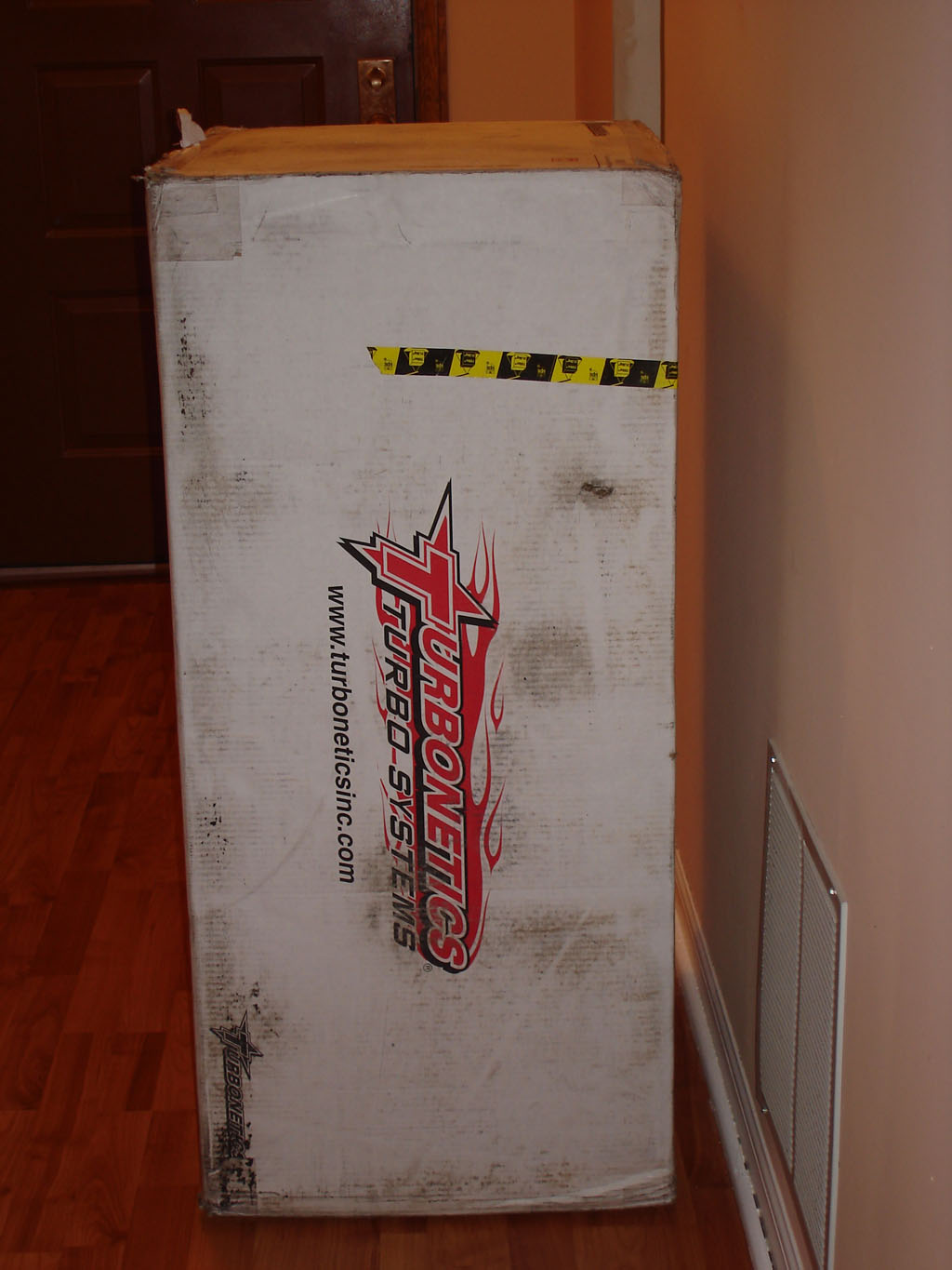

Nice dyno. I can't wait to get mine installed now. I just got it today!!
