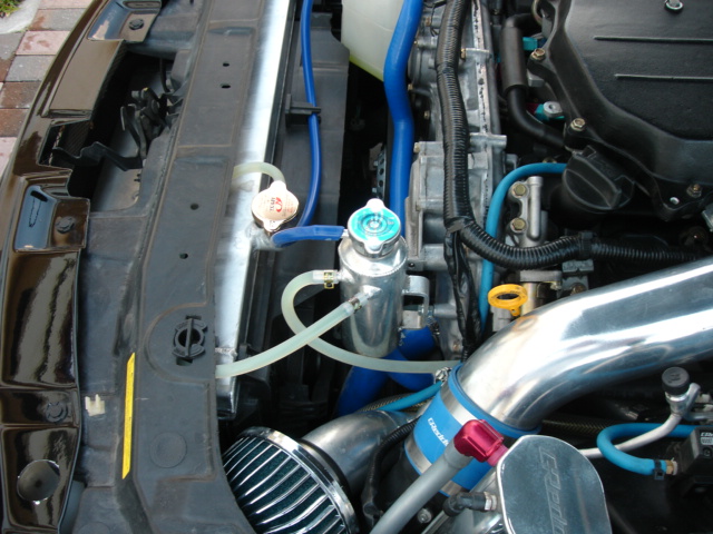

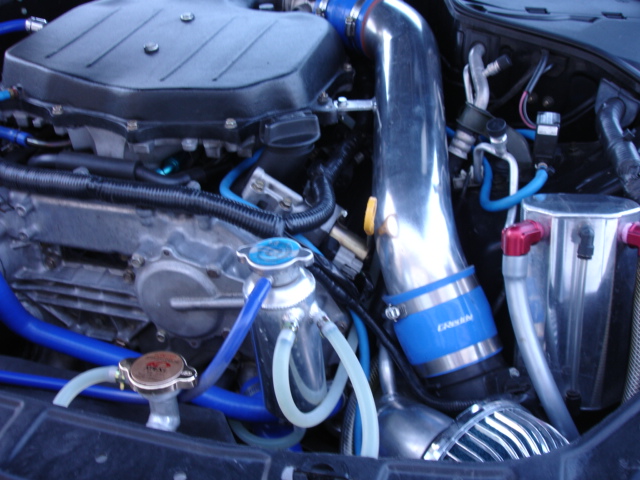

Originally Posted by theking
Radiator and a breather tank is about the only thing I can think of.
Can you explain more about this breather tank and do you have any pictures of one? Where would someone buy such a thing? Thanks in advance.
Old Mar 16, 2006 | 03:43 PM
Gman2004's Avatar
Gman2004
Posts: 4,328
From: Miami, FL
It gets rid of any air bubbles that might be in your cooling system. I have the Greddy breather tank. You can get it anywhere.
Try www.forgedinternal.com.
Attached Thumbnails Important question to all tuners and people with lots of knowledge-breather-tank-001.jpg   Important question to all tuners and people with lots of knowledge-breather-tank-003.jpg

Figured I would also tell you where these lines are running. Top line runs to overflow bottle, top line on the side runs to where the overflow bottle would hook up on the stock radiator, other side port goes to the drivers side solid coolant line(unhook the line that runs to the throttle body from there as it's going to be bypassed), bottom line(yes there is a line at the bottom of the breather tank) goes to the passenger side hard coolant pipe(disconnect the line that goes to the throttle body from this side). Now your system is constantly purging the air bubbles from the rear cylinders and heater core! This in a nutshell is SGP's magic cooling mods(along with some mod to the thermostat but I don't care because I'm in Florida and I don't need a thermostat). Hope I helped.
