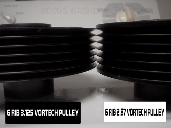

https://my350z.com/forum/attachment....7&d=1091409709
Here is the reason it didnt work . I recall Vortech saying they let one go out that got mixed up with the ones for our car . Must have happened again , because they are plenty out there that do fit

So I give him the 3.12 I had with me and said, your missing whats going on here...your pulley that you designed tore up the jackshaft that you designed because you have different style pulleys. I showed him the thickness of the 3.12 compared to the 2.87. So he takes the pulley and shows his manager, and says, well I still need the entire bracket, because we dont know if you or your mechinc is going to do the work. I basically wasnt going to leave there with that response, so I continued to argue...
