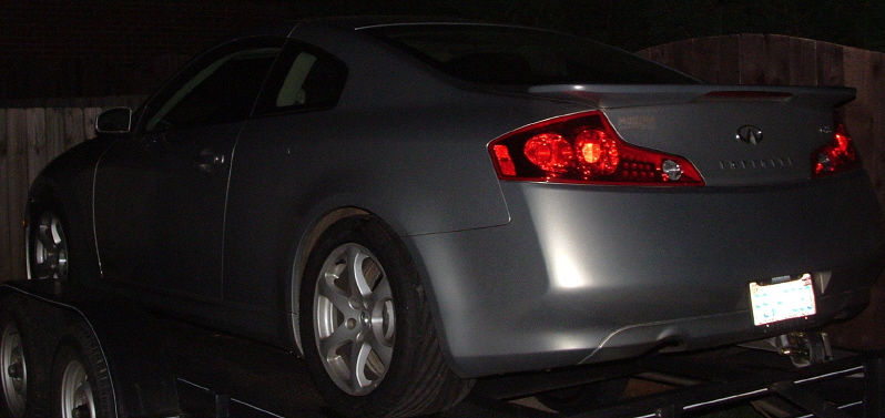

the mechanical work is now finished!!!
I just trailered my car back to my house & snapped a couple of pics.
Next week I bring it down to CPracing in charlotte for the tune.
The engine sounds great, idles a little rough due to the 550 injectors, but I just disconnected a vacuum line & the idle is perfect. I'll probably do the small hole on the throttle plate mod before I bring it down to Charlotte.
I'm also going to re-route the air filters to right behind the bumper cover & out of the engine bay, like others on the board have talked about.
I'll take some daylight pics of all the extra goodies I installed over the next week or 2.

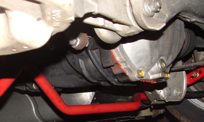

pics of my Hotchkis sway bar. (set at med/med)
new quaife diff. can't see ot but its in there

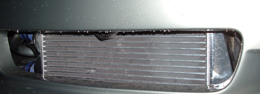

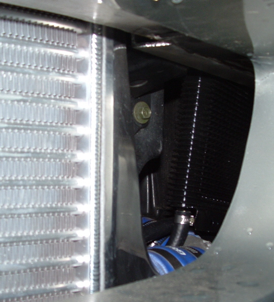

intercooler, notice my bumper brace is in there!!

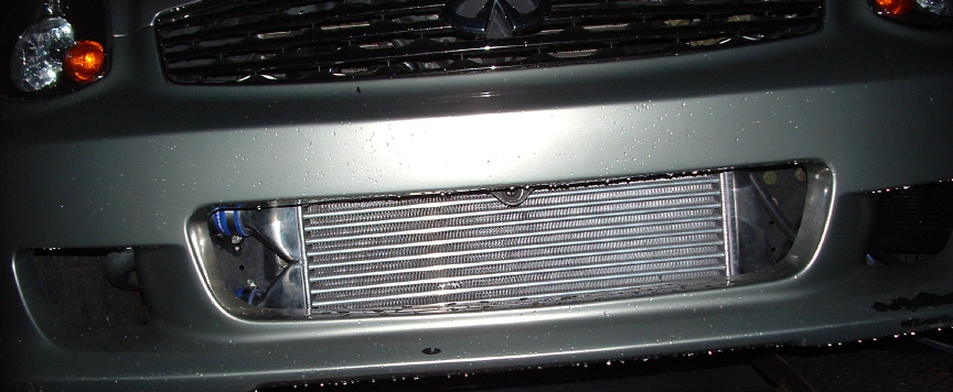

new kurumaZ bumper
more pics to follow next week
Attached Thumbnails g35 greddytt/built engine: chapter 2&1/2-g35tt-001.jpg   g35 greddytt/built engine: chapter 2&1/2-g35tt-002g35.jpg   g35 greddytt/built engine: chapter 2&1/2-g35tt-003g35.jpg   g35 greddytt/built engine: chapter 2&1/2-g35tt-004g35.jpg

How did you fit your brace on there with the intercooler?

we cut out the back 1/3 of the brace.
Its pretty lightweight aluminium, just used a reciprocating saw with a fine metal blade. I'll take some close up pics next week when I take the bumper cover back off.

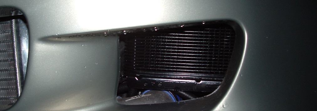

aux. tranny cooler

how much and where did you get your tranny cooler? nice ride btw.

Looks good . I just knotched the bumper brace on both sides . Tranny cooler on the passenger side and the oil cooler is going to be on the drivers side .
thanks,
I bought it on eBay, from a guy I bought stuff from before.
Good quality. I bought an remote dual oil filter/ dual bypass set from him also with a large cooler. So large it doesn't fit in there, so I'm going to buy a slightly smaller one from him this week. It's going on the passanger side vent opening. The tranny cooler was like $45 shipped, including hoses & fittings.

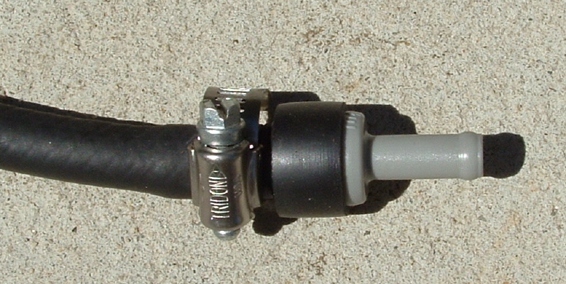

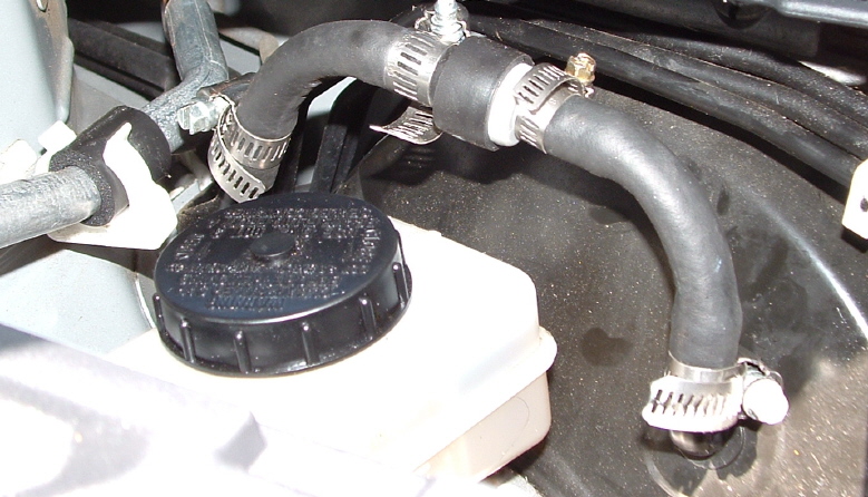

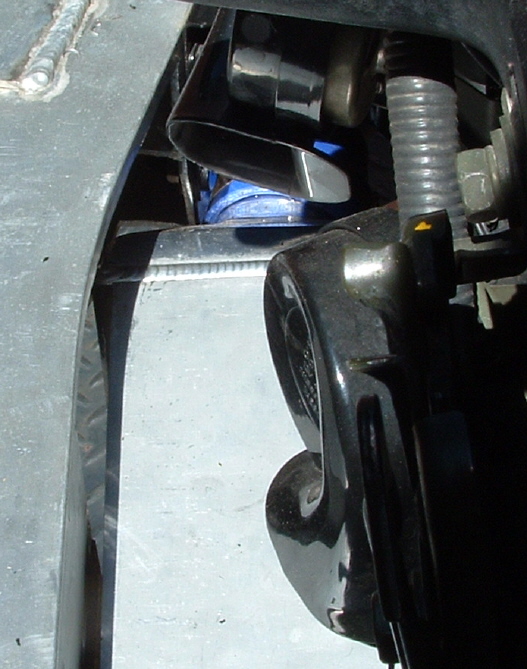

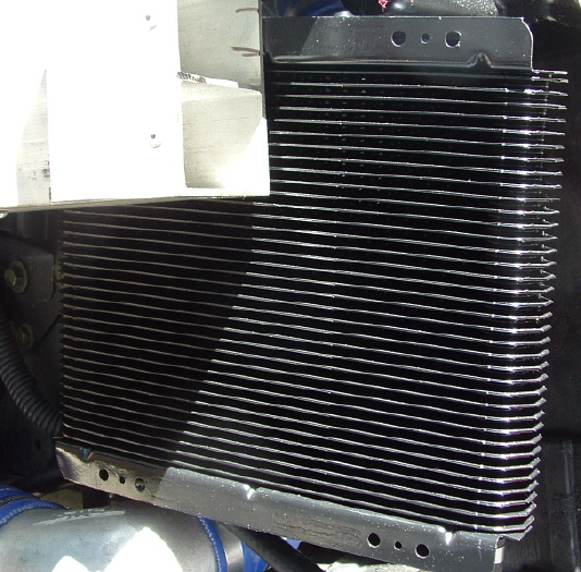

installed brake check valve
also included is a pic of the aux. tranny cooler
better? pic of bumper cutout for intercooler

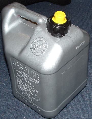

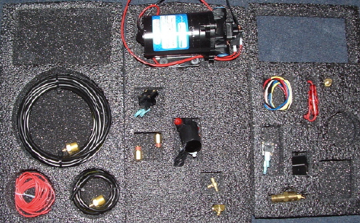

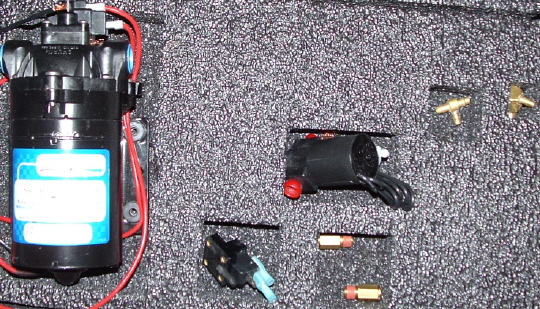

also purchased a cooling mist setup (water/methanol)
used a 2.5 gallon plastic gas can, painted hammmered aluminium.
I'll be installing it & the pump in the trunk, off to the left.
I bought this after reading/researching another thread, here.
