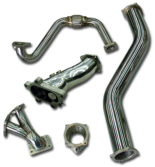

Actually i ment the inside. When looking at the exhaust turbine side, u can see the "exhaust turbine wheel" and the "wastegate flap". Around that is the flange to where the dowpipe bolts on to. I was wondering if a simple divider between the "exhaust turbine wheel" and the "wastegate flap" would help the wastegate close and hold boost like we want it to.
Didnt someone run an APS ST w/o an exhaust and still had trouble holding boost? If so then i cant believe back pressure is the culprit. Im beginning to think its the local high pressure comming out of the exhaust turbine and its relatively short distance to the wastegate flap that is inhibiting the actuator to have complete control over the wastegate. Otherwise, id have to say that internal wastegates are just plain no good for high boost. WRXs and STis have had this problem forever. The high HP scoobs all go with external wastegates. The shop that worked on my car mentioned of welding the stock APS internal wastegates shut and doing an external wastegate within 3 minutes of opening the APS boxes and looking at the turbos, this was about 2 years ago. They where also the ones that mentioned "they should have had divorced wastegates," as well.
whats funny is that on the APS website, if you look at the pic of the downpipe, its divorced, there is a piece of metal seperating the flapper section and exhaust outlet section. but in the kits shipped out there is no divorced section, its all open. dont know why they changed it.
i did run my car with no exhaust, the boost did hold better, and response was better but it was loud as hell. plus my datalogger wasnt working, but i do feel exhaust backpressure has a tiny part in the issue.
what i think is the biggest problem is the turbine housing in general, i believe its too small. the exhaust outlet is only 2.5 inches and youve got 3.5L flowing into it. i think there is too much exhaust gas flowing into it, causing the pressure to build up inside the housing, once the flapper opens, it has a hard time closing due to the pressure inside the housing. my fabricator is working on an external wastegate setup right now.
you can see it in the following pictures, the smaller picture one has a totally seperate smaller pipe welded in and entering the downpipe downstream, the other pic shows the divorced section. in these pics, its the pipe in the center of the pic.
I see what you mean tig.
I was looking at the TT kit and they didnt show a divorced wastegate. In their explanation of exhaust back pressure they did use another turbo with divorced wastegates though.

Actually to do a proper divorced wastegate it really should be done like this:
Old Sep 21, 2006 | 03:16 PM
  #198
tig488's Avatar
tig488
Posts: 4,660
From: bama
i agree mia, if you look at that second pic i posted, it shows a setup exactly like you posted, 2 seperate pipes coming from the housing, totally seperate chambers.
