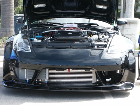

Function > Form
Here is my custom kit I did. Wanted it to get the most air possible, so where better to mount it. Some might say its ugly, but it definitely stays cool.

Have you had any issues with the oil cooler blocking air to intercooler and making intake temps. rise ? I like the idea of complete function.
I am not 100% cause I have no way to measure that. I would think that if it does raise them it will not have much effect on power. Pretty soon I am going to be tuned for 15psi+, so I am not real worried about it. I would reather have cooler oil then a bit lower intake temps.
