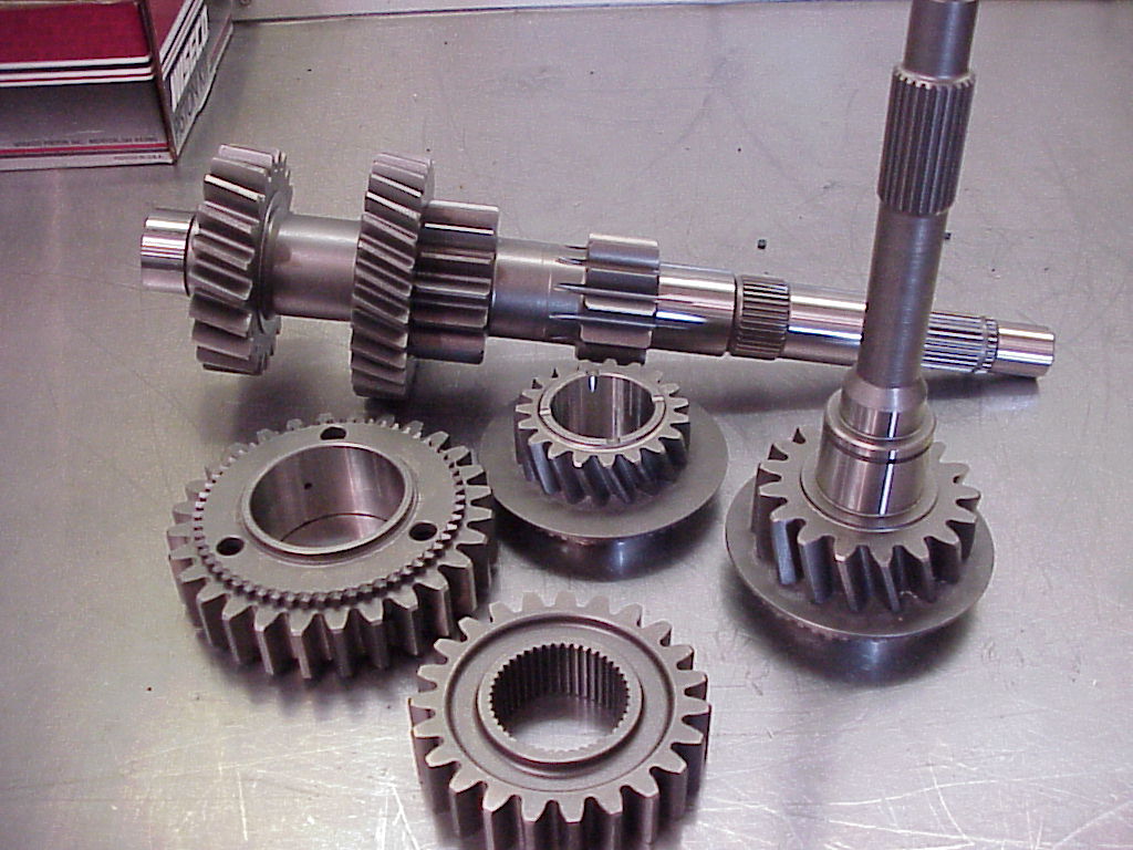

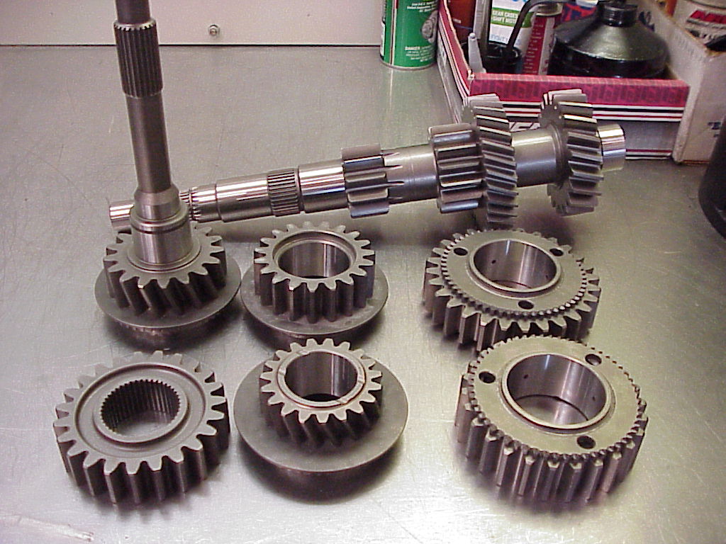

We have made them already ,we are in the testing phase right now .
sam
GT MOTORSPORTS
Attached Thumbnails 6mt 3rd gear not worky- here's why!-mvc-674x.jpg   6mt 3rd gear not worky- here's why!-mvc-675x.jpg

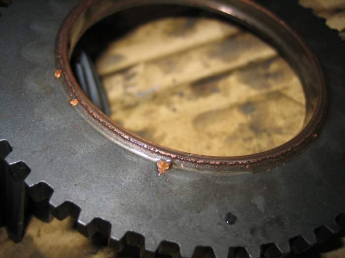

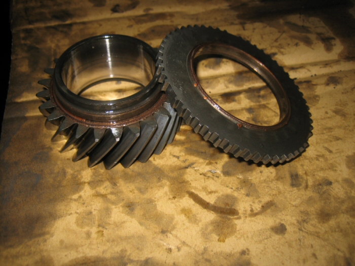

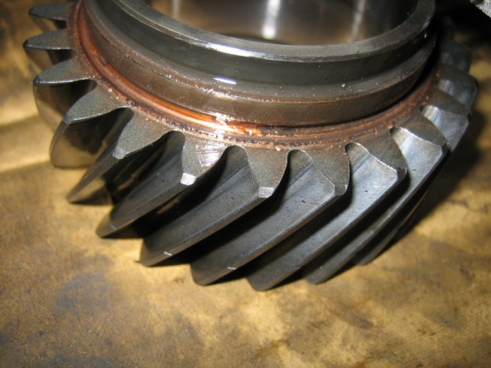

Same s_hit with the 3rd gear here in germany.
Attached Thumbnails 6mt 3rd gear not worky- here's why!-img_0565_klein.jpg   6mt 3rd gear not worky- here's why!-img_0566_klein.jpg   6mt 3rd gear not worky- here's why!-img_0567_klein.jpg
