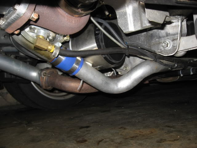

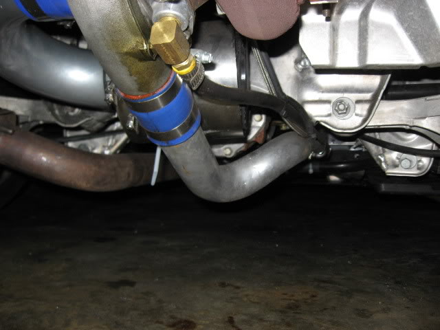

I'm just using one port but I thought you only use both when you are using close loop? My lines are also routed different, there are a few bend on the lines and I also have some minor Oil leaking on my Turbo. STS said it is because of the way the oil return line was routed and I think Goosegoose had the same problem and re-routing it fixed the problem. I'll do them this weekend and if that doesn't fix it then I'll try re-locating the BCS or just get an EBC...
The spike is around 1 psi and only around 5000rpm-5300rpm and usually on hard shifting to 4th and 5th gear but it goes back to 8 psi past that. The spike happen only in a very small part of the RPM range so I'm not worried.
From what I understood, in open or closed, boost is much more stable when using both ports.
Where are you leaking oil?

The thing is I never had this oil leak problem before, I know Goosegoose had them when parked on an incline and re-routing the line fixed it.
Here are some pix.

I had a small oil leak initially when first started everything up because(I think) the turbine housing bolts were not tight enough. I tightened them up a tiny bit and the leak went away. Also, both my supply and return lines are routed up high. I dunno if they both are supposed to be or what because the instructions are such that I couldn't tell what they were talking about.

Yes, the lines should be route up high to act as a barrier when the car is off. I'll be re-routing the lines this weekend and see if that fix it.

STS instructs the oil return line to be routed above the rear differential to act as a plumber's trap, so that oil will not backflow from the engine to the turbo if the car remains parked on an incline, with nose pointed upwards.
