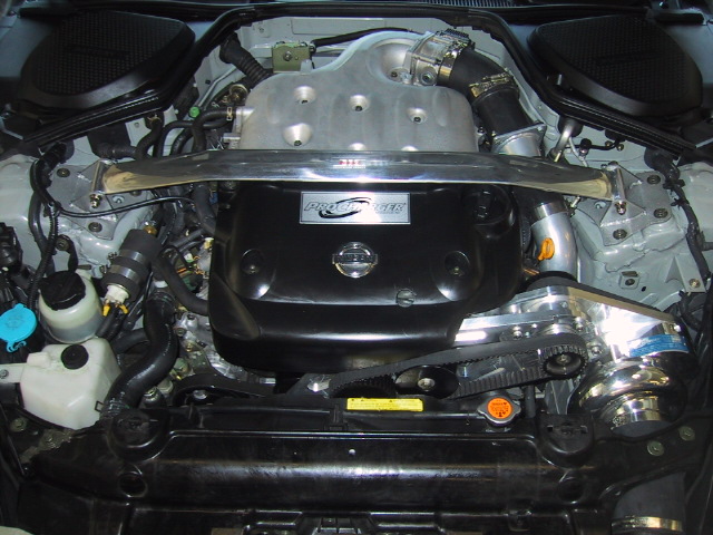

If this is a repost, shoot me... but i think its new.

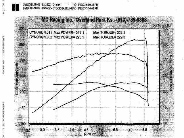

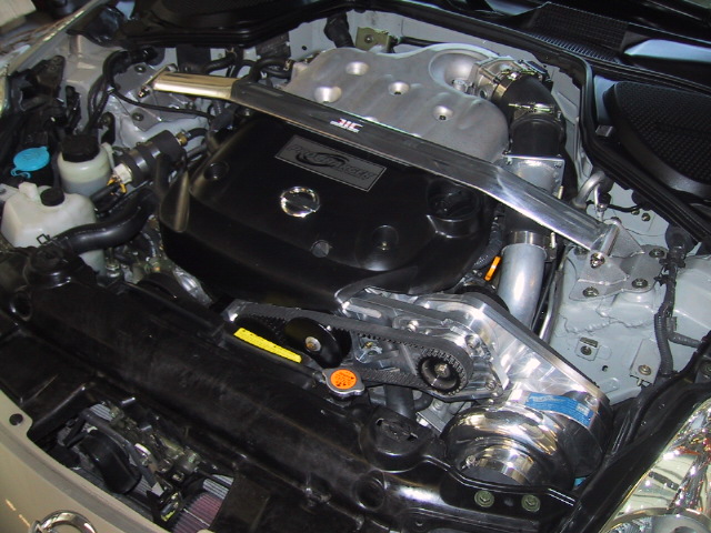

Default Courtesy of Avalon Racing

is it just me or does this setup not require that aweful hood?? thanks for the post

Damn thats almost 450hp at the engine (17%) loss.

Very nice dyno numbers...
Pretty nice packaging, but....
Where's the air filter?
I looks like it would be sticking out in front of the car?
-D'oh!
-D'oh!
If you look in the first pic, you can see the red of the K&N Cone style filter where the hood latch is.
I want to see a diagram (or pics would be better) on how the intercooler routes. One thing that is scaring me away from a twin turbo kit, is how much duct work is there going to be? The longer the tubes, the longer it takes to pressurize it all. From looking at those two pics, the procharger looks to have a pretty short run. I guess only time will tell. For now, i need the Borla dual exhaust as much as i need air.

I have some questions, though. How much boost is this system running to get the 369HP??? And is it just me, or does it seem to have alot less power down low than the stock engine. I thought a supercharger was known for instant power and such, but from the graph, it seems the low end power dropped drastically. Am I seeing this wrong (no expert on dyno graphs)??? The area under the curve might actually be less, course I could be far off base here. Is that a new and different strut bar on top of the engine??? Cause it definitely ain't stock, is it something that will be needed for the procharger to fit the Z???
Only positive displacement SC's build instantaneous boost. This is a centrifugal type, which builds boost like a turbo (exponentially).

The dyno looks real linear. Have they tried fitting an intercooler yet?

We start to ship in a few weeks. There is a $500.00 promotion right now through us. All orders prior to us leaving for the first Pro Inmport event will also get free shipping.
The kit comes with 100% of everything you need. We have sold a bunch already and installing two of them in a few weeks. The dyno numbers were done at 7 pounds of boost. The boost is controllable as well.
Get this now as the supply will be limited. You DO NOT need a hood as everything fits under the stock hood. The kit comes with it's own filter set up.
350Z Super Charger by Pro Charger
350Z Supercharger kit.
370 HP at the wheels
Bolt on
Features full fuel management, front mount intercooler, cold air intake, special oil reservoir for the blower, all hardware etc.
Yes you are looking at it wrong, I thought the same thing at first. The two lines at the bottom are the stock HP and TQ. The two higher lines are the S/C HP and TQ. So from top to bottom it's S/C HP, S/C TQ then stock HP and lowest is stock TQ. This is from 5250rpm and up of course.
There is over a extra 100ftlb of TQ at 3500 rpm. Talk about area under the curve. The stock clutch won't like taking that to long. Looks good so far can't wait to see it on a few real world cars.

And is anyone else worried about that much power coming from the engine without any internal modifications? 370rwhp is awsome, but I use my car daily, so I'd have to have whatever added be daily driver safe and reliable.
Plus, Greddy's TT is getting 334rwhp at 5.6psi, and this Procharger is getting 369 at 7psi. How does this procharger get a lot more power out at roughly 1.4psi more?
if i am not mistaken, 1 psi of boost equals about 20 hp. so if you look at it that way, the numbers look about right. although, there are parasitic losses which should lower the power on a s/c. along with d_nyholm and scorch, i would also like to know about the availibility for the G35. cant let the Z guys have all of the fun.......
