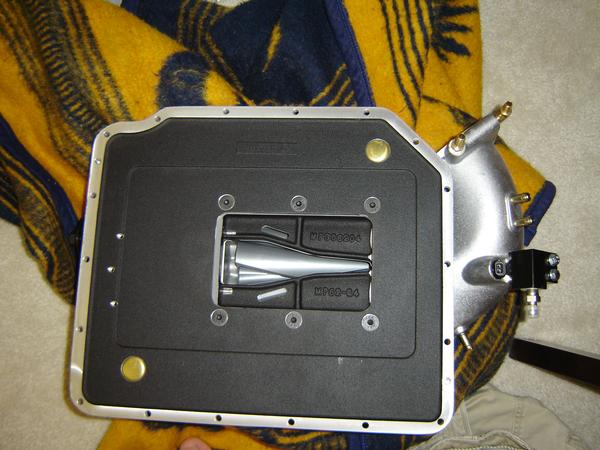

It has to do with the way a roots style blower makes the boost. I really don't completely understand it myself. But a turbo, and a centrifugal SC compress the air in the intake by spinning a fan style blade rediculously fast. In a roots style blower such as the Stillen set up. It has twisted screws with lobes that actually squeeze the air as it gets caught in between the lobes, and moves to one end of the screws. That's what makes the whine.
And from what i think i understand about the process. having little to no resistance on the engine side of the blower will allow the air past through the lobes too quickly not allowing it to compress and "burst" (for lack of better words) into the plenum.
I could be all F'd up. Someone correct me if i'm wrong. But i know it's something like this.
read this is may help explain.
http://auto.howstuffworks.com/supercharger2.htm
This pic is the underside of my Stillen blower. You can see two screws in there.
Attached Thumbnails No Roots Blowers :(-l_ae0f6c5a6bc06f3f4714bae00afac4e2.jpg
