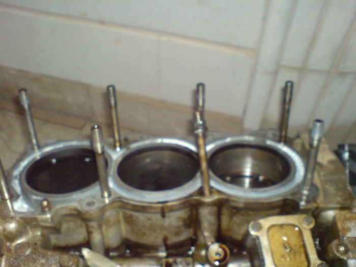

we had the same problem befor, the compression was going in to the water passeg and makeing the same problem. it was a broken headstud L19, and i have the pics. ill post them today.

When the head was removed, were the torque values checked?
I think this is the first L19 failure I have heard of. Kuwait gets hot for sure.

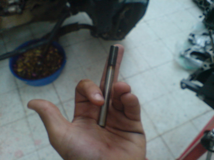

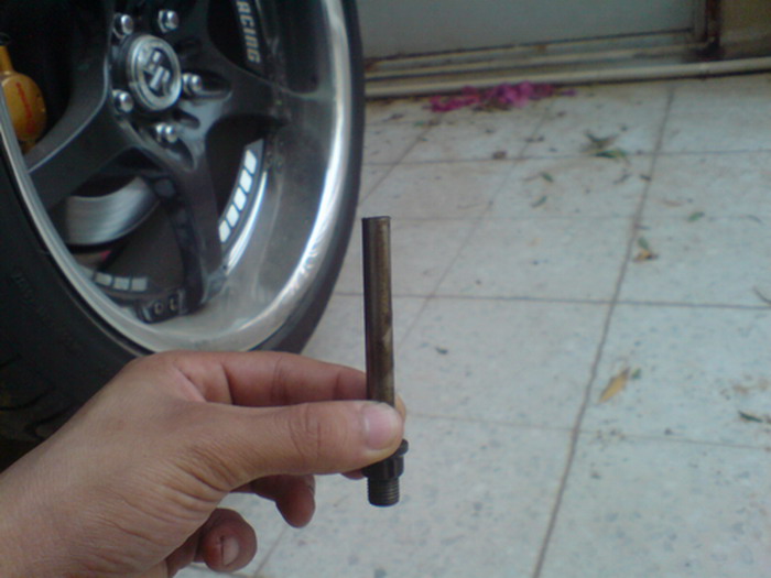

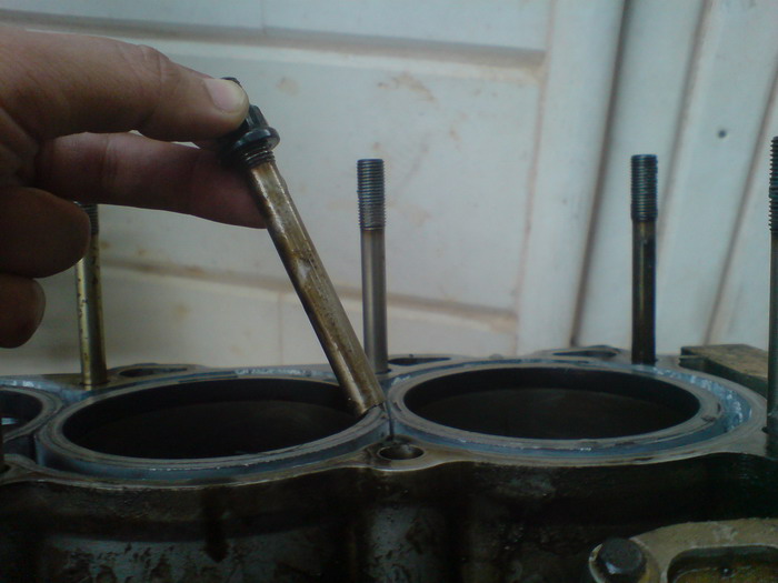

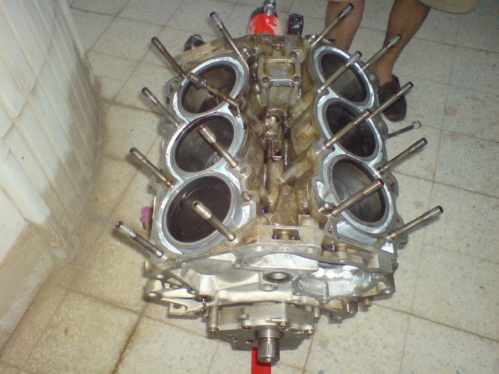

the First broken L19 Headstud in the world
Attached Thumbnails Got a problem!!!  My freshly built Z is overheating and spewing antifreeze-dsc00187.jpg   Got a problem!!!  My freshly built Z is overheating and spewing antifreeze-dsc00189.jpg   Got a problem!!!  My freshly built Z is overheating and spewing antifreeze-dsc00191.jpg   Got a problem!!!  My freshly built Z is overheating and spewing antifreeze-dsc00184-1-.jpg   Got a problem!!!  My freshly built Z is overheating and spewing antifreeze-dsc00188.jpg
yes we cheked. we torque them 88 befor, after opening the engine, it was 85.

lol, it was a horible experience l19. the car makes boost and runs like a normal for a moment then starts overheating. when we took the plenum off of the engine, there was a huge a mount of oil underneath. we couldn’t believe the cause was due to l19 failure. Anyway, it was broke due to air bubble and detonation. btw torque is 85.
